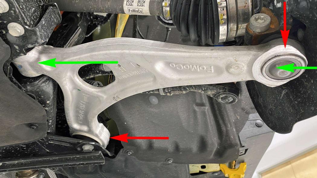

If you need to recover a vehicle(Maverick) from the front and it does not have a tow hook. You can use these round "Soft Shackle" around the frame, or the hole in the lower control arm (below the left side green arrow in the photo)

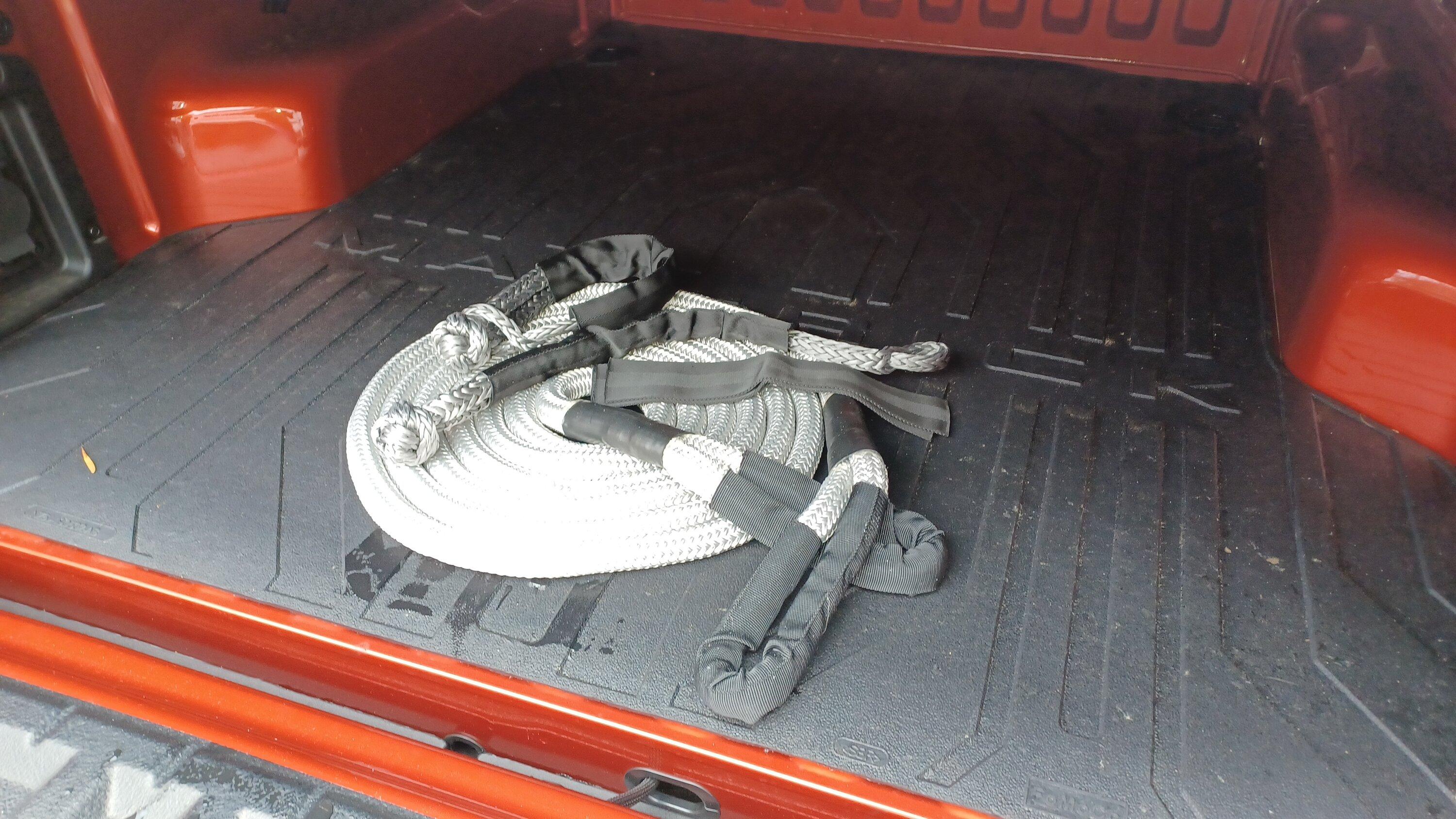

Link to soft shackle and recovery rope: (soft shackle is the smaller loop things)
looks good. I opted for a 7/8" rope but think I'd be better served with a 3/4"
If you don't want much stretch 1" is ok. 10' bridle not shown

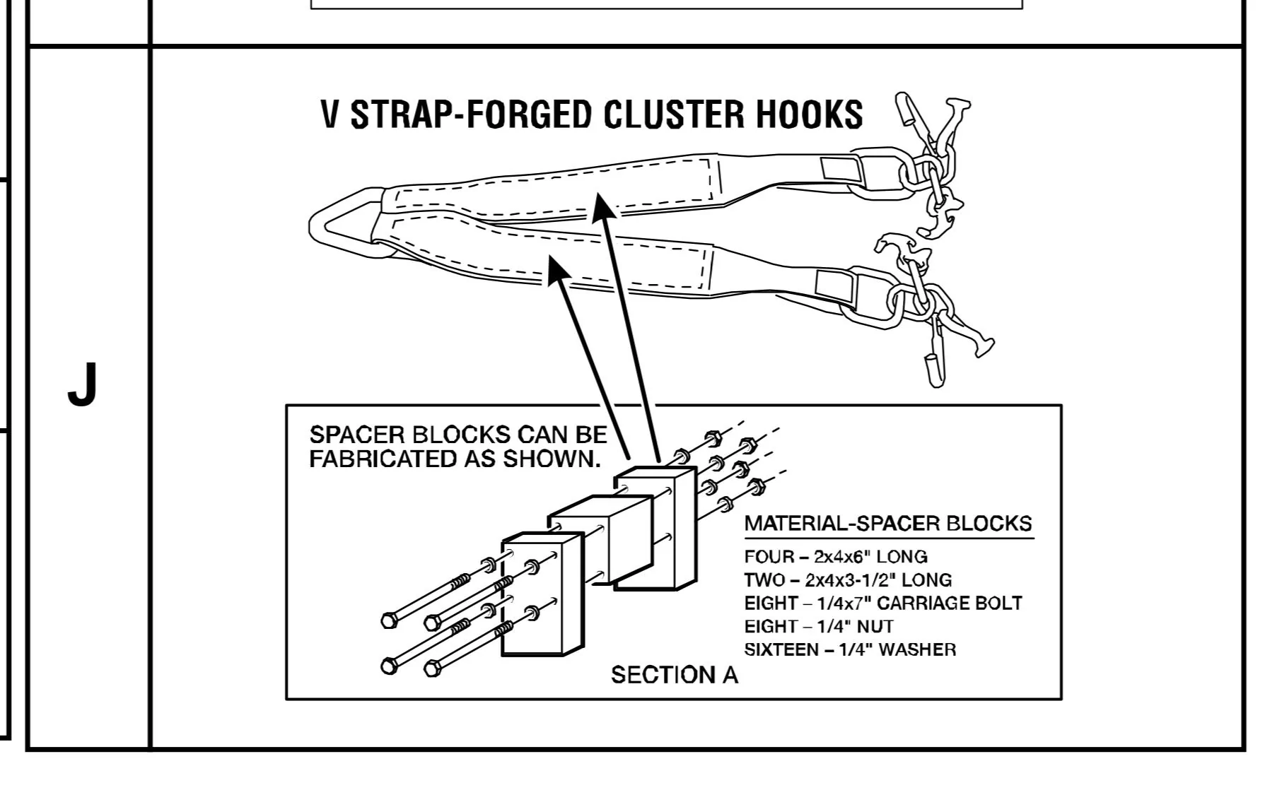

There is an older post that is closed, trying to revive the question. The pic below shows one of the 2 holes in the front (the old post had some discussion on their use but didn't answer the question). The Ford instructions tell you NOT to use chains, cables or straps "WITH METAL HOOK ENDS"!
Can anyone shed light on what is to be used, that is not metal, to tow a hybrid Maverick when stuck?
This below is the Ford Approved Method;
Ford Maverick Maverick Hybrid recovery points, what to do when stuck? IMG_9072
Post #54 shows that those metal hook things at the end do not fit the Maverick
Incorrect.
Different fixtures.
Take a closer look.
Ford Maverick Maverick Hybrid recovery points, what to do when stuck? IMG_9073
I only got the ones highlighted in yellow. Those do not fit. One of the other shapes will.
Pictured is a 3-way "universal" device.
