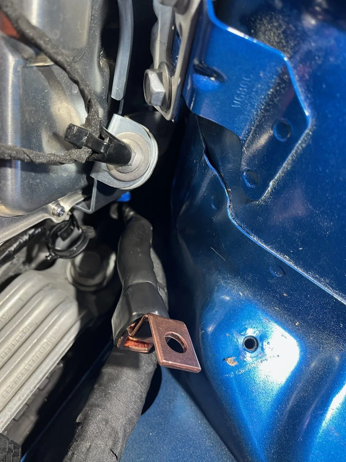

If your in the Atlanta, Georgia area, I have great news!
Here is the dealer that you want to go to:
https://www.howellford.com/
They fixed the faulty connector in approx. 3 to 4 hours while we waited. While other dealers made excuses, denied there was a harness problem, did not return phone calls, were generally rude and simply did not care, Billy Howell Ford was impressive and got the job done.
Their service department and service director are first class, 5 stars, all the way!
Please see the attached pic showing repair. Unfortunately, I have not had a chance to see exactly where this connection is in the engine compartment. I Will try and update later where the exact location is.
This fix makes the most sense since it has not been confirmed if harnesses are still being manufactured the same way with the same problem.
