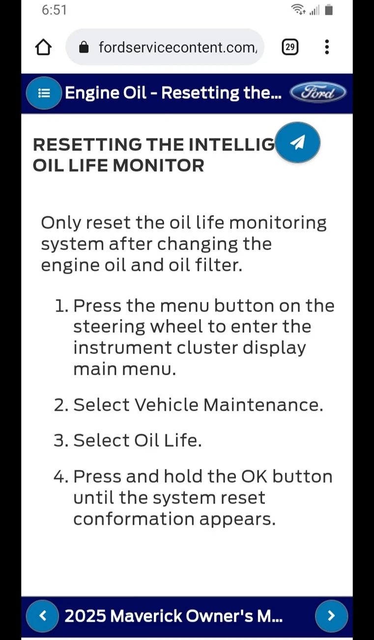

This is the only way you get it to quit nagging. Reset the oil reminder.
Instructions are here👇
Ford Maverick Maintenance Reminder Message for Oil Change 20260818_065138
Don't forget to get your oil changed. Then reset it again on the day the oil gets changed.
