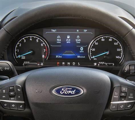

I don't seem to have an option for Vehicle Maintenance or Oil Life.
On the touchscreen, I go to Settings/Vehicle and the only option is Camera Settings.
From the steering wheel, the menu shows Digital Speedometer, EV Coach, Fuel Economy, and Calm Screen.
It's in the instrument cluster screen, accessed using the buttons on the steering wheel.

In the XL, it's in the screen that shows a picture of the truck. There, it's under Information. Select Oil Life Monitor and hold the OK button to clear/reset it. The OLM screen even prompts you how to reset it.

Steering wheel menu. The dash settings not touchscreen. Push the menu button on the right, then then middle button will toggle you up or down to "settings". Then depending on the trim level select either "information" or "vehicle" then oil life.
I had a hard time, figuring it out and then I figured that you have to scroll up or down to see the whole thing on the dashboard
