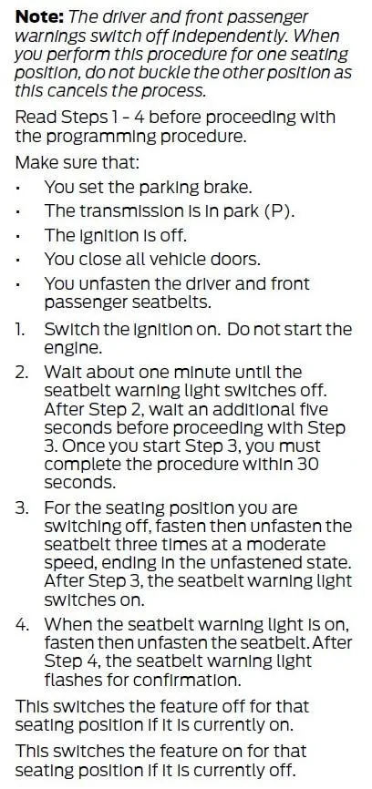

According to page 47 in the owners manual, here is the procedure to deactivate seat belt warning for each seat. Problem is, I cannot get it to work on an XL hybrid.
Let us know if you have better luck................................

You will pull your hair out, just leave them all buckled, or buy a few buckles from Amazon to fill them up, they are like $5 each.
Yep, tried that. Didn't work. '23 XLT Hybrid Lux.

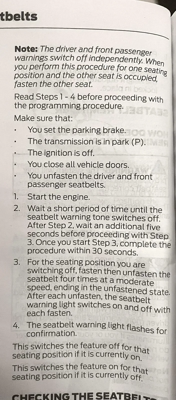

Ok folks, here’s the updated procedure from my 2024 owners manual.:
Looks like difference in the new procedure is that you start the vehicle.
Ford Maverick How to Disable Seat Belt Reminder Ok Button Push? IMG_1992
Update: I just tried this procedure on my XLT Hybrid. Here are my learnings…
1. The procedure does not work if there’s weight on the seat.
I tried it twice for the drivers seat while sitting in it and got no response. Then ran through it again (for the driver seat) while sitting in the passenger seat and got the seatbelt icon to flash like it says in step 4.
2. Even though I got the seatbelt icon to flash after going through the procedure for driver and passenger… nothing has changed. It still dings and the pop-up still comes up.
…maybe other trim levels will have better luck.
What’s even more annoying is the Hybrid has an additional popup just to let you know the truck’s ready to go. I assume this is some legal ass-covering from Ford because it’s silent when in “running” mode.
I work at an electric motorcycle company and we’ve had many instances during demo rides where someone twisted the throttle without realizing the bike was on. Little green run/ready icons are easy to ignore…
Making someone click through multiple pop ups every time they use the vehicle definitely isn’t the best solution.
