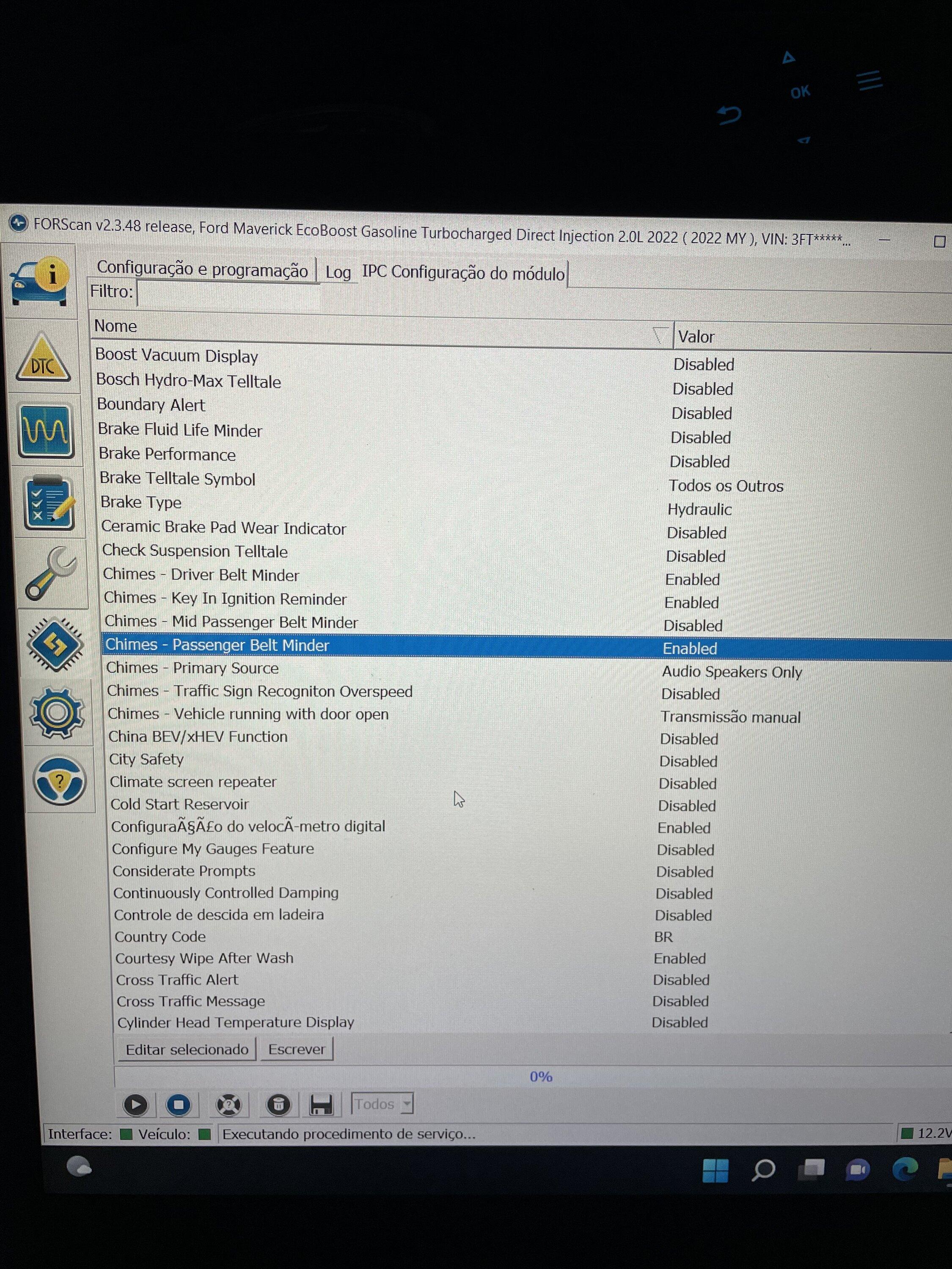

It’s possible to disable chimes and the pop-up reminder using FORSCAN. I did it in my truck.
Can you share the appropriate sections in Forscan to do this ? Thanks!
uga
Jan 9, 2022
621
814
SE USA
2026 Ford Maverick XLT
No Go! Mine already show disabled. Something must be overriding any changes or changes have to made under IPC As Built.
