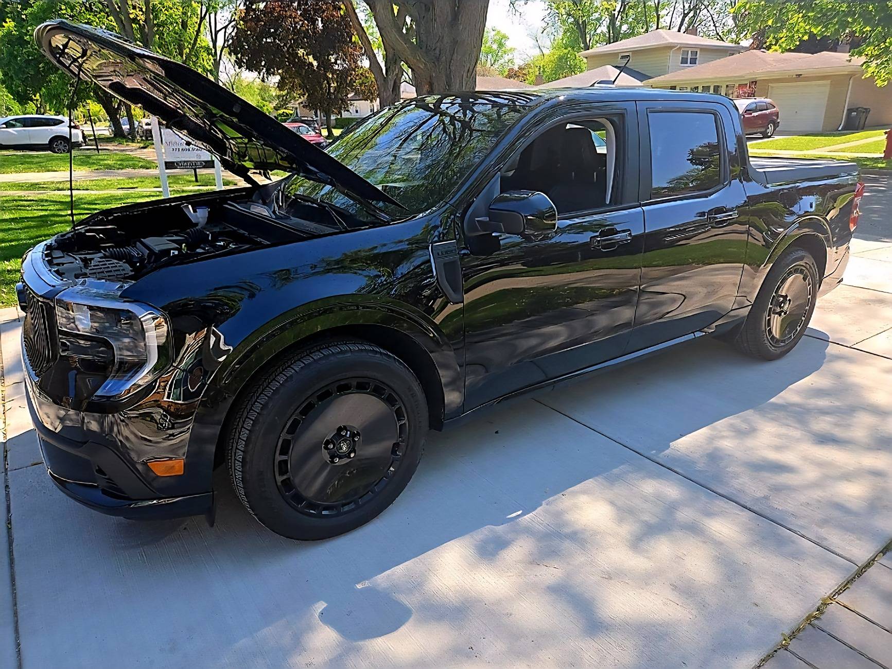

A bit of a Potato pic, but looks good at that height. I'm considering these springs.
I did a quick fix on the pic:
Ford Maverick Lowered Lobo on Goodwin Lowering Springs Screenshot_20250522_173724_Chrome

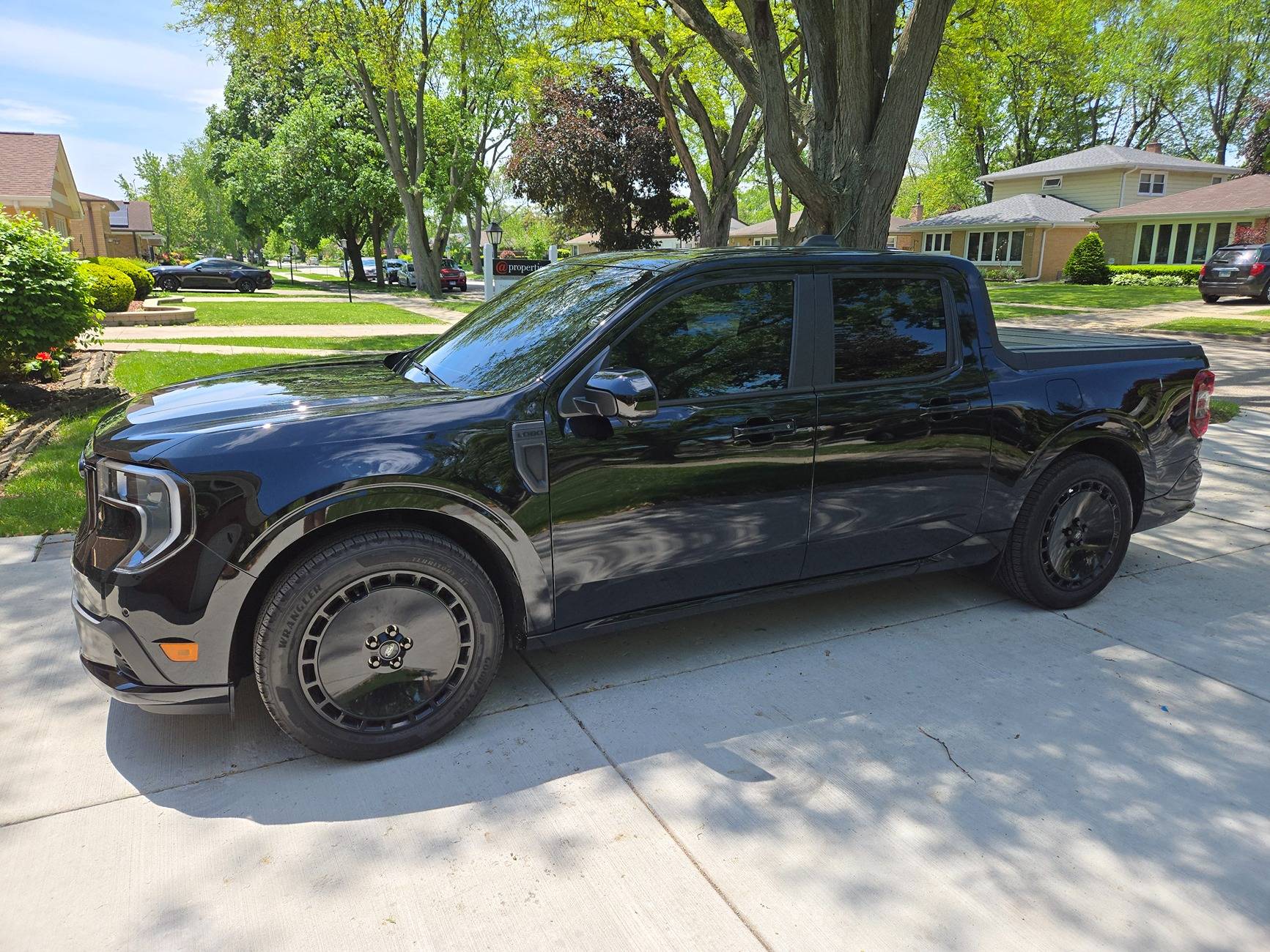

Update. I'm dumb. The front left spring wasn't seated correctly in the strut tower. It was binding. Endlinks were fine. Redid that corner and now it's perfect.
I've been pushing more this week and man it does feel much more planted. The ride is noticeably worse but it comes with the territory.
I recommend these if you want an improvement over a stock lobo and are OK with a harder ride.

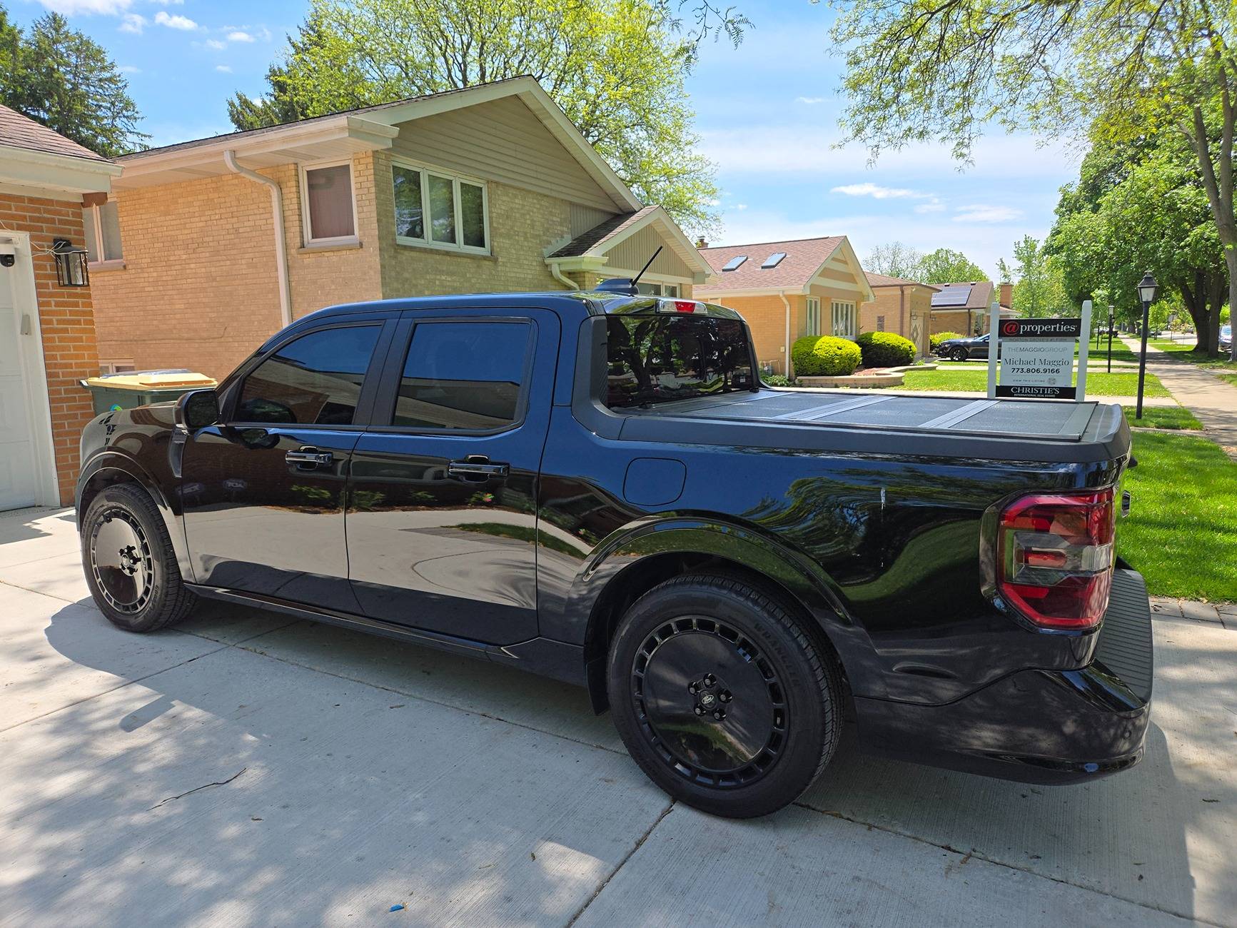

Really like these. Amazon said they wouldn't fit, but they do. Just slight poke in front.
Ford Maverick Lowered Lobo on Goodwin Lowering Springs 20250515_143225(2)
