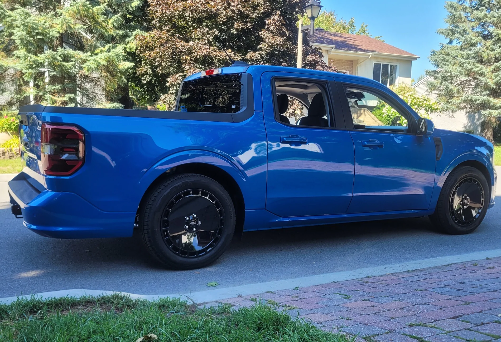

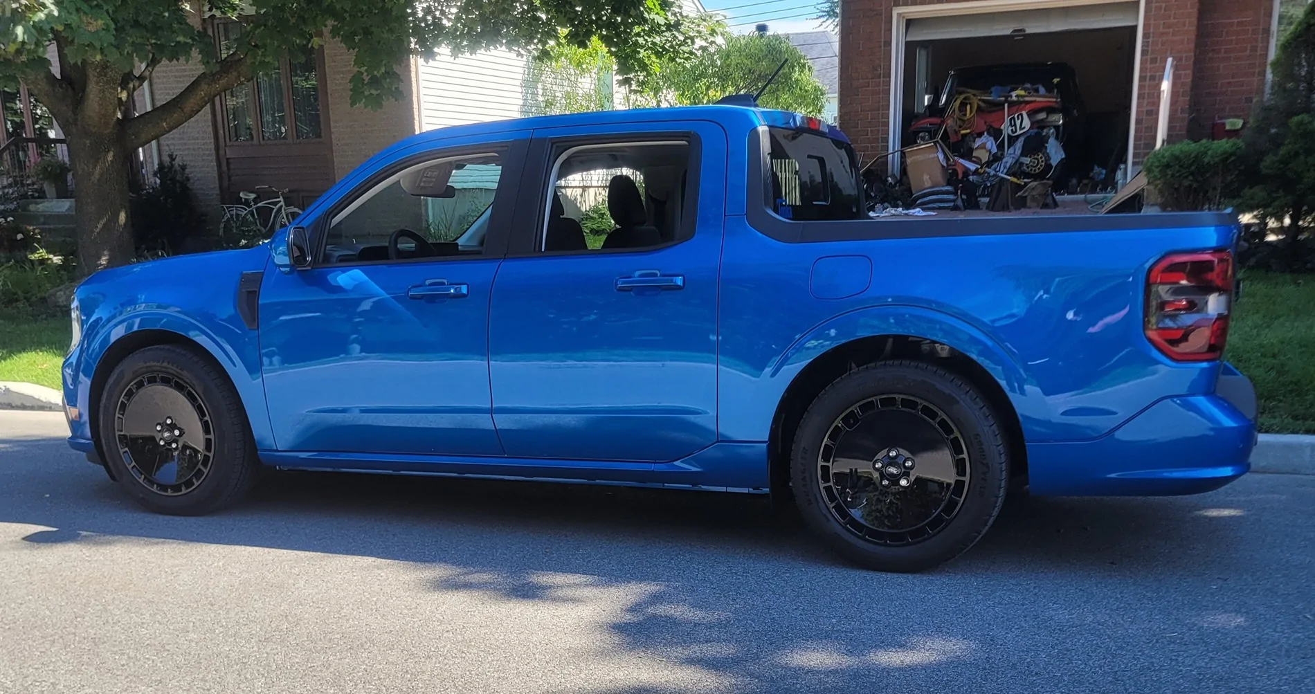

I lowered my Lobo with Eibach springs.
I have not taken it for an alignment but plan to have it checked when it's at the dealership for a recall.

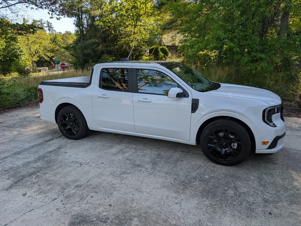

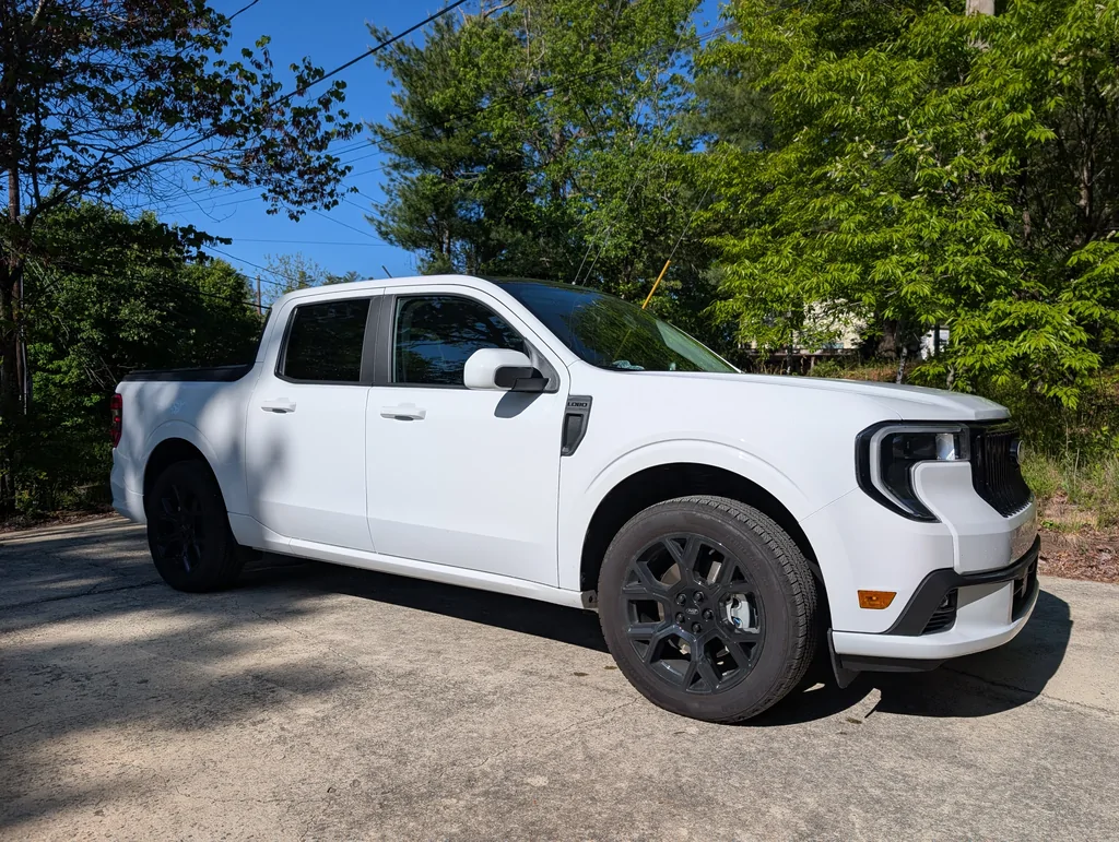

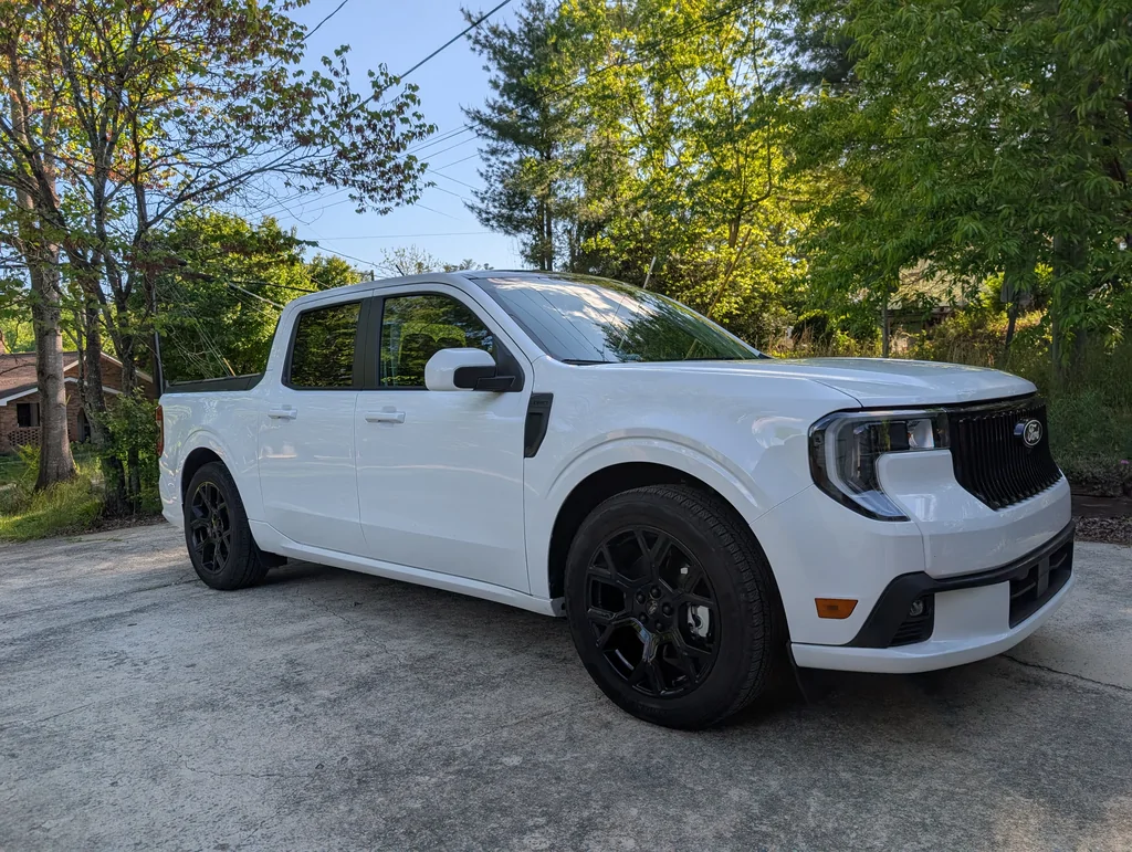

Good-Win springs are in! Still expecting them to settle just a little bit, but after a test drive everything sounds and feels perfect! Still drives straight as an arrow even; although I'm still going to get it checked out at an alignment shop just to be safe.
Here's a before just for visual comparison:
Ford Maverick Lowering Springs - What else to change/replace/upgrade 1777845405762-11
And after:
Ford Maverick Lowering Springs - What else to change/replace/upgrade 1777845426836-36
Ford Maverick Lowering Springs - What else to change/replace/upgrade 1777845338975-dt
Ford Maverick Lowering Springs - What else to change/replace/upgrade 1777845319999-7u
