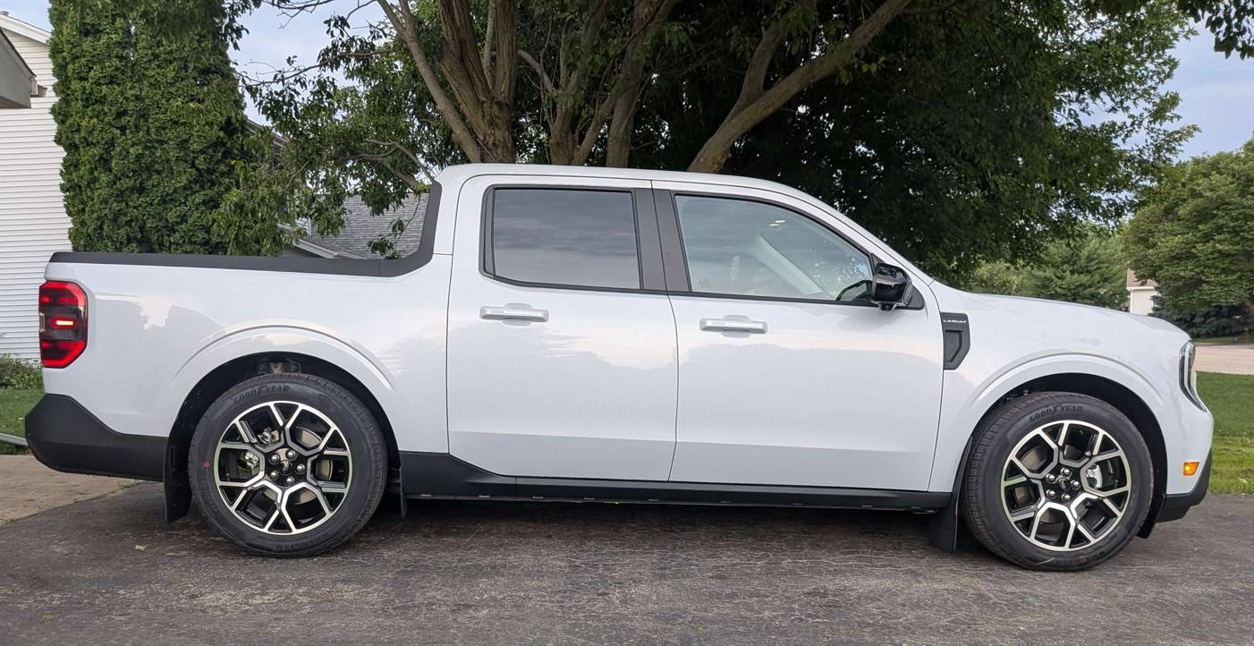

I have a Lariat with 600 miles I just put goodwin lowering springs on. I am getting a ticking or clunking sound from the rear only when I hit bumps at low speeds, does not happen above 30mph. I have triple checked the install and I am looking for feedback on what could be causing this. I'm thinking maybe it's the sway bar end links because I've had the same issue on my WRX before, but I wouldn't think my end links would be bad out of the factory.

Looks great with the OEM 19s!
For the noise, did you loosen the rubber suspension bushings and re-tighten them with the truck sitting on its wheels at the new height? Not sure if this would be the cause of the noise but if you haven't done it there will be preload in the bushings which you don't want

I did support the rear suspension with a jack while I torqued the bolts. Think I'll try disconnecting the rear sway bar tomorrow and driving it.
Also, are the suspension bolts torque to yield?

I disconnected the sway bar today and it was still making the noise. Took the springs out and checked the orientation and reinstalled for the third time and it is still making the sound. I guess I will just run them until the sound starts to get louder or I can't take it anymore and just go back to stock. This is really frustrating honestly.
As far as the ride goes, comfort level is close to stock, but feels more planted in turns.
