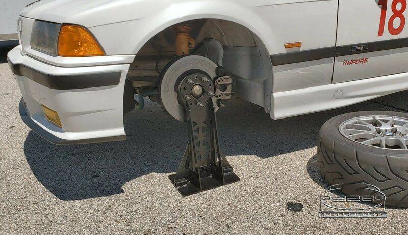

Most anything with a rubber bushing in it needs to be final-torqued with the weight of the vehicle on the wheels.

How would your torque the endlinks on the ground?
Not on the ground. Weight of vehicle supported by the wheels/tires, is what I said. That means up on a lift, or you can even sit the tires on top of some sort of cribbing on your garage floor. Race Ramps makes some nice risers.
still no way in hell you're getting on the lower end link with the wheels on. upper with the right tools, sure.

Just put a jack under the suspension corner you are working on (with no wheel) and jack it up until the Mav just starts lifting up. That means the suspension is loaded and you can tighten all the bolts needed.
Against the rotor?

Against the rotor?
lower control arm. you might have to jack the heck out of it to reach normal sag but I guess I see the concept.
