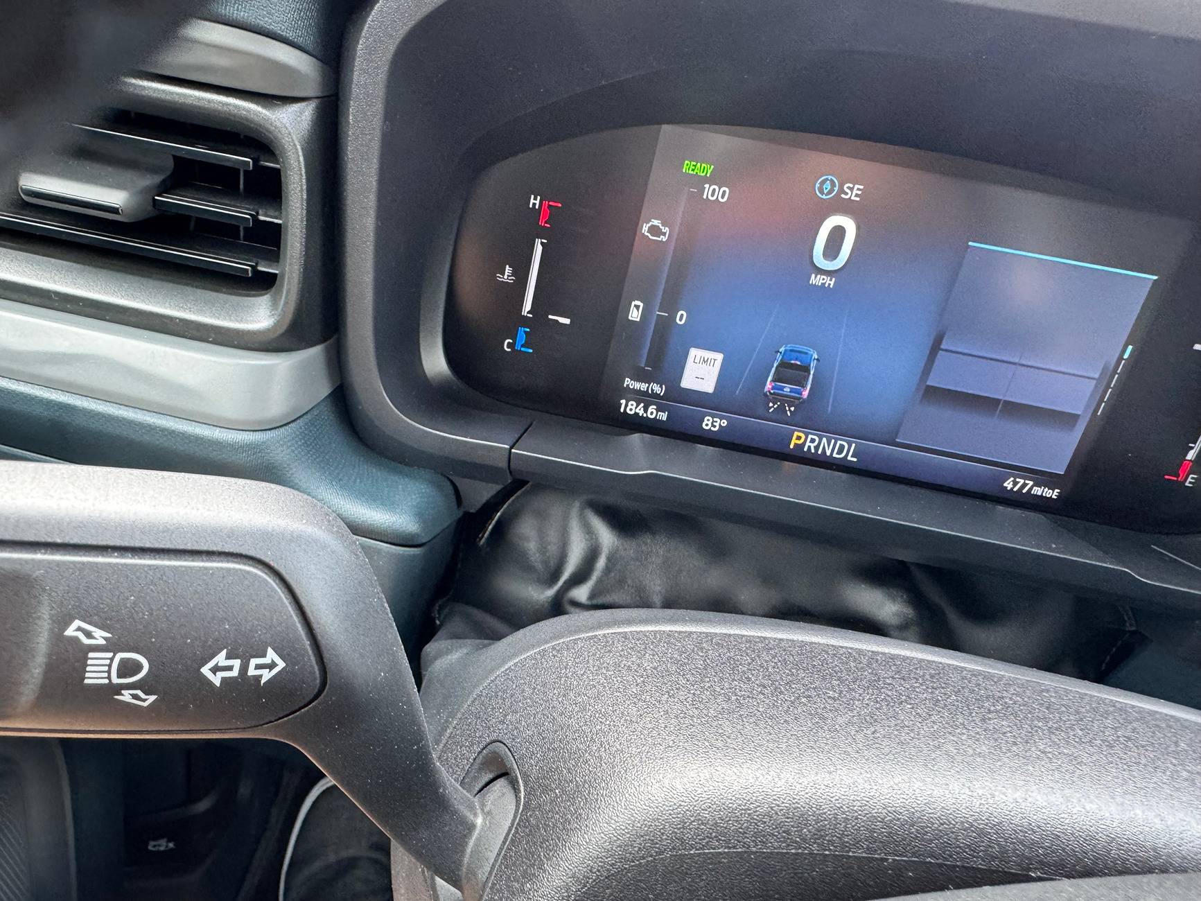

They're all installed correctly. People just assume that they should be attached on the sides.

First off, loving the truck. Yeah, a lot of interior stuff is cheap, but it feels honest, none of it is bothering me yet.
... except for this, which I only noticed a week or so into ownership, and welp, I finally found an extraordinary Maverick cheap-out that stunned me. I've NEVER seen something like this in any car or truck I've ever driven in nearly four decades of motoring, including some of the cheapest penalty boxes sold in America. Like, who just gives up and puts a curtain on a steering column? Lada? Yugo?? What kind of money does this even save for you, Ford?
Now, it wouldn't bother me half as much if the curtain (or cover, or jacket, or drape... anyone know the technical term for this part? Couldn't find it listed in any Ford parts schematics online) wasn't detached from both ends, hanging loose (see this thread for a clearer example: https://www.mavericktruckclub.com/forum/threads/top-steering-wheel-column-to-dash-cover.51786/). The best I can do is kind of tuck in both ends, but it still pops out. It doesn't shift out unless I adjust the steering column, but expecting my better half to need to do that whenever she borrows the truck, that means this thing's gonna shift out often.
Anyway... griping aside... as ridiculously minor a thing as this is, is this still something that can be fixed under warranty? While I change my own oil, I'm going to at least get my first service done at a dealer just so they have to face the rumored hassle of taking off the filter for the first time, so I'm wondering whether this is something I can ask them to address while I'm there... or am I only now discovering a Maverick flaw ("quirk," if we're being polite) that we all just live with?

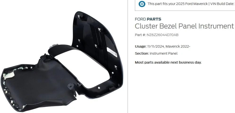

Part seems to be sold as part of the IPC Cluster Bezel Panel Instrument
NZ6Z26044D70AB
I had guessed it would be part of the Steering Column Cover Shroud
https://parts.ford.com/shop/en/us/b...eering-column-cover-shroud-p-lj6z3530ba?pdp=y
SKU: LJ6Z-3530-BA Positions: Upper Other Names: Shroud, Upper Shroud, Shroud Assembly Steering Column Description: Escape. Upper. Bronco Sport. With keyless entry/start. Maverick.
Steering Column Shrouds - 501-05 Interior Trim & Ornamentation
1. Fully extend and lower the steering column
2. Release the tabs and position the gap hider aside
3. Release the upper steering column shroud front clips.
Instrument Panel Cluster (IPC) - 413-01 Instrumentation, Message Center and Warning Chimes
2. Fully extend and lower the steering column.
3. Release the clips and remove the gap hider from the upper steering column shroud.
1. Remove the bolts.
2. Release the clips and remove IPC trim panel.
Cluster Bezel Panel Instrument NZ6Z26044D70AB
https://parts.ford.com/shop/en/us/b...bezel-panel-instrument-p-nz6z26044d70ab?pdp=y
Ford Maverick Loose leather steering column "curtain"-- really, Ford? 1753053170715-lz
