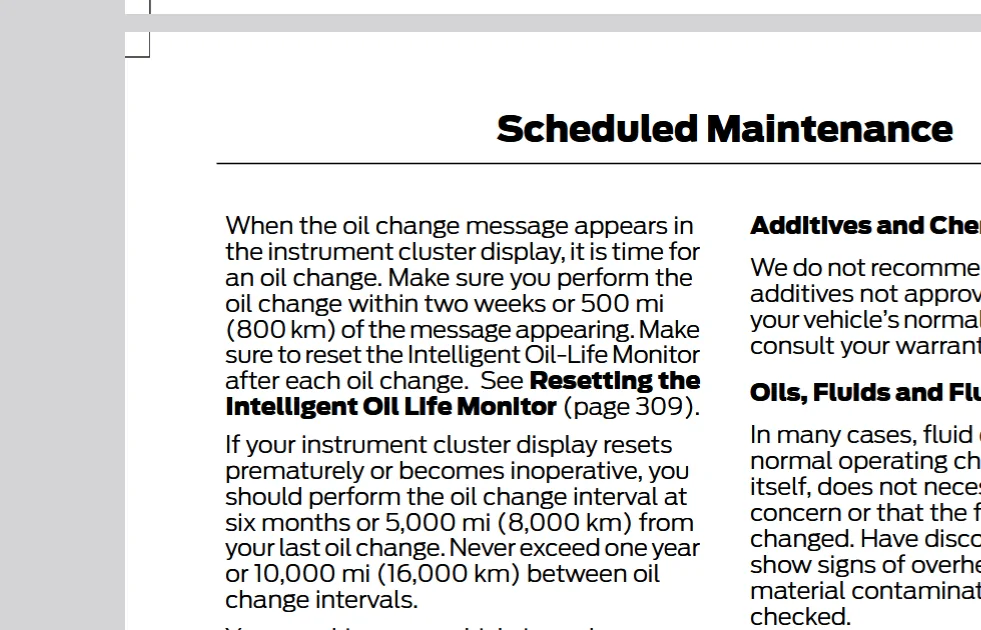

It's 5,000 miles or 1 year.
Please stop advocating for guidance contrary to manufacturing and warranty specifications. Open your manual or search the web. Directly from the manual:
Ford Maverick Longest hybrid oil change interval?!? 1777592168205-4f
And if that isn't enough, multiple owners have reported OLMs allowing over 10,000 miles and independent oil testing showing within spec (meaning still providing appropriate lubricity) well beyond 10,000 miles.
The above guidance is for BOTH the Ecoboost AND Hybrid. Hybrid oil life will be longer because the engine doesn't even turn for a good portion of the miles and rarely idles.

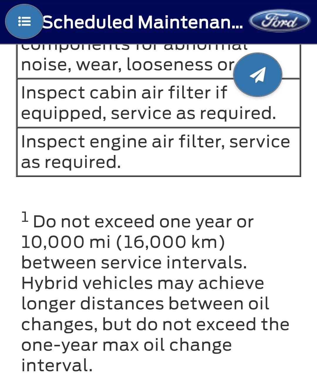

It's NOT 10k miles for the hybrid.
It is 12 months max. Or.
Whatever the usage allows if less than 12 months.
The manual, looked up in the app by my VIN says Do not exceed 1 year or 10,000mi, but then says Hybrid may achieve longer distances, but do not exceed 1 year. Just a bit confusing on the mileage.
Is a bit confusing. Surfstar’s OP is asking for mileage data points beyond the 10,000 before the 12 month reset.
So far, heybales hit 11.1 thousand. The Member who is at 25,000 and counting did multiple resets - so not really a valid point until the reset numbers they reset at are known.
I think Ford should say “15,000 miles or 12 months” for the Hybrid.
EB don't exceed 10K.
Hybrid you may exceed 10K.
Neither over a year.
Pretty sure I know what super basic rules the OLM is following.
Not that confusing really.
