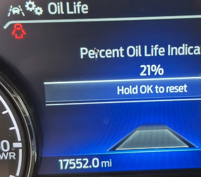

Ohhh - and if you use Ford app - what does it show for the OLR% and estimated distance if given?
Only 21 mph avg which seems like city miles - but that 35 mpg makes me think decent highway miles.
My commute is only 2 city miles, to work, home for lunch, back to work and home for the day. I have a 3 hour trip (1way) about 1x a month to see family and drive 20 minutes (1way) to the next city about 1x a week. I listen to music while washing or working on my truck (except oil changes :) ) so that drives the average down.
OLM was 21%

Ya - I think the whole avg mph math doesn't work for hybrids - many of us know to keep it running in situations you'd normally turn a vehicle to Acc or Off. Because all it basically does is charge the 12VB rather than drain it - a good thing.
So maybe above 790 monthly mileage, 80% highway, for that 7514.8 miles. ETA: 884 miles.
So you are closer to the 1 yr time cutoff probably than mileage cutoff? ETA: Not.
About 9.5 months from last oil change? ETA: 8.5 months.
So it is interesting anyway - with 2308.2 being EV miles, about 30.7% EV usage.
ICE only has 5206.6 on it.
If you keep that up for the remaining 2.5 months - abouts 9492 total miles.
2914 EV.
6578 ICE.
And while some might complain you are over that 5K with a bunch of daily short trips and need an oil change - you have 1 weekly trip with total warmup, and very gentle long highway monthly. (probably great for 12VB charge up).
My 2005 Rav4 has 6000 m/6 month oil service. Not far removed from that.
(for anyone about to complain - no not comparing a Ford engine to a Toyota - but the oil now is much better than 2005 spec'd)
Oh yeah - for grins did the math if that 21% was totally based on mileage. ETA: this is correct.
7515 current for 79% usage - 1998 for 21% more - 9513 at 0%.
2920 EV.
6593 ICE.
Well - how about that. Maybe you are on a distance based estimate and not time.
ETA: Post that last oil change was almost 8.5 months ago - so this is NOT time based OLM, but mileage based.
My last bit of math for grins is the correct one.
6600 miles on ICE with modern oil and gentle driving.
Last change was at 10037, Aug 17, 2025
5135.4 miles, of which 1224.1 were electric.

So to my post - it is based on mileage, not time.
Correcting my post.
Correcting my post.
From other posts on here, time also factors in, probably for those that drive less than I do. I'm sure there's at least 2 calculations to meet the 10,000 miles or 1 year recommendations.
Absolutely.
I meant your example was based on mileage, not time. Easy to see that 21% remaining is not 3.5 months.
Time is 1 yr max, mileage may float over depending on the factors.
Yours won't.
