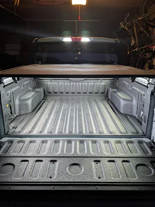

Just installed these on the vertical wall of the bed
Looks great. Do you mind posting a link to which set of lights you bought?

The link below. Cut them to fit (and caulked the cut end). Then tapped into the bed lights with posi-taps, so they come on and off with the factory lights and key fob
Never knew something like Posi-Tap existed.... Tapping into the standard bed light is a great idea.

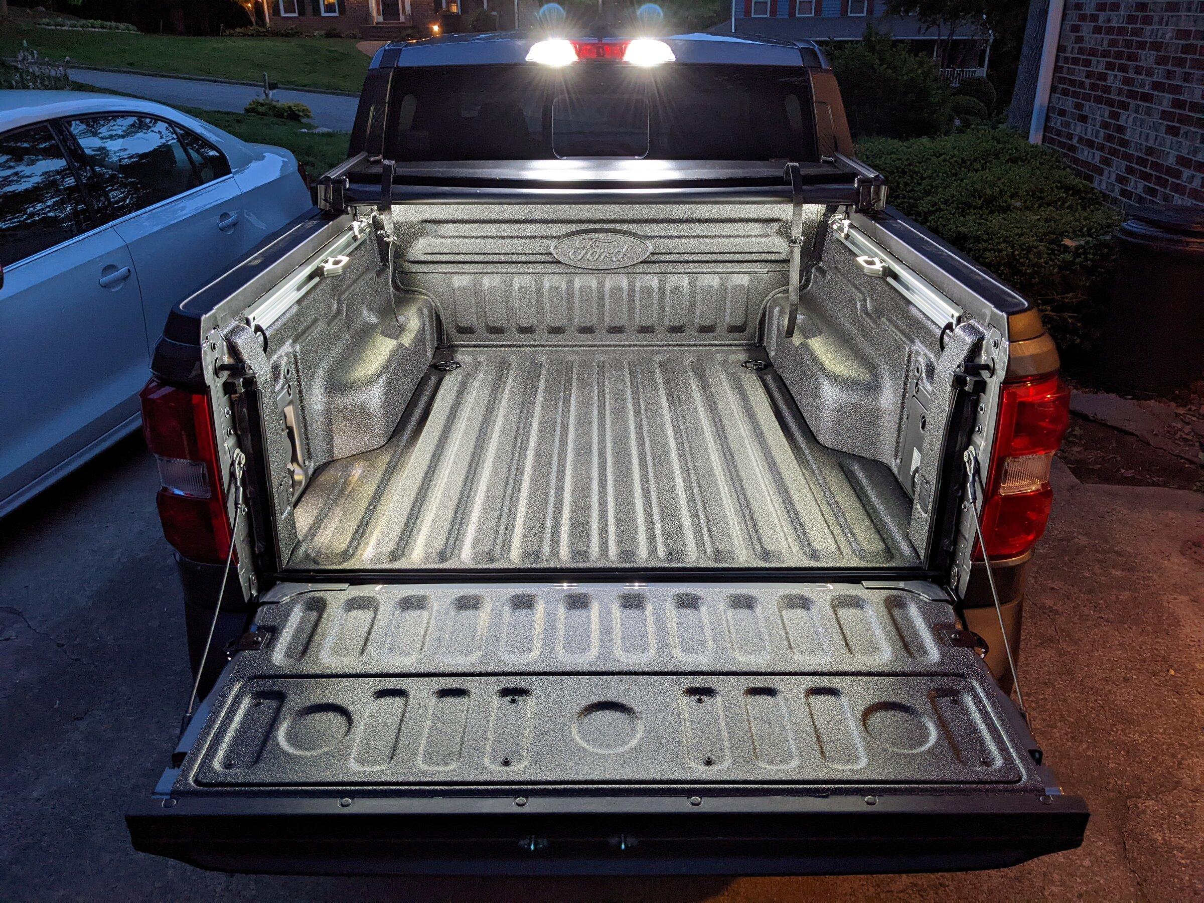

This is a nice video, thanks for posting. I removed the cubbies instead of the tail lights, but same idea. I also used zip ties with push-in plastic "trees" that fit in the pre-drilled holes in the bed for extra security. I didn't trust the double face tape to stick on my bed liner.

I did the same. I didn't even bother using the double sides tape.

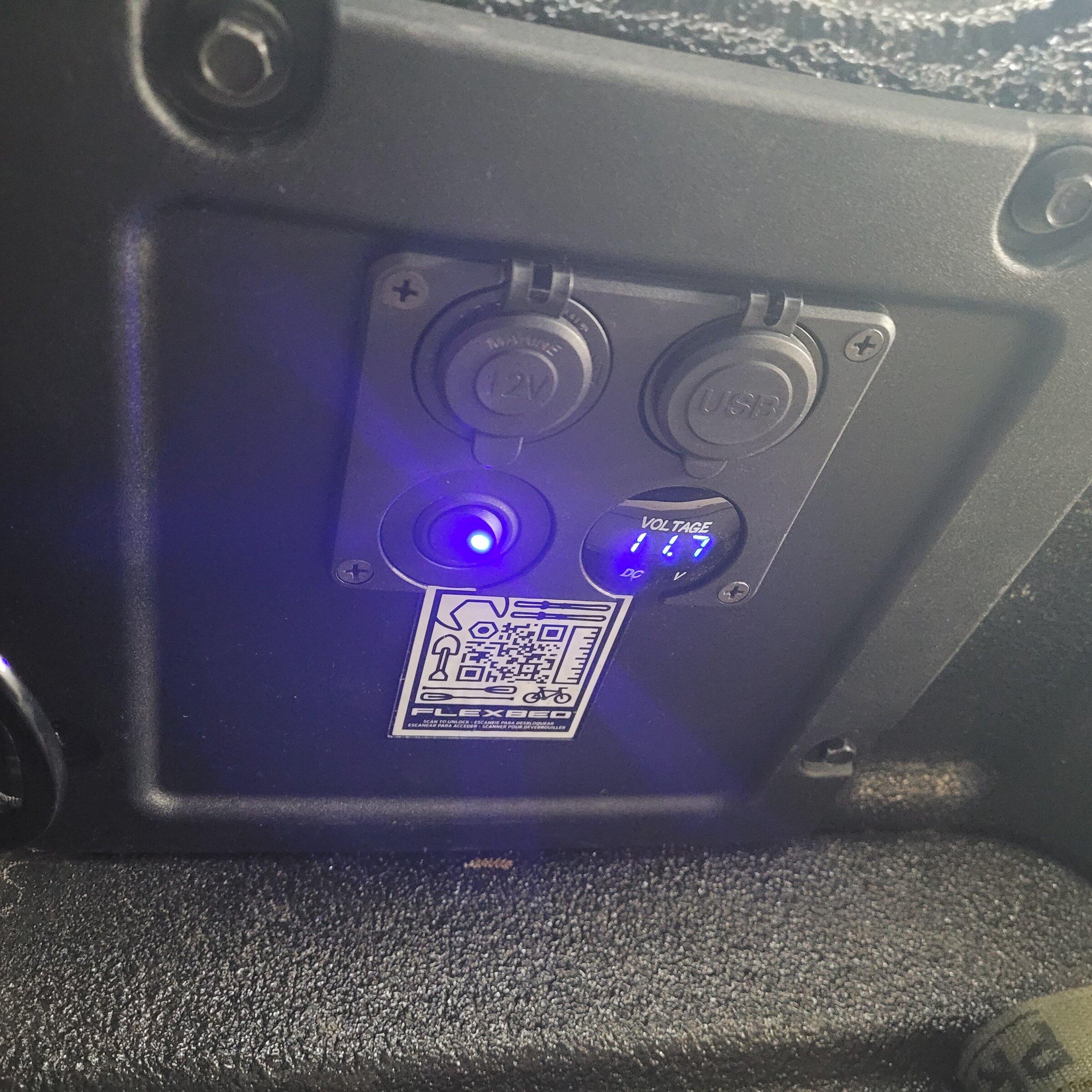

For the switch, this is what I used.
SUNJOYCO 4 in 1 Dual USB Socket Charger 2.1A & 2.1A + LED Voltmeter + 12V Power Outlet+ ON-Off Toggle Switch, Multifunction Panel for Car Boat Marine RV Truck Camper Vehicles GPS Mobiles (Blue)

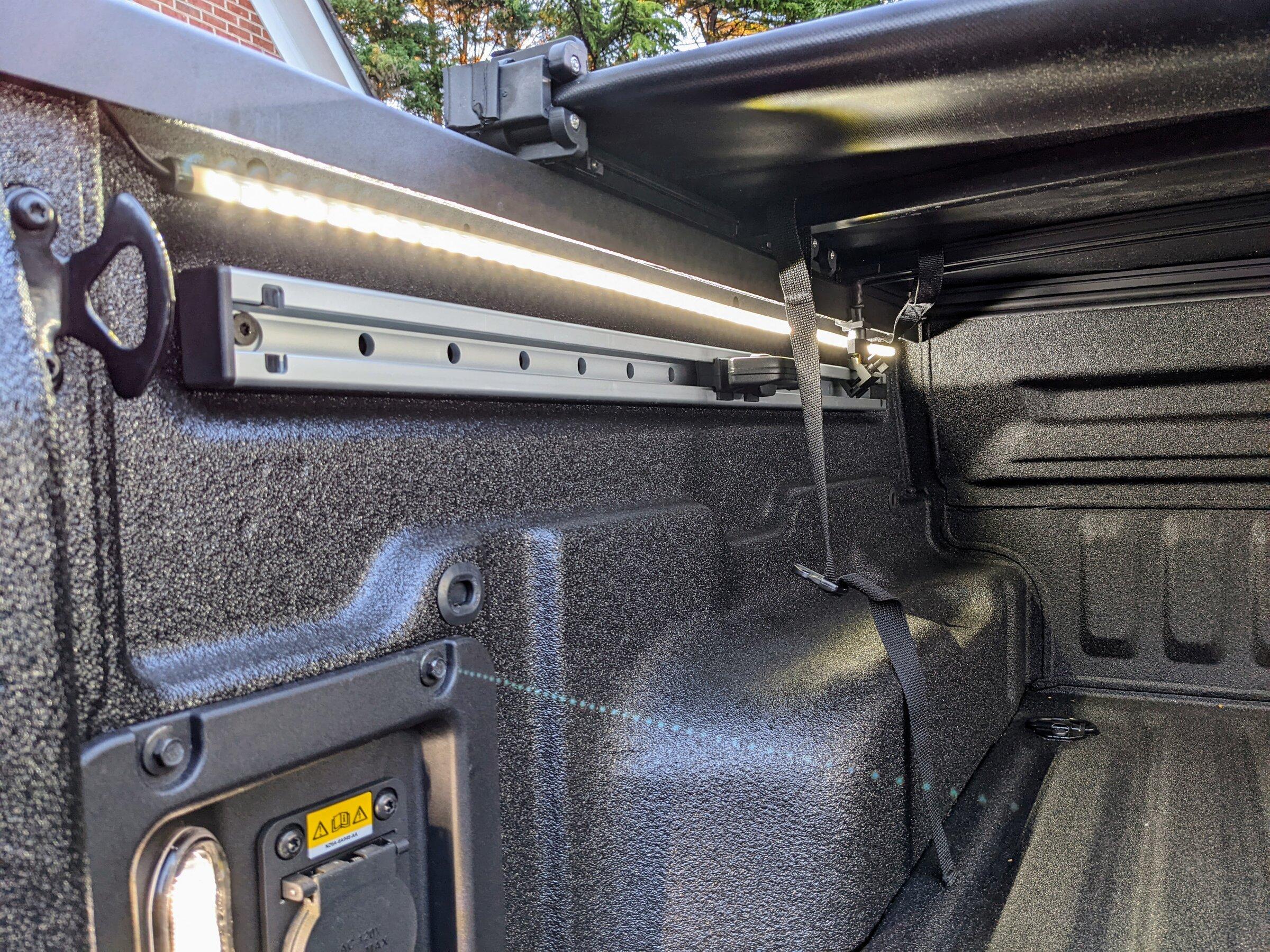

Here's a closeup of where I mounted my LED strips - identical placement on the other side
Looks absolutely perfect
