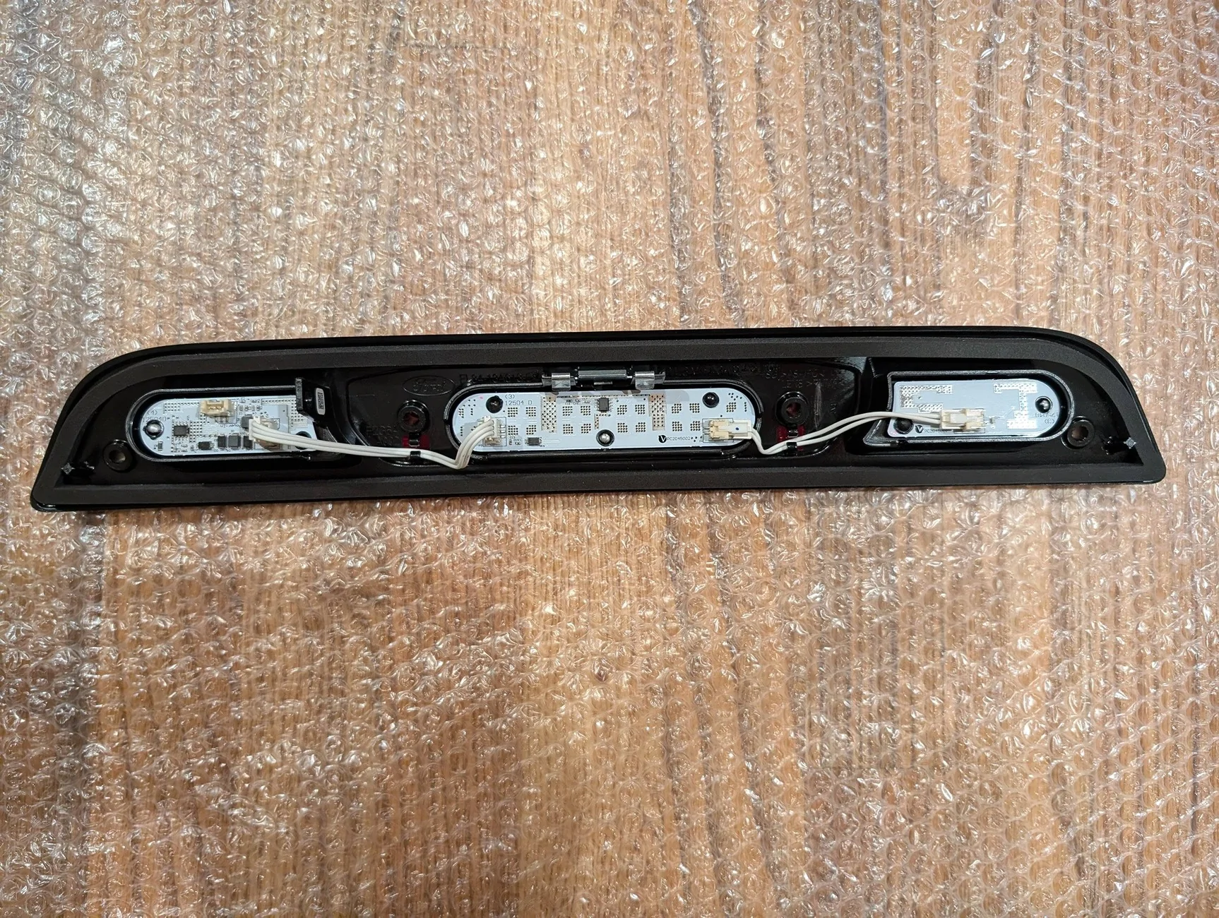

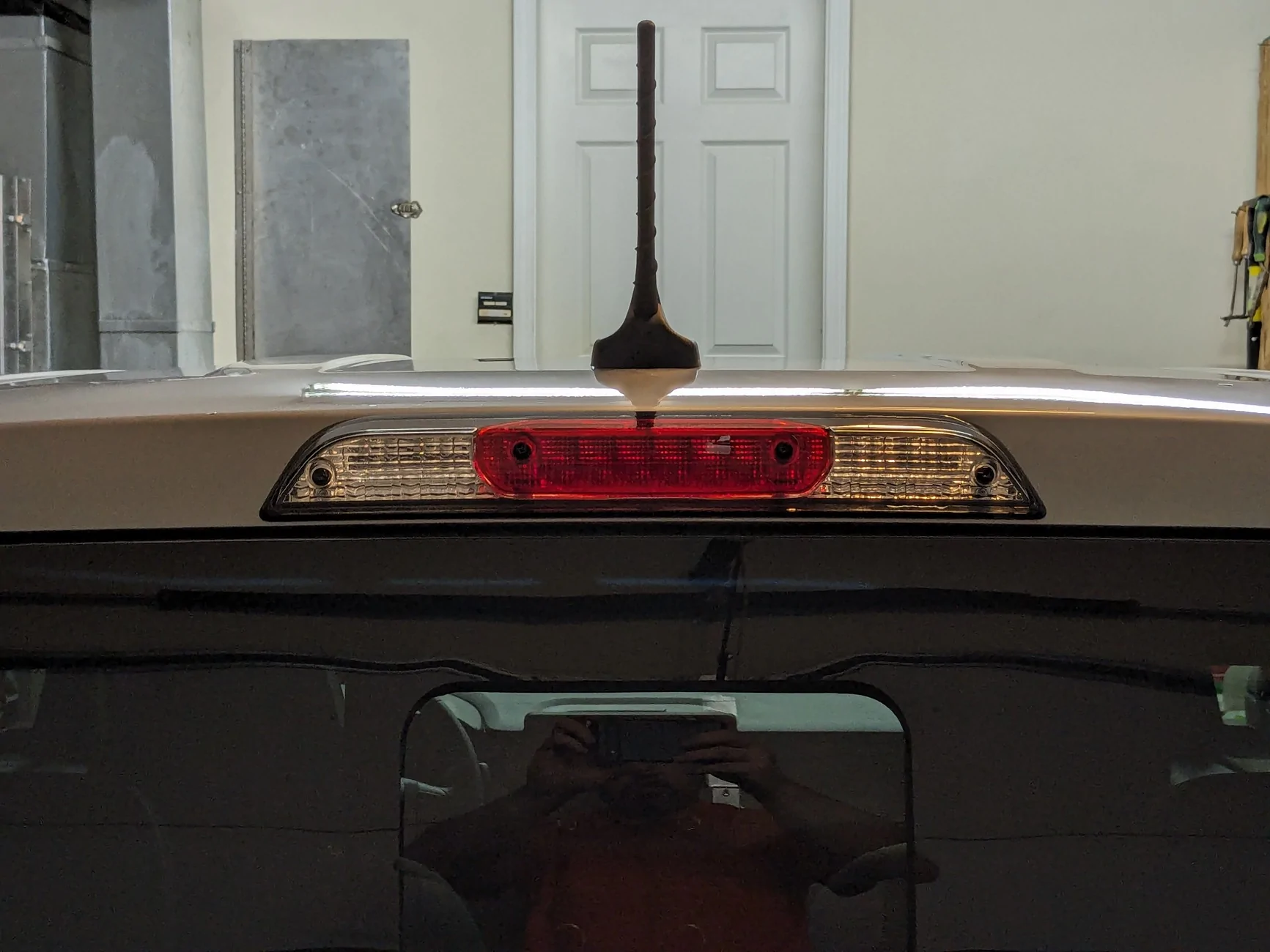

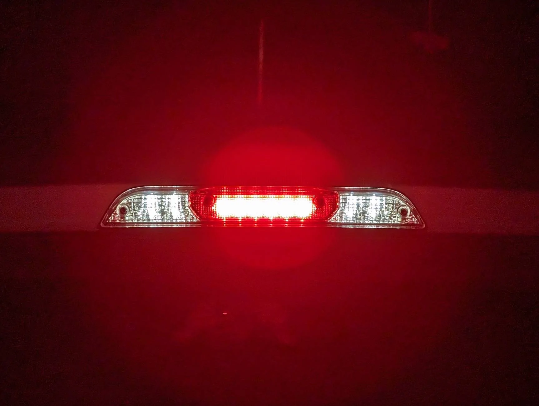

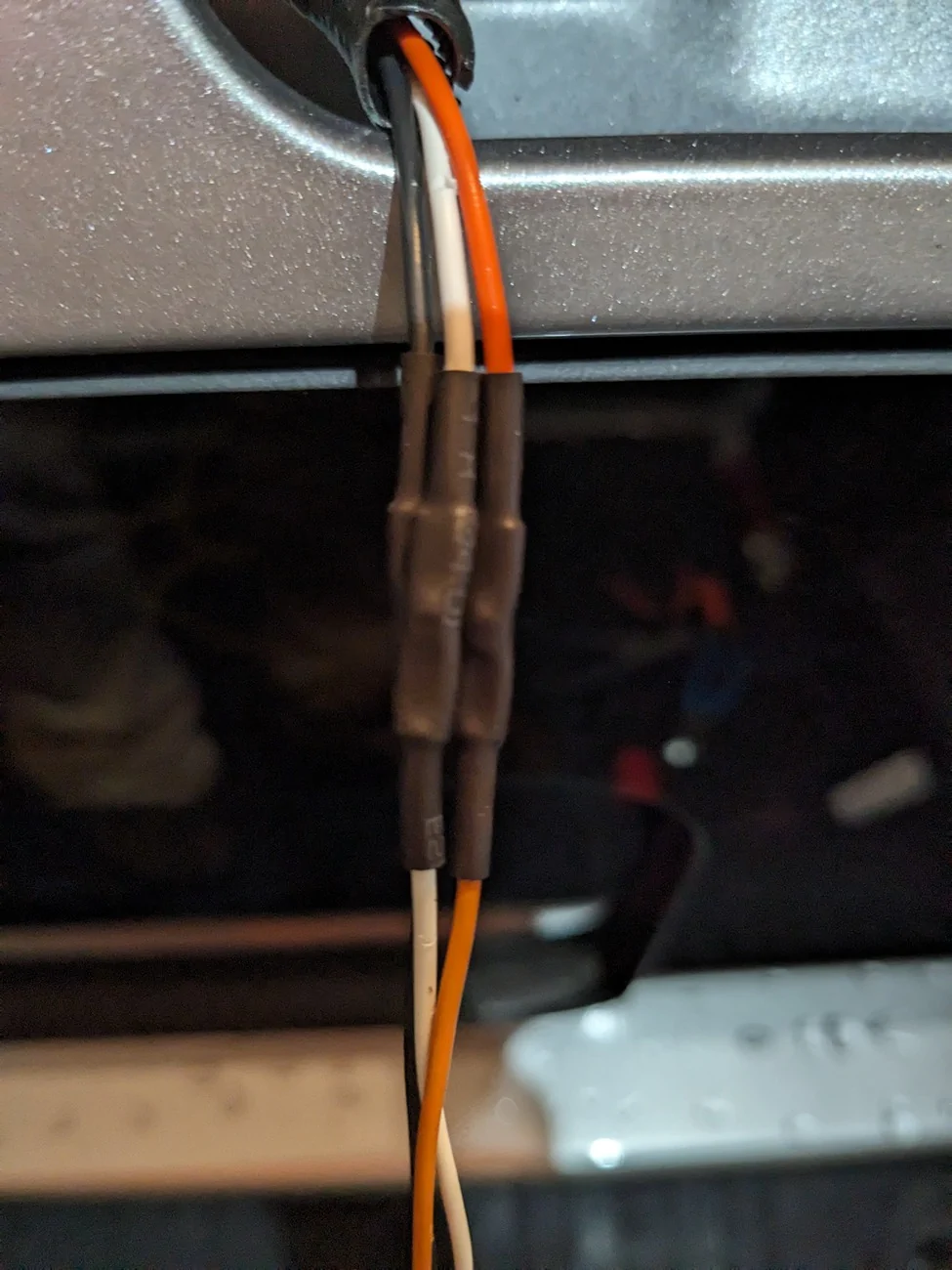

I installed an F150 LED third brake light assembly. From what I understand, some of the plugs are different depending on part number, but the actual light housing is the same. I elected to splice the wiring (colors match), using good crimps and heat shrink.
Fit is perfect, look is perfect, and OEM quality.

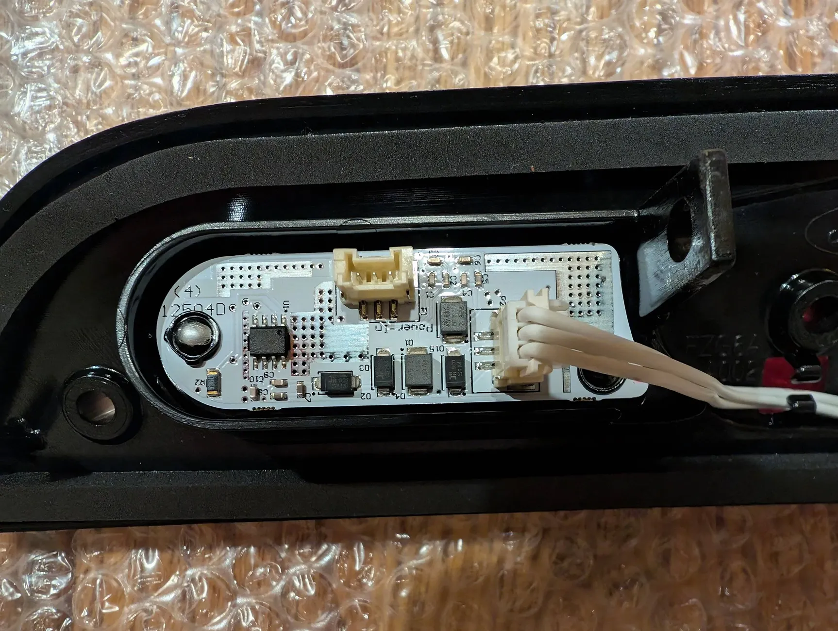

I thought I had a part number, will have to keep looking. I bought off eBay I think I paid about $100 or so, which is pretty comparable to a good set of aftermarket lights. It's been a couple years, so probably more now.
EDIT: I did a quick search and it looks like you have to be careful as some people are listing theirs as LED when they are not. Take a look at the pics carefully and you will see the shape of the red area is slightly different so it is easier to tell. I would only buy OEM. Looks like if you can live with a used part, you can be into it for about $60. If you want to hold out for new, might be able to find a deal or be ready to spend about $200.
Here are some pics:

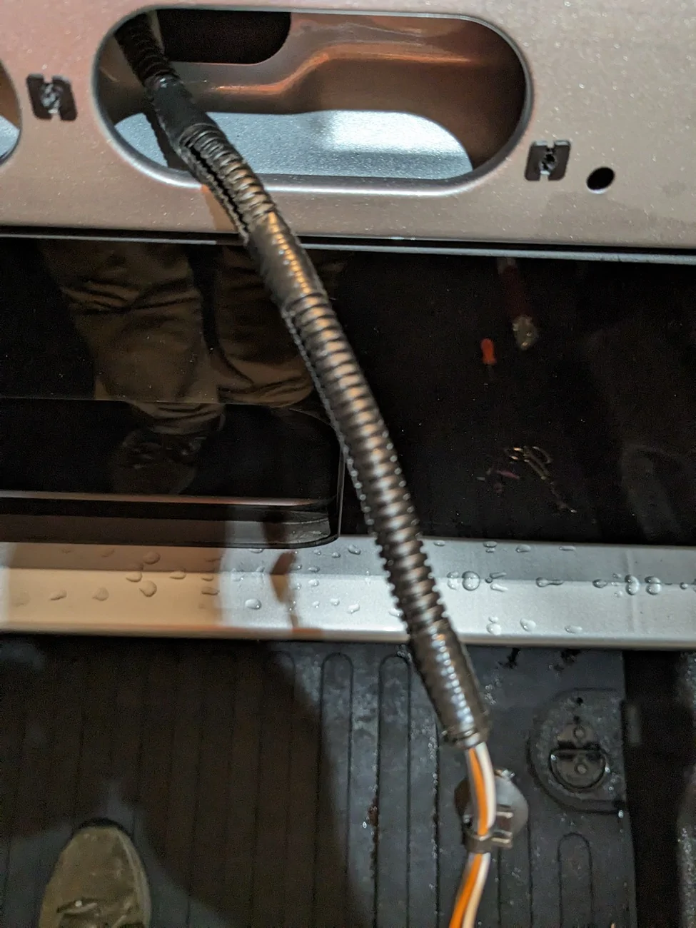

**The wire harness does unplug from the back of the light, so even after splicing it on, if you had to replace the light you easily could.
