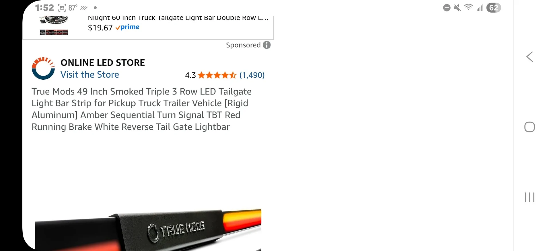

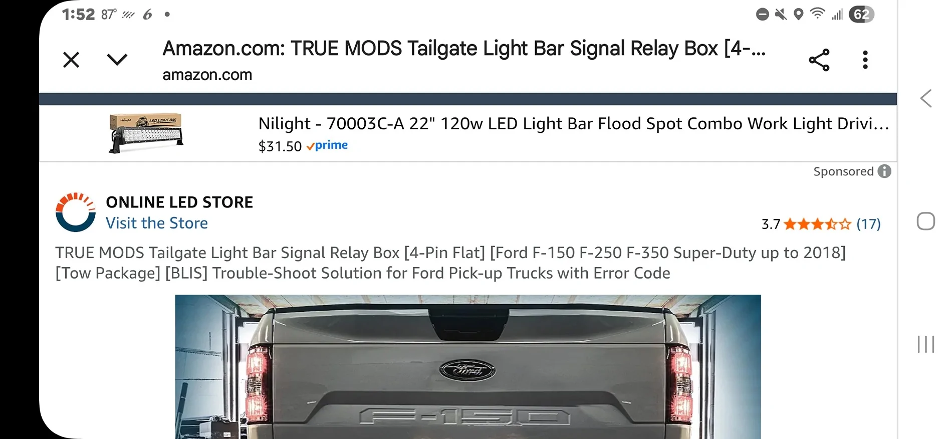

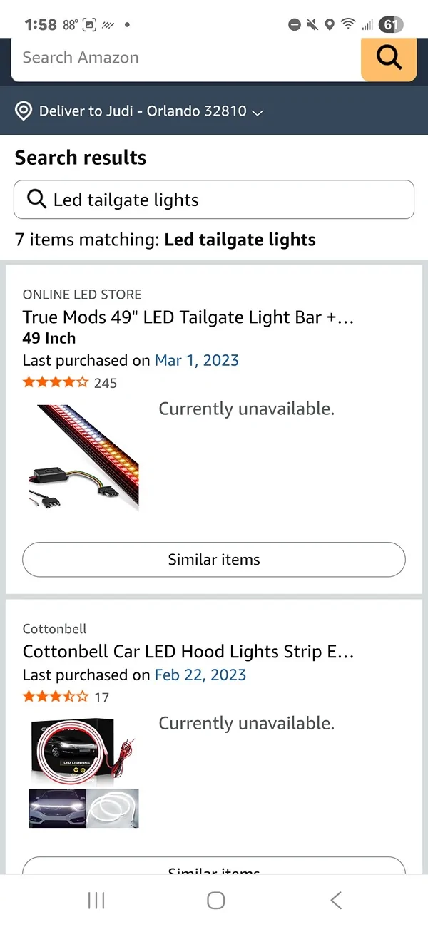

On my 23xl I had this ( 1unit- discontinued) before they made it 2 pieces to make this work. It makes it so you can use the 4way and still have guidelines show up on backup camera.Also put mine under bumper, for top of bumper interfears with tailgate.
Hope this helps.

OP doesn't want one that disables the BLIS. Looks like this one would disable the OP's BLIS since it plugs into the trailer hitch 4 pin connection (from what i can tell - maybe I'm wrong????).
That is correct...no reason to disable blis ...
