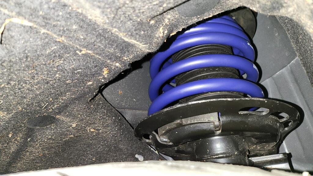

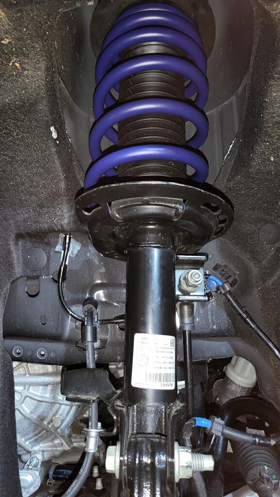

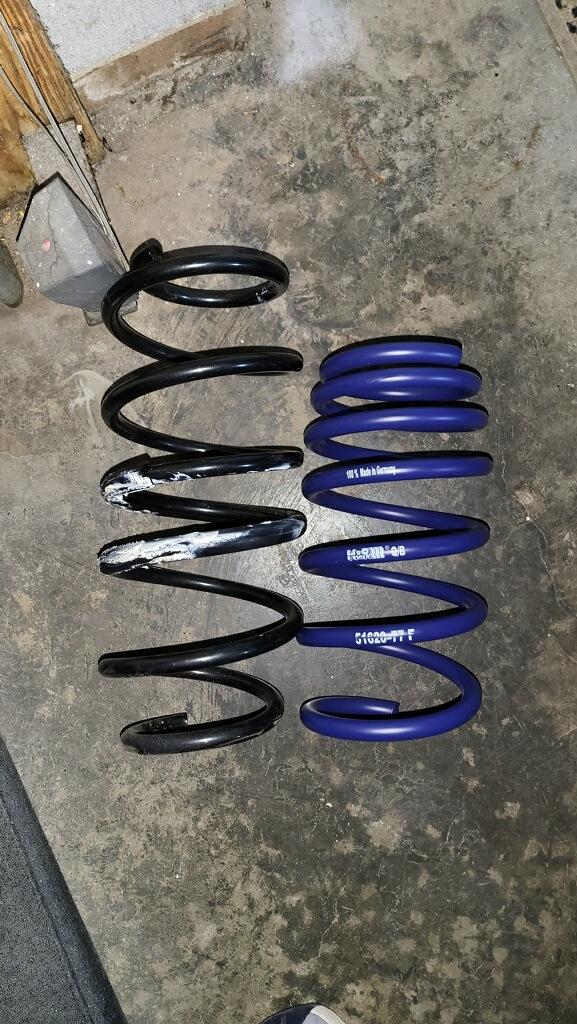

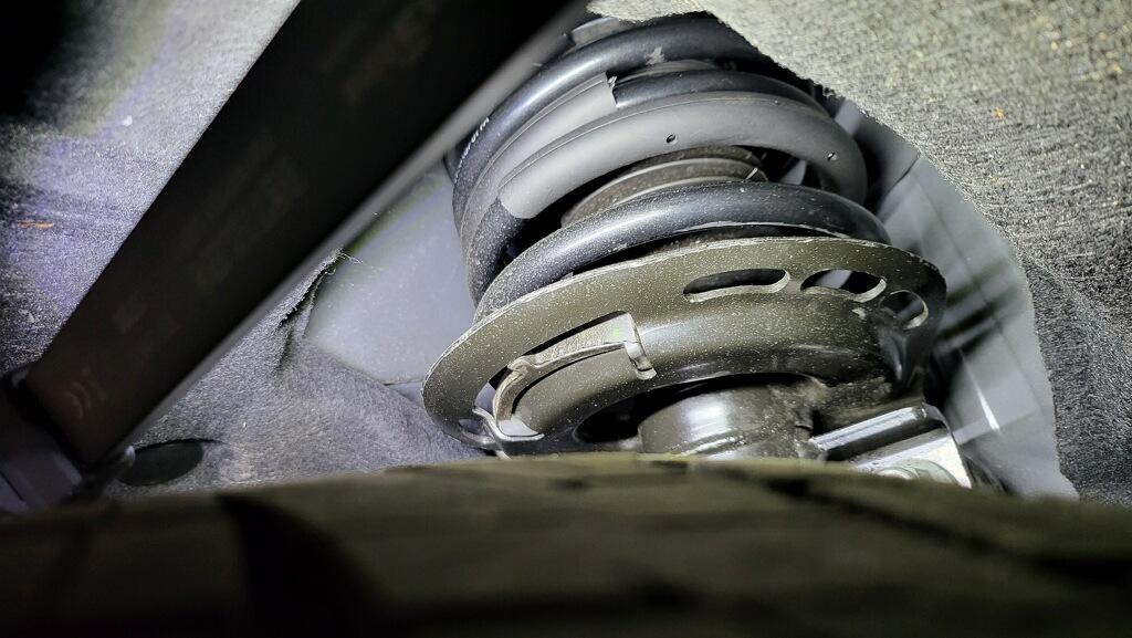

I "think" we might be getting closer to an answer...I don't have time to type it all out as I have to head off to work but my installer got the driver's side done last night. Here are some pics for comparison...He is gonna do the passenger side tonight and go for a test drive. I will say he said he has never seen a drop spring with the coils compacted in the middle of the spring like the Eibach's, they are usually on the top or bottom as these H&R's are.
Coil bind? That seems odd. It would make sense though that it would be making noise. I wonder if you could split some rubber hose and slip it over the coils to try and stop the noise?
At least you AWD guys have the option of using the H&R springs. Us Hybrid peeps are stuck with the Eibachs (for now) :(
Thanks for the photos! Those H&Rs look nice and well built, like they belong there. The Eibachs look a bit off, like they are smooshed in there. Were the Eibachs rubbing on anything? Eibachs look a little wider up top.
The Eibach's do have a plastic sleeve on them, you can tell from my pic because I tried the grease trick someone else told me about but it didn't work. From what I have seen, no matter which vehicle you have, FWD or AWD the eibach front springs are the same exact part number. So my guess would be the H&R front springs would work. I know that would mean buying two kits but that is all I can come up with.
If you can, please take photos of their bump stops and the stock ones (cut, uncut, whichever). Hope those new Eibach bump stops work out well for you.
The HRs look way beefier in person than the eibachs, and not sure if it matters but they felt way heavier too. They weren't rubbing anywhere as my installer said there were no wear marks anywhere. He even sent me pics of the rear eibach springs and they are compressed at the top of the spring, not in the middle like the front ones.
