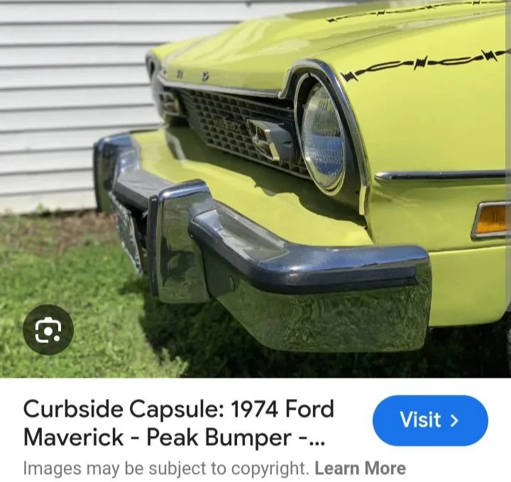

They were 5 mile an hour impact bumpers. The law mandating those bumpers was repealed in 1982.
I really doubt they would stand up to the type of hits at the Mavericks have gotten and they weren't mandated for trucks. They were God awful ugly. 🤮
Look it's even a Maverick

I was going to say, they re ugly on the front, though a rest truck bumper ought to be 5 mph capable. Ought to be, but probably isn’t. Although the one on my F-150 was very substantial.

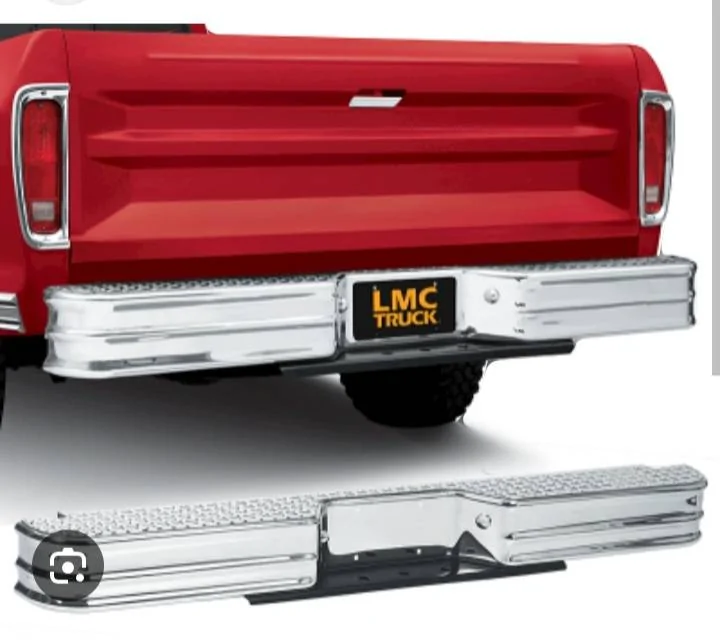

I remember those bumpers.
Ford Maverick It happened anyway - rear-ended 20241104_105713
Problem is physics. Unless it's mounted on shock absorbers.
Something solid like that bumper, mounted to a solid truck with no crumple zones something or someone is going to feel the impact. The shock will dissipate throughout the truck. Possibly breaking the seat back.

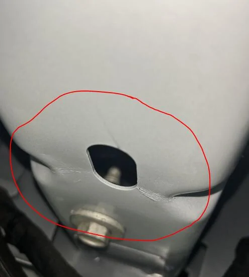

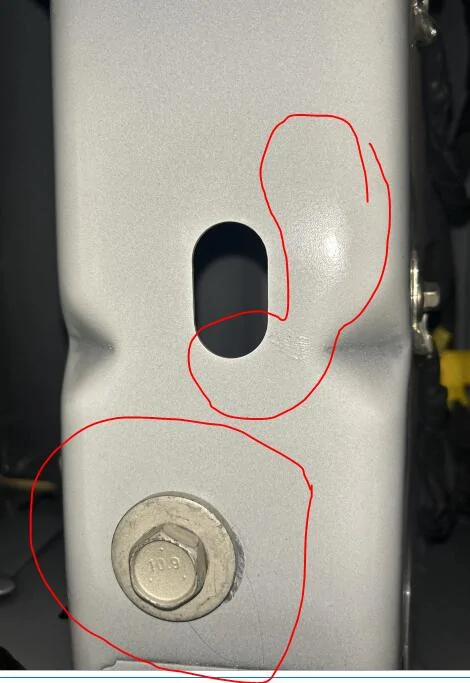

This is what they are calling frame damage:

From my insurance company "supplement estimate for a grand total of $43,114.17"

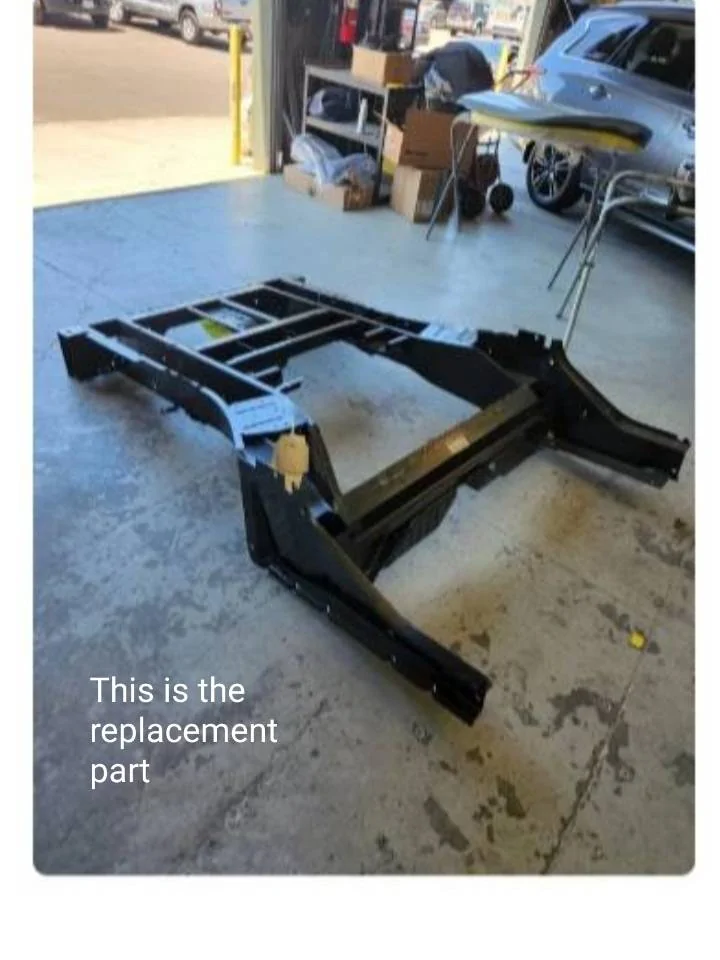

It "LOOKS" minor but the steel has been compromised.
The reason for the high estimate is that Boron Steel cannot be repaired. The whole underlying frame section must be replaced.

My feeling is the steel was already compromised when they designed it with those relief points. They are there so it folds. How much difference is it going to make?
Thinking of an empty aluminum soda can: Undamaged I could stand on it, but as soon as there is any deformation, it crumples. If they designed the "frame" without the relief points I could see how that wrinkle compromises the integrity. Design in some relief points on the soda can and it would just crumple, never supporting me standing on it.

As you stated that's part of the safety mandated crumple zone. Rest assured they are not going away. Something we all live with owning a newer vehicle. Yes me included.
