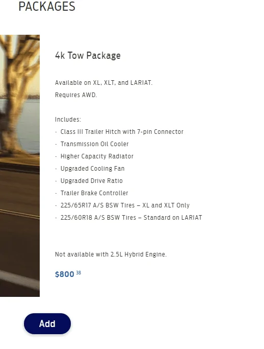

These are the differences:
Ford Maverick Is FX4 4k now considered worth it with Forscan? Captur

I understand that the major features found in the 4K and not in the FX4 are the trailer brake controller, taller axle ratio, Class III hitch (5K rating) and transmission oil cooler.
The difference in final gear ratios between all three variants (including Hybrid) is:
Hybrid = 2.91:1 (with CVT)
Ecoboost = 3.63 standard/3.81 with 4K Trailer Tow Pkg (with 8 speed)
I mention that because the axle ratio difference between the FX4 and 4K isn't that great. You would need a bit more throttle response from the FX4 to move the same sized load. That means more strain on engine and transmission.
Usually, MPG is affected by taller axle ratios yet the Ecoboost MPG for FX4 and 4K are the same. This means that the gear ratio is not significantly different or that Ford used the 4K MPG for the Ecoboost engine variants.
I believe the real drawback to towing more than 2K with the FX4 is the lack of a transmission oil cooler. That transmission can be worked mighty hard off-roading so why didn't Ford include it? I can only guess that the duration of the "work" off-roading is shorter than the "work" in towing. Also that the FX4 is really meant for "light" off-roading as well.
You also can void your warranty if you have a transmission failure if found you exceeded the max tow weight.
Also, how many utility trailers come with trailer brakes? Even the U-Haul 5x8 cargo trailer, with a weight rating of 2,900 pounds, doesn't have trailer brakes. The FX4 should be able to tow that with a transmission oil cooler added - if U-Haul would rent it to me.
I really think Ford undervalued the towing capacity of the FX4 to encourage purchase of the 4K tow package.
All that said, my plan is to get the FX4 and add a transmission oil cooler. With that addition I feel I should be able to comfortably tow 3,500 pounds - which is the Class II hitch rating. I'll take the risk...
Funny how your picture shows "Sport" as an option for drive mode even though it was left off - Part of the main point on the thread. I was hesitant to add it back on wondering if there were any potential negative effects due to the different gear ratios... Not smart enough to know if this is really an issue. Yet, this makes me feel more confident if Ford marketed a sport mode for the FX4. Now I need to find someone with FORScan around me that I can buy a few beers for to hook me up.
