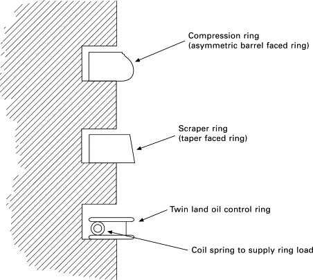

Really a variety of loads & RPMs are best for break-in of the piston rings. Avoiding lugging the engine (low RPM, high load), where oil film thickness collapses, are important for the rod & main bearings.
Rings, and especially the top ring, is the most sensitive to driving variety & styles during the first 500 miles. The goal is to preserve the shape of the ring cross section where it meets the cylinder wall, and avoid too much wear on any one part while the rings twist under load, speed, and oiling conditions (hydrodynamic to boundary type).
Best shown with a picture. That asymmetric barrel-shaped interface ideally should preserve it's shape during break-in, when surface asperities (Ra) are high, at 50 microinches or so. Everything polished down to 10 microinches, with the exception of cylinder wall honing valleys to hold cylinder wall oil, is perfect.

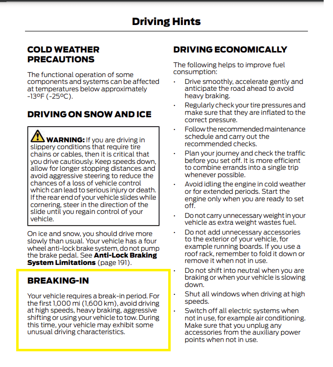

Page 273 of the owners manual outlines the break in period for the Maverick.
what is a "high speed". i am driving the hybrid from dealer for 50 miles to home on the expressway.
I got to drive a minimum of 45 mph. if not taking expressway i got to take side roads for 2 hours. Suggestion?
