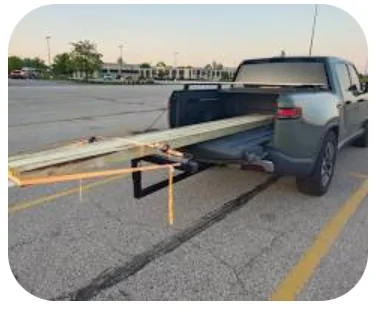

You don't have to tow anything to make it worthwhile. Use it for a bike rack or extension rack for the bed.
