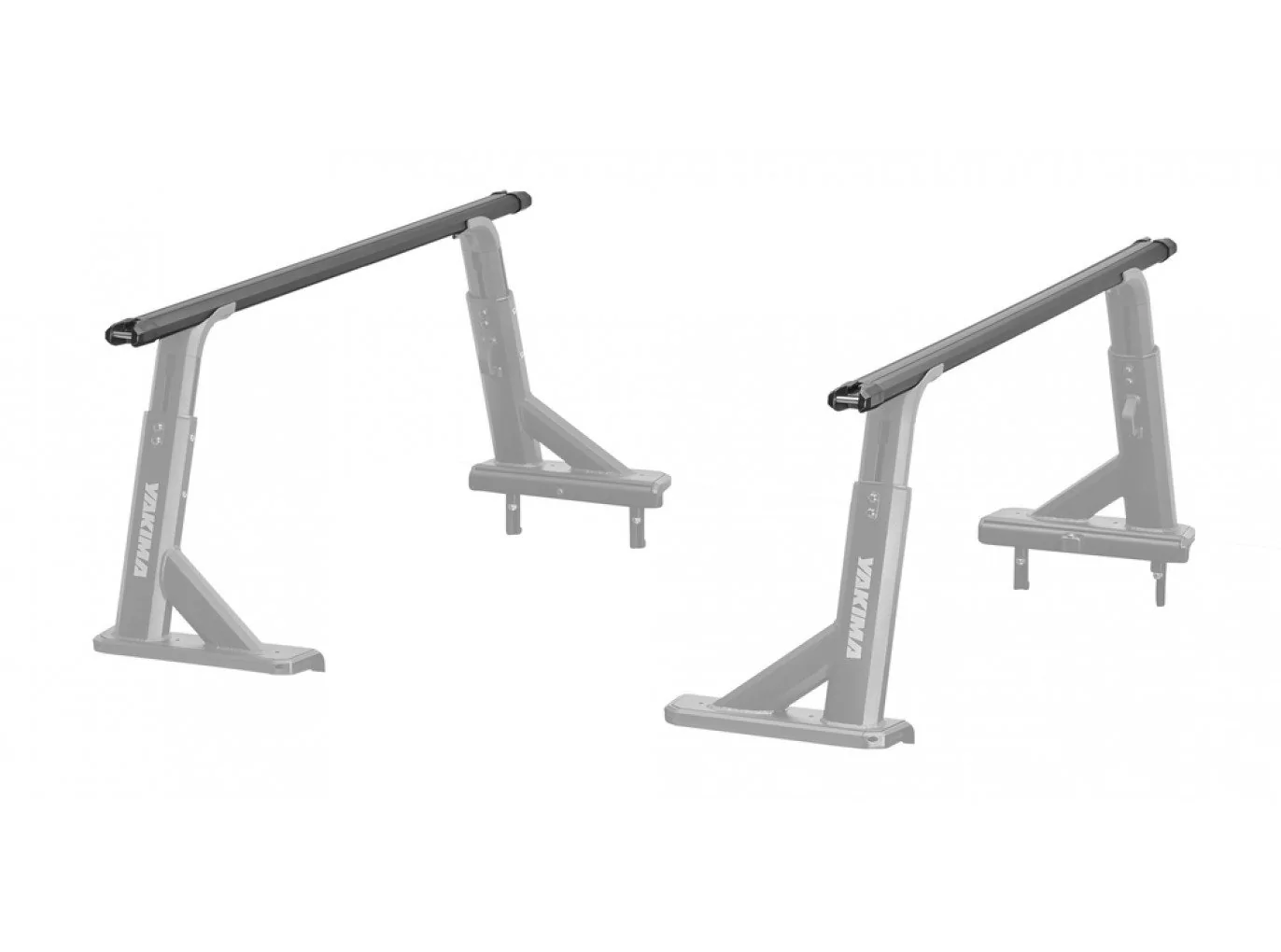

Sure.
Ford Maverick Installed 4' 6" TruXedo Pro X15 Tonneau Cover & Angry Elephant Rack System Rail size 50" yakima-8001156-hd-bar-pair-jeep-gladiator-jt-tabletop-main
If height is up and down, and length is from drivers side to passenger side, and width is front of bed to back of bed.
If the width of the crossbar is too large, then my bracket won't fit.

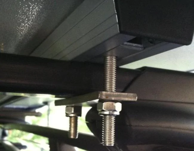

Here's how it will attach

Got it!
If your only short by a small amount(1/2in or so), I would elongate the holes in the upper and lower brackets so that bolts could be moved further apart. Otherwise, I would make or buy a set of brackets withe holes further apart.

Yeah I'm hoping it'll fit because i think those yakima kayak mounts are good for up to like 3.5". So if it's not all the way open then I'm thinking there's some wiggle room

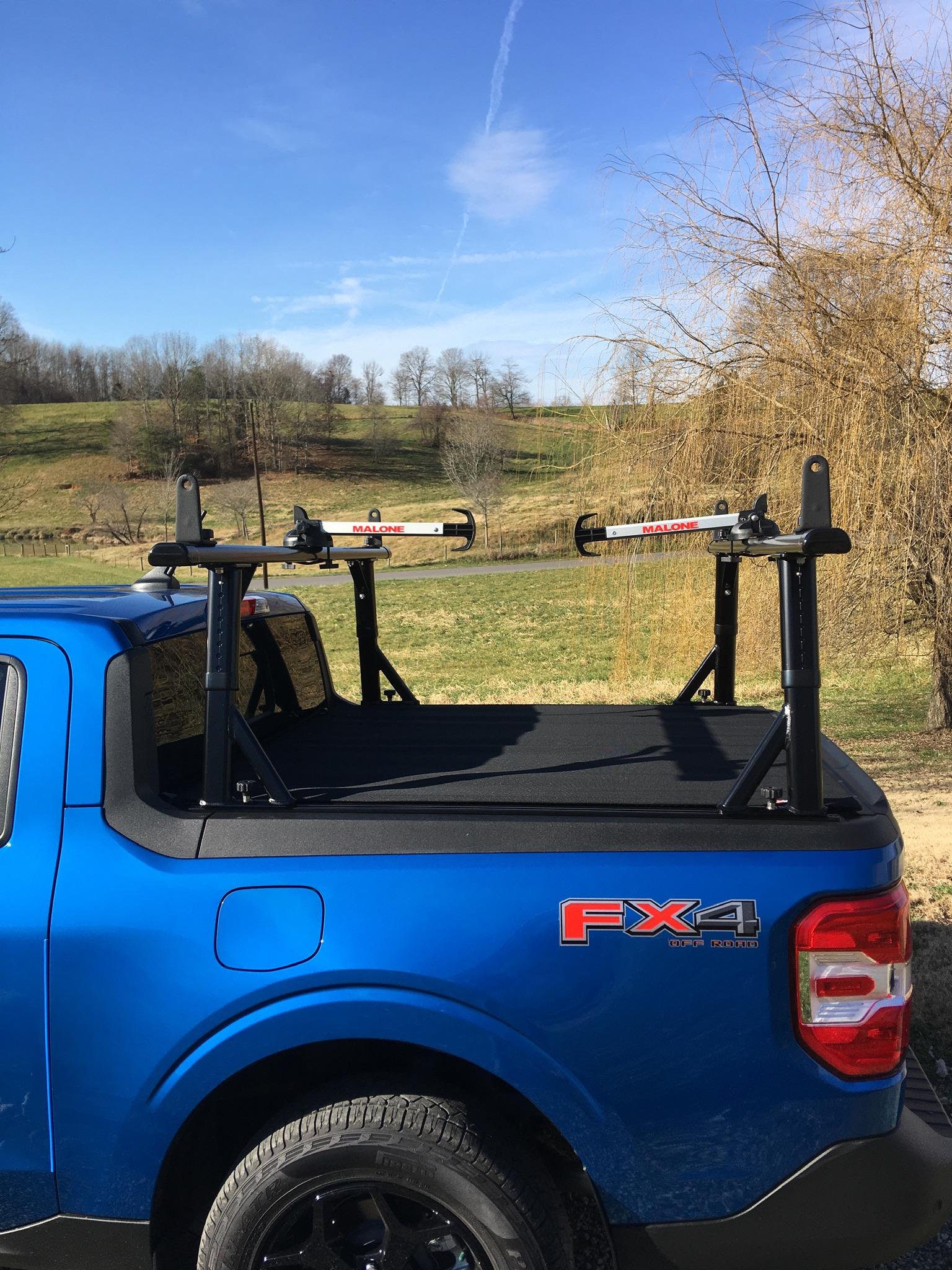

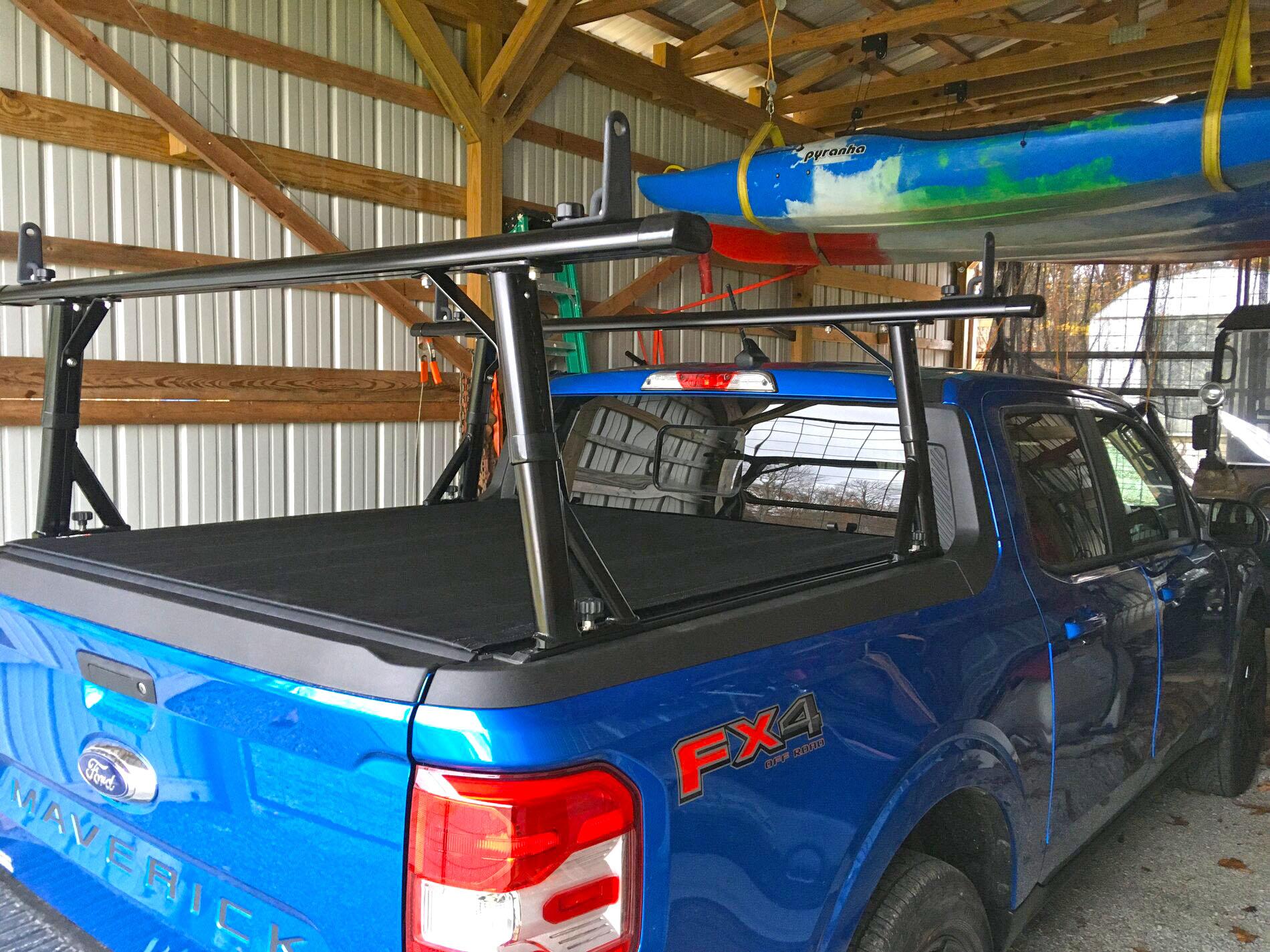

I’m betting you’ll be good to go.
I bought a set of Malone Kayak Tie Down Posts and those brackets were just wide enough for the cross bar.
Ford Maverick Installed 4' 6" TruXedo Pro X15 Tonneau Cover & Angry Elephant Rack System Rail size 50" 3705789E-AA81-43E9-84A6-DFB3BECDAE72
They fold down when not in use.
Ford Maverick Installed 4' 6" TruXedo Pro X15 Tonneau Cover & Angry Elephant Rack System Rail size 50" 82814554-FECC-458B-9413-D9FADAABD8FB

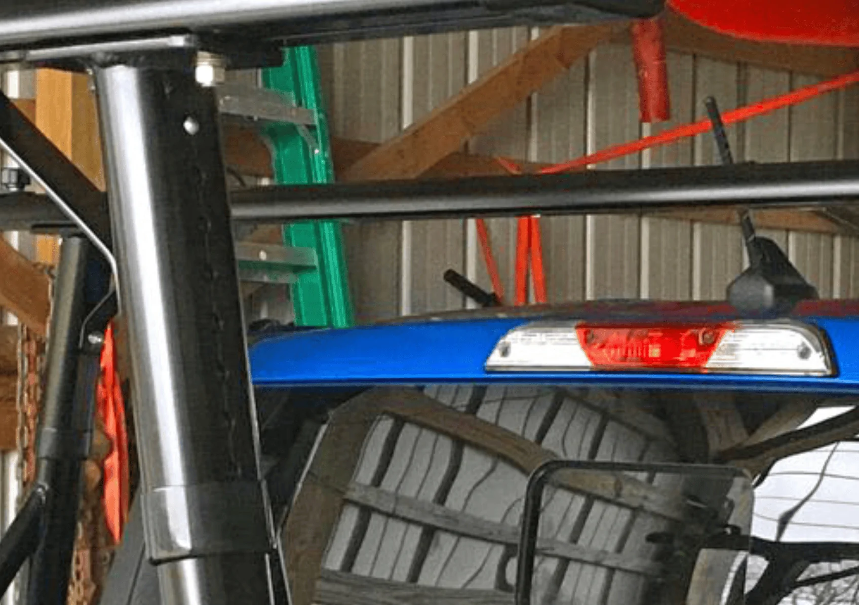

how tall do you have your rack set to?
It is in the lowest setting and will rise about 10-12”. I don’t recall what the height setting is.

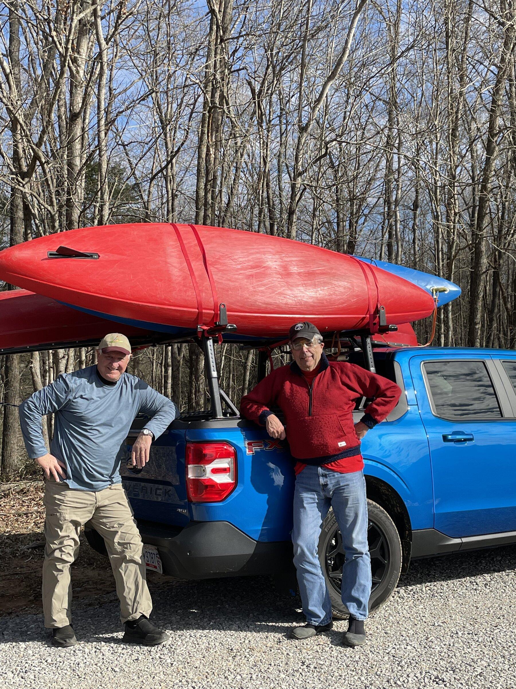

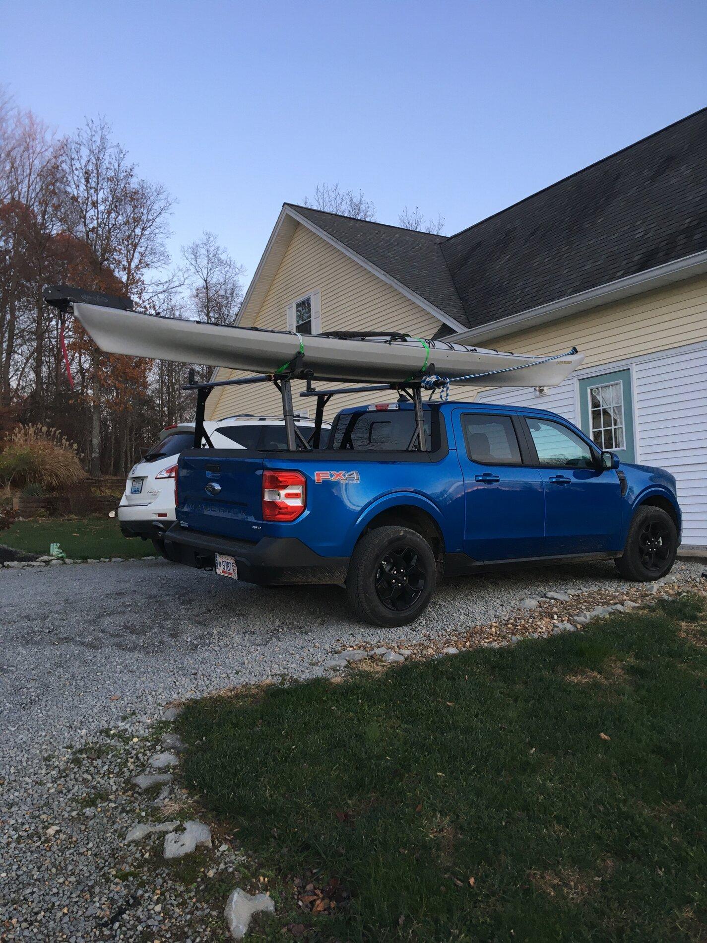

Here’s two and a canoe from a whitewater run this year.
Ford Maverick Installed 4' 6" TruXedo Pro X15 Tonneau Cover & Angry Elephant Rack System Rail size 50" 84F2F4EA-676C-47E6-A70B-AA0666FBA918

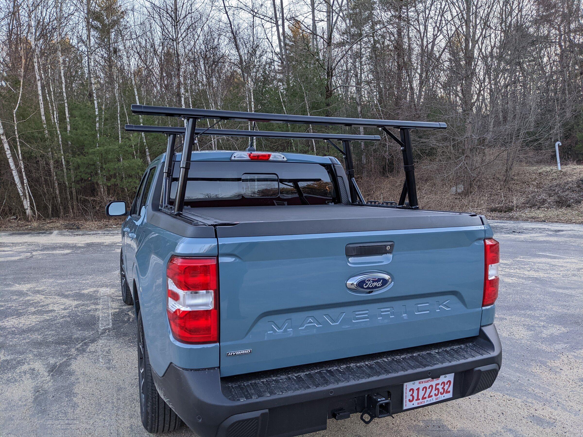

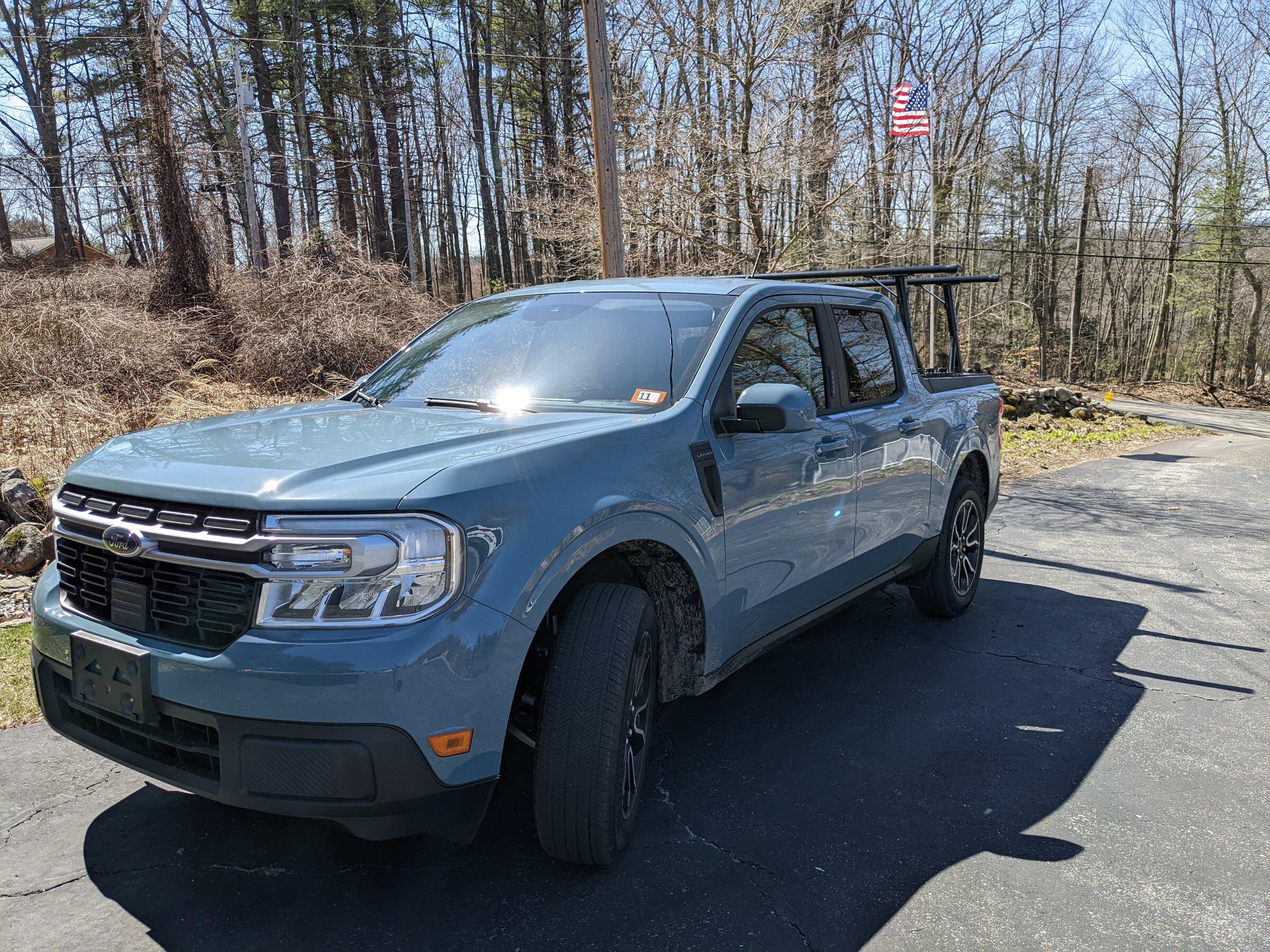

I got the Vantech rack and Elevate rails and X4 cover (package deal $1900). It all went on easily. I had to bang on the X4 brackets a little to let the cover roll down nicely without catching the little hooks on the lip. I still need to add some foam and push the whole thing around a little, but it's nice. I'll probably take the rack apart and cut the ends down so I can shorten the whole thing below the cab when I want and extend it up when I actually need it. The problem with that is you have to loosen the top rails if you want to extend them up and down because the bars are tapered. I kind of wish I had gotten the vertical bars that are not tapered (elevate brand maybe?) so you can raise and lower as you wish without undoing bolts.
I threw that last picture in so you can see how tiny the Maverick is compared to a few Tundras and a Tacoma... HA!
Ford Maverick Installed 4' 6" TruXedo Pro X15 Tonneau Cover & Angry Elephant Rack System Rail size 50" PXL_20220402_170859448.MP
Ford Maverick Installed 4' 6" TruXedo Pro X15 Tonneau Cover & Angry Elephant Rack System Rail size 50" PXL_20220402_223311990
