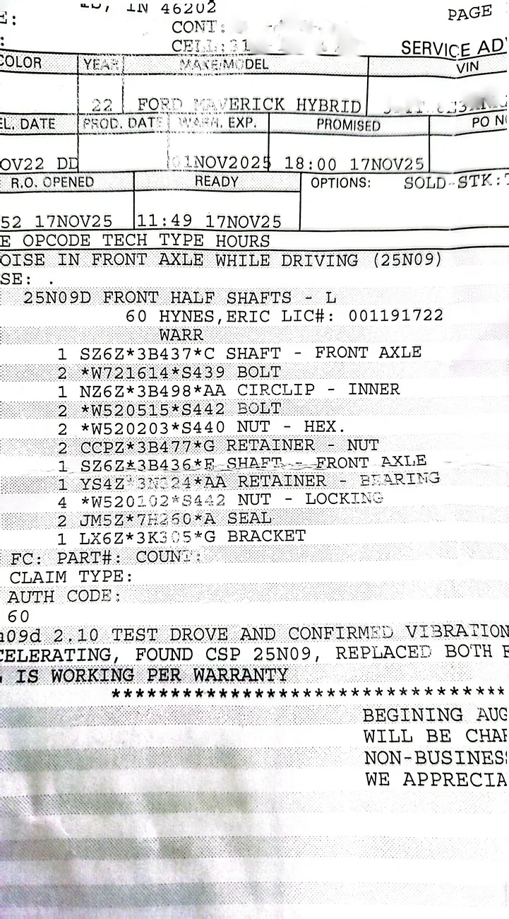

Received a call from Ford they now have the axles - I will be dropping off the Maverick on Monday to have them replaced - stay tuned. 👀
Dropped off this AM and received a call about 4 hours later to pick it up!
Parts list below:
Ford Maverick I think the cv axle bug bit me? CamScanner 11-17-2025 17.31
