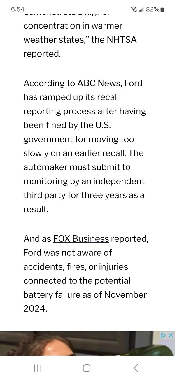

I get the feeling you work for Ford. Some facts, then I'm done. My Maverick is 15 months old. I've been to the service department 8 times. 2 dead batteries so far. This one does seem to be holding up more than a few months...LMAO! There are a minimum of 3 SSM's for 12v battery drain! No fix. 53648, 52201, 53087. The hybrid system is a copy of Toyota's successful, e-CVT system. I feel good about that. I've also had it in for trans lurching while stopped during hi idle when cold. Kept for 2 days on last visit. Reprogrammed TCM. No change. Service said don't worry you're still under warranty, drive it for awhile. Dealership has been great, I think. No solutions. Also see the attached article from, I don't know, 6 months ago.

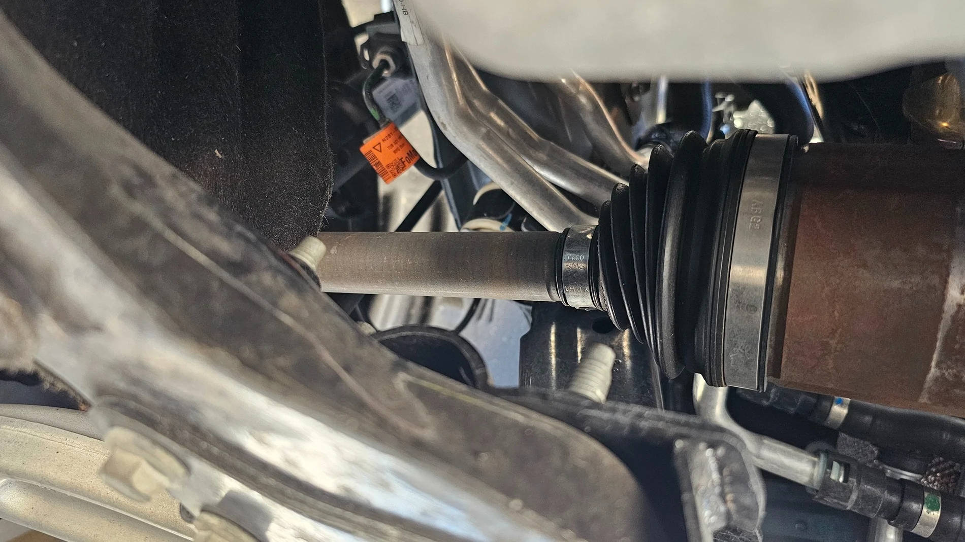

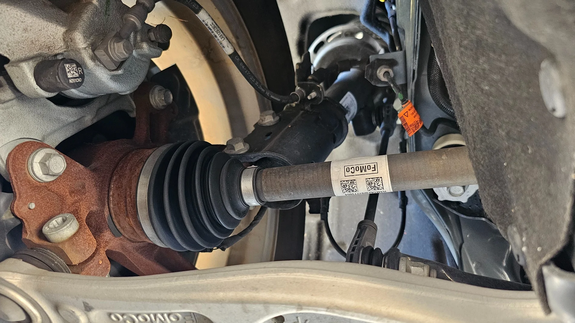

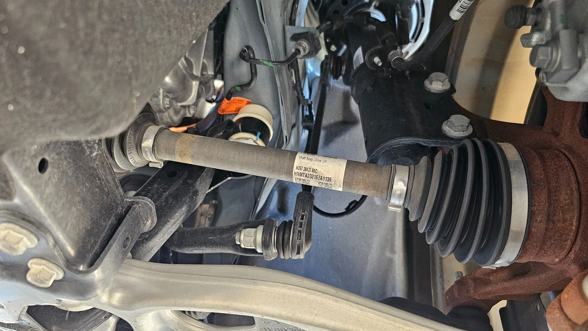

I have a 2023 Hybrid XLT. My on screen dashboard computer told me its time to change my oil. While underneath, I always inspect my CV axles. So far, things look normal. I'm just under 22,000 miles. If anything happens, it seems to happen on the Hybrids between 22,000 to 35,000 miles.

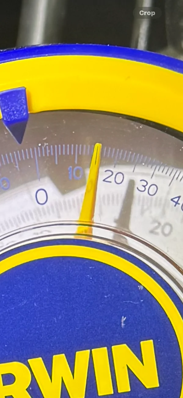

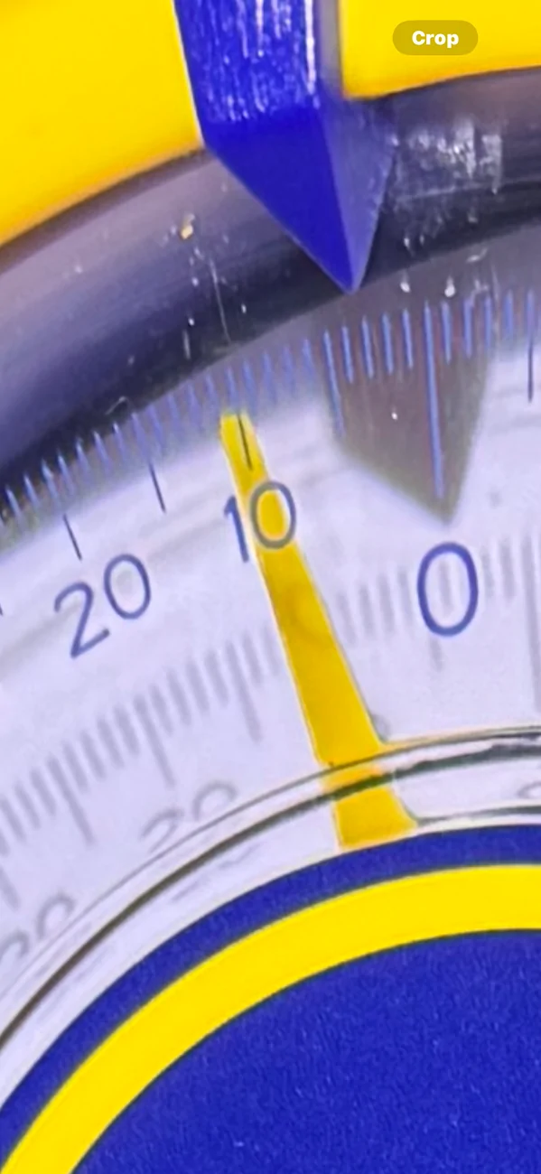

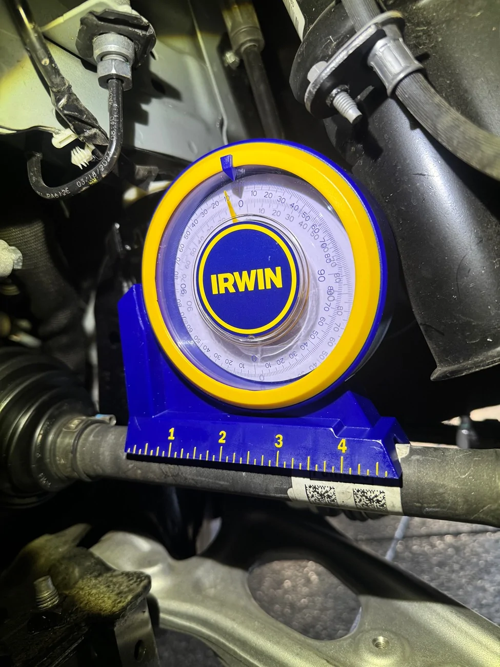

Ah, you need to do your research more thoroughly. The CV joints are already at max angles without increasing the angles with the lift pucks. I agree that its a bad design allowing a vehicle to be built from components stretched to the outer limits of compatibility, but here we are. The 8-speed transmission is similarly maxed-out too.
Not sure where you’re getting your misinformation from, but the cv joints are not at max angle on the Maverick. Max safe angle is 30 degrees. Bronco raptor sits at 18 degrees, stock. F-150 raptor is 22 degrees.
My fx4 Mav with 2” spacer lift sits at 11 degrees on left and 15 degrees on right.
So I’ll say that again: A lifted Maverick has lower CV angles than a stock Bronco or F150 raptor.
As many others have said; the 2022 version of the maverick cv joint is defective. That is why Ford engineered a new CV design for the newer model year mavericks. That is also why ford put out a repair bulletin to repair maverick CV’s that are otherwise out of warranty. Because a Ford knows the original maverick cv design was defective.
