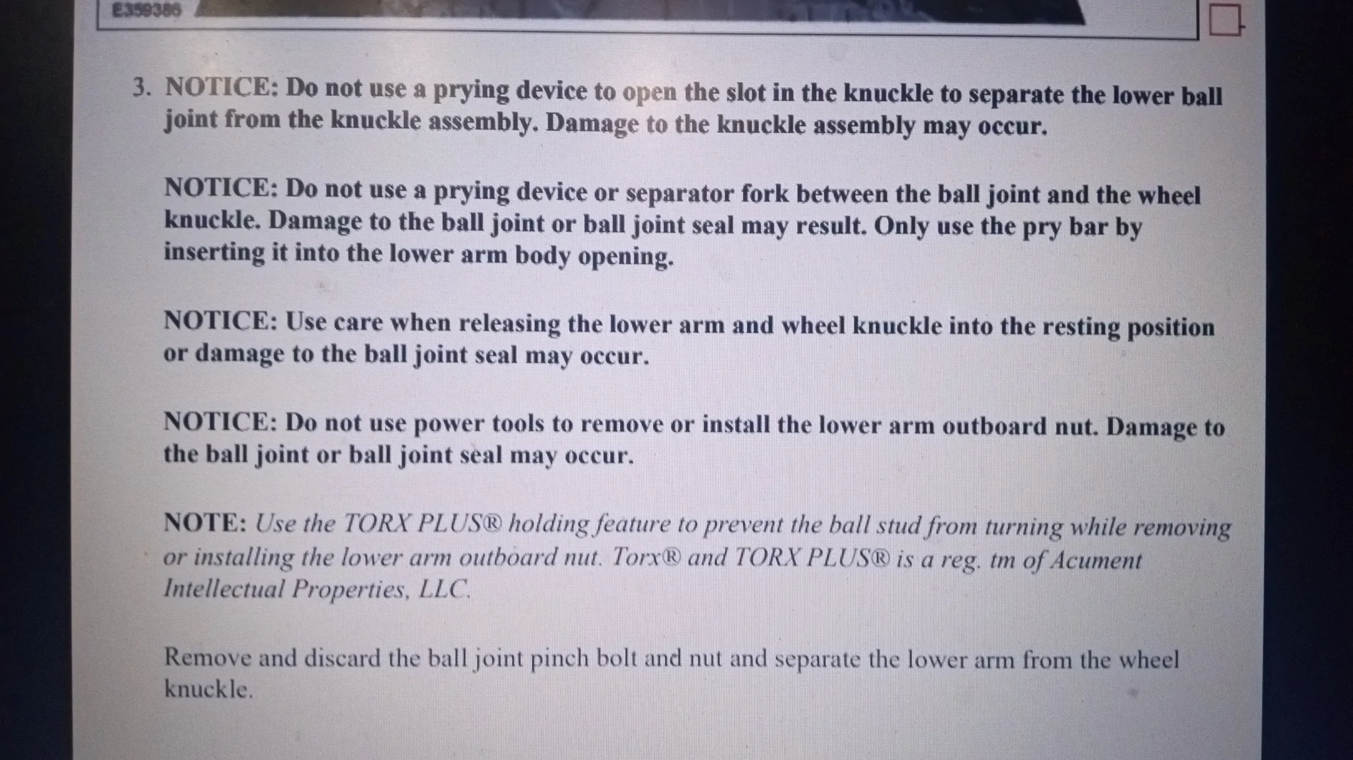

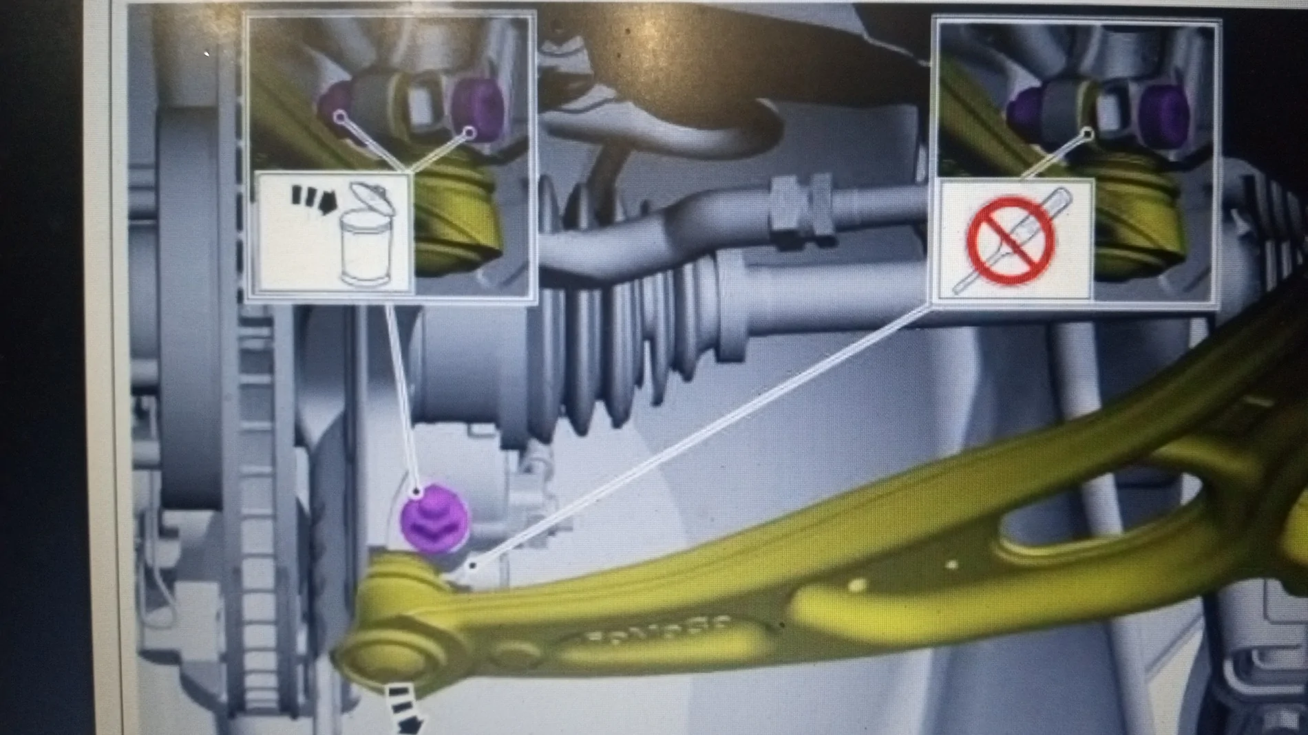

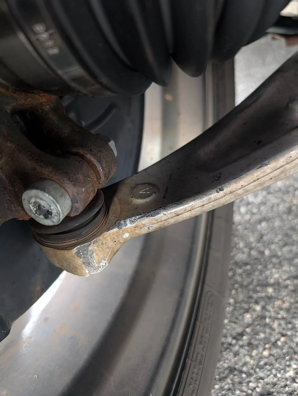

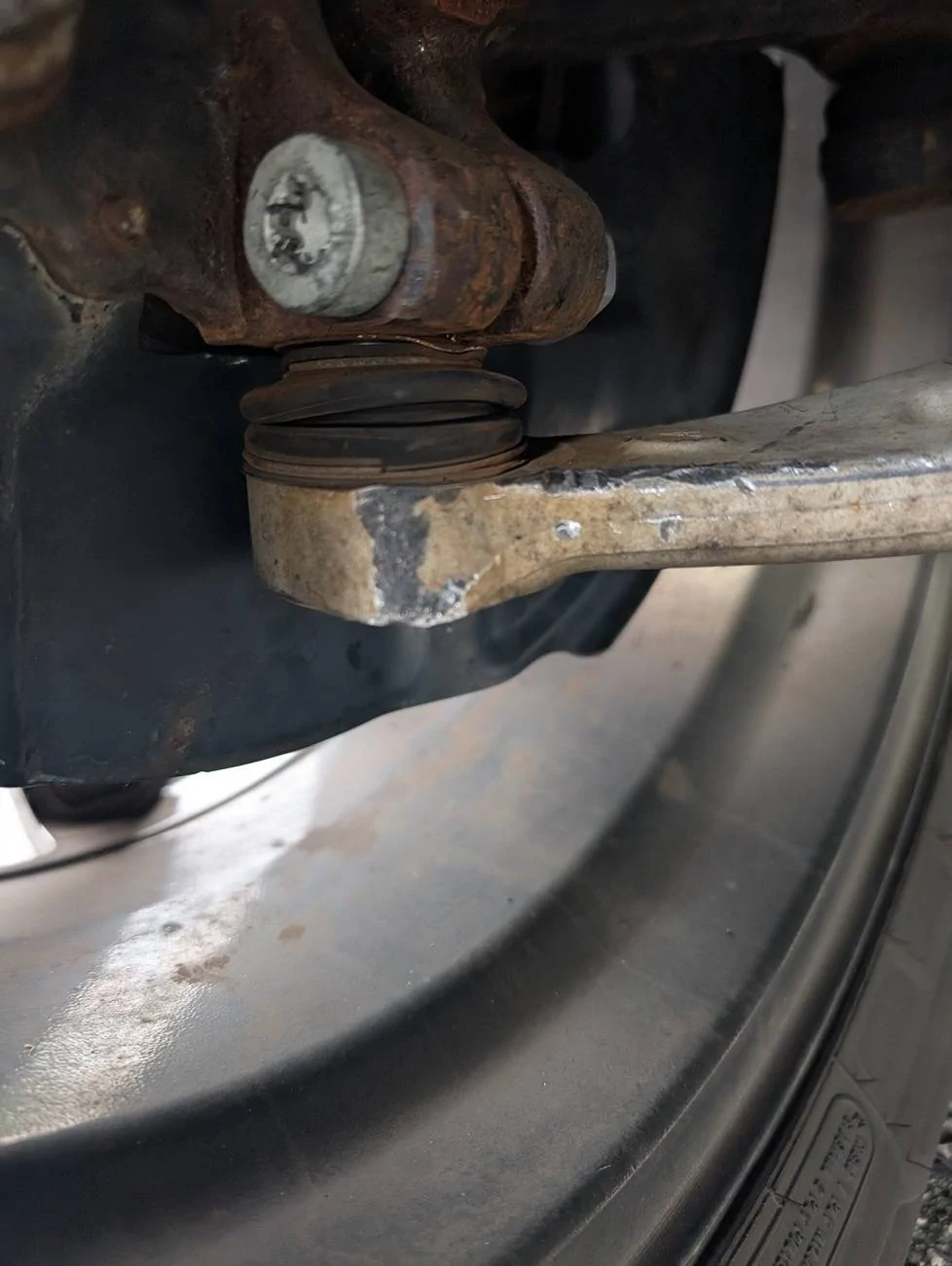

Let me guess. The Ford dealership you went to does it supply their technicians with service manuals. LOL The lower arm in most cases dose not need a special tool to release it. That type of joint has been used in some ford trucks for years.
