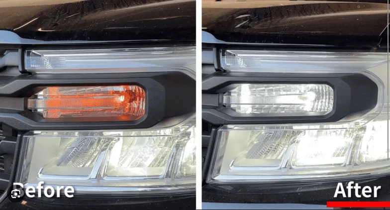

My Maverick I just took to the dealer to get it fixed as well. But same exact thing is happening to mine. I have the nicer front switch backs. But basically everything is redone. What’s funny and weird. If you put on the hazard lights they blink normal speed.

Hi all,
So, the recall will affect the old version of front 4257 Lasfit (even though the recall is for the rear lights outage notification)? Also some of you have had the new T3 4257 Lasfit and the recall did not affect anything?
so you have the upgraded 4257 T3 and no issues?
IceyBiah
Icey
Jan 9, 2024
Kalispell
2023 Ford Maverick Xl
I did not upgrade yet. I thought I read T3 wasn't hyperflashing after recall, but I misread post #28.
Ohhh okay, I have those front lights the 4257 T3, and after the recall I also have the same issue as everyone else.
