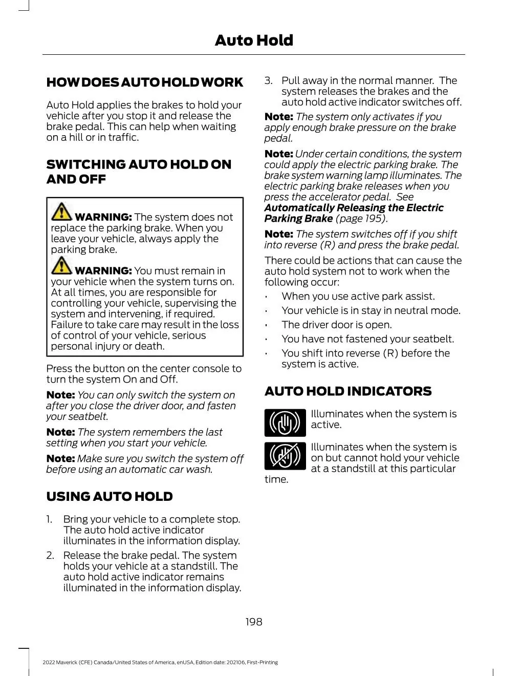

Regarding creep at a complete stop: I am assuming there will be creep because the little button on the center console that has the "hand" symbol (the one that many reviewer don't know what it's for) is to hold the vehicle stopped with the driver's foot off the brake.
It's in the manual.
mamboman777
Josh
Aug 3, 2021
111
3,476
11,813
NRH, TX
It's in the manual.
That doesn't necessarily mean that there's creep. This could be for holding the car from moving backwards if on an incline.

Well, yes and no....
Ford Maverick Hybrid Transmission Question hld_1
