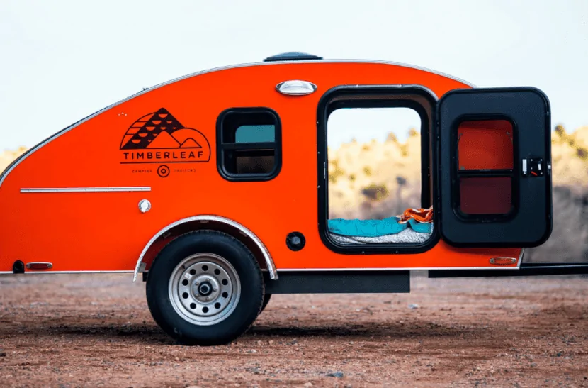

I was also interested in options and bounced around some ideas before stumbling onto teardrop campers. You can pretty easily build/buy one under 2000 pounds loaded up, it is a dry elevated place to sleep and has all your cooking/cleaning needs out back.
People get fancier with them going larger, adding toilets and running water, TVs, solar panels, camping fridges etc.
