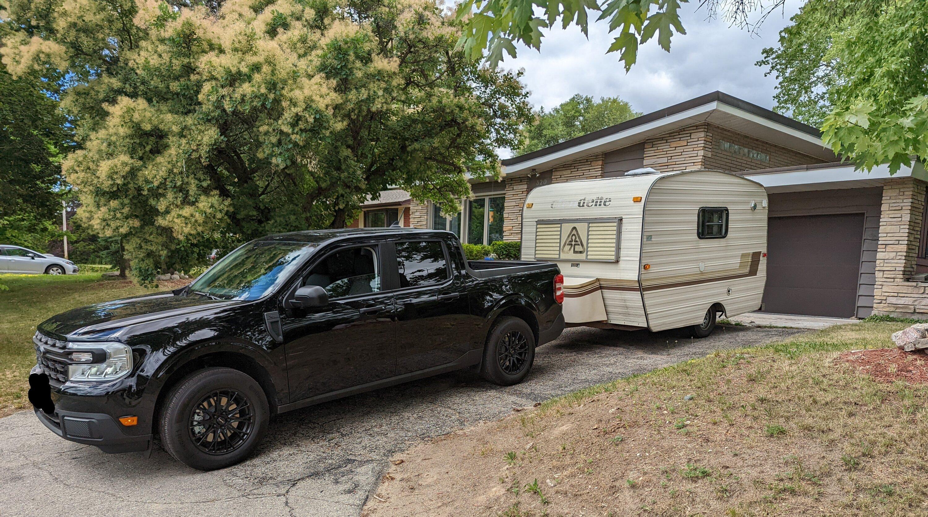

XL hybrid with factory hitch. 7 to 4 pin connector. 1860 lb trailer. Just girlfriend and I, we pack light. Am I pushing it? Personally, I think not. Just towed it home.

Frontal area not as bad as most people think. This compact trailer is just over 6 feet wide, the factory mirrors were fine. The height sticking up above the cab, not too great and rounded.
Was able to test drive a friend's while I shop around for what to consider buying. I would keep it 60 MPH and under with something like this.
