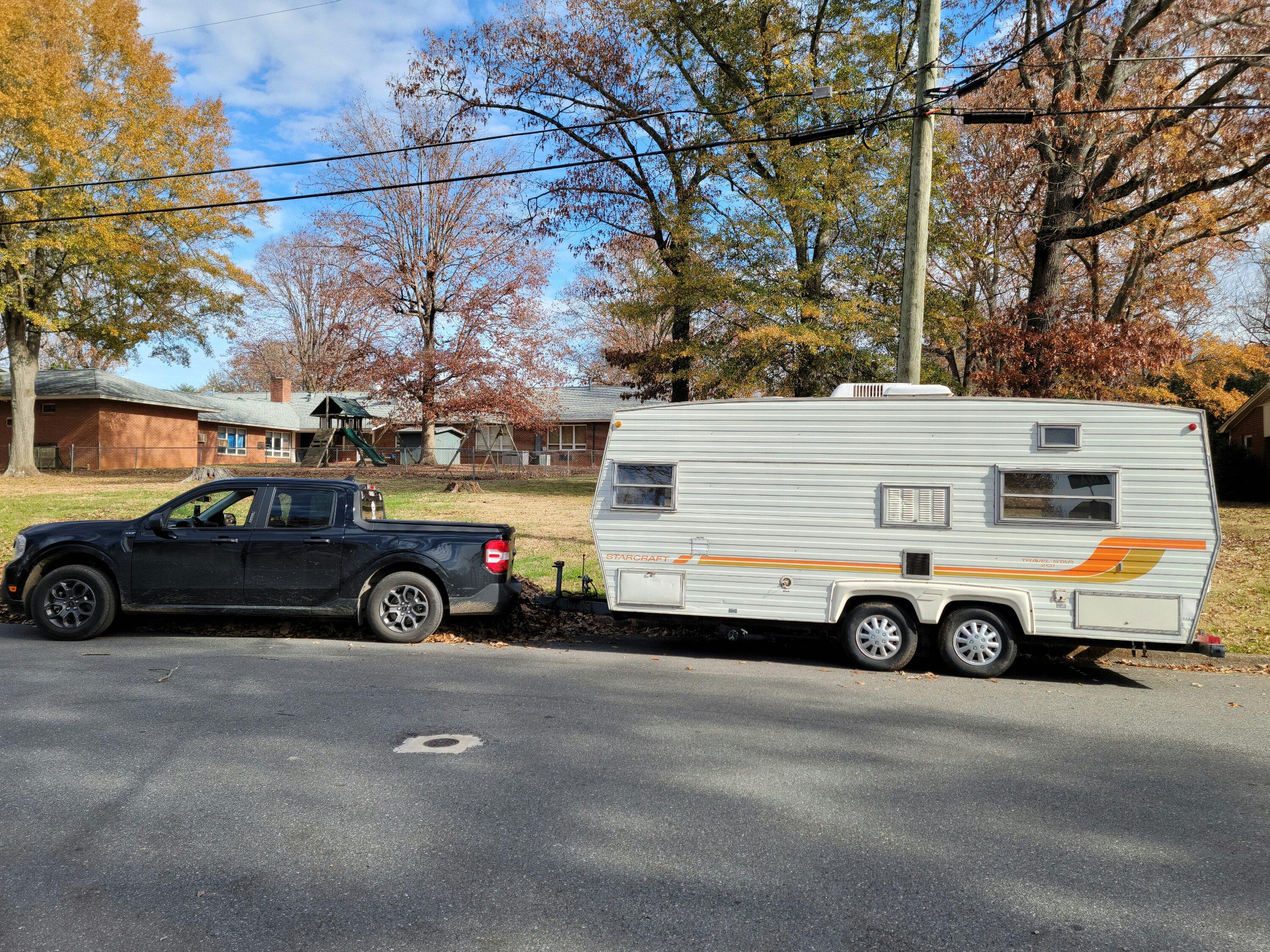

My, setup. Towed over 1000 miles, I wouldn't recommend any larger of a trailer for the frontal and cross winds. I weighed in at a CAT scale to check the weight of the trailer and combined. The trailer weighed 3580, the total combine weight was 75??. I pulled the entire trip at 65 getting 15mpg+/-. Also, for a good 60 mile stretch had a 25-35 mph cross wind. I wouldn't hesitate to pull far more weight if need, but you definitely could feel the wind and trucks passing. Not getting push around they just let me know they were there. Since towing that I have put more than 3500 additional miles on mine with no hiccups. I would like to add a roof top wind deflector to get the aero a little better. To each their own, follow the manufacturers recommendations, or not. The important thing is if you go out of those recommendations you as the driver hold all of the responsibilities if anything happens. Also, for them to deny the warranty you would have to give them the information, for me they would simply have to ask the right questions to get the answers the would need, but I have less than 12000 miles left on my warranty so not really a big deal for me.

Someone else already mentioned this - but
I'm not sure why anyone thinks this is an issue. The truck is rated to tow 2,000 lbs. The trailer weighs less than that. 1860 the original post said. A later post says scales showed lighter still.
It is a fine, within spec set up. Enjoy your trip and camping.

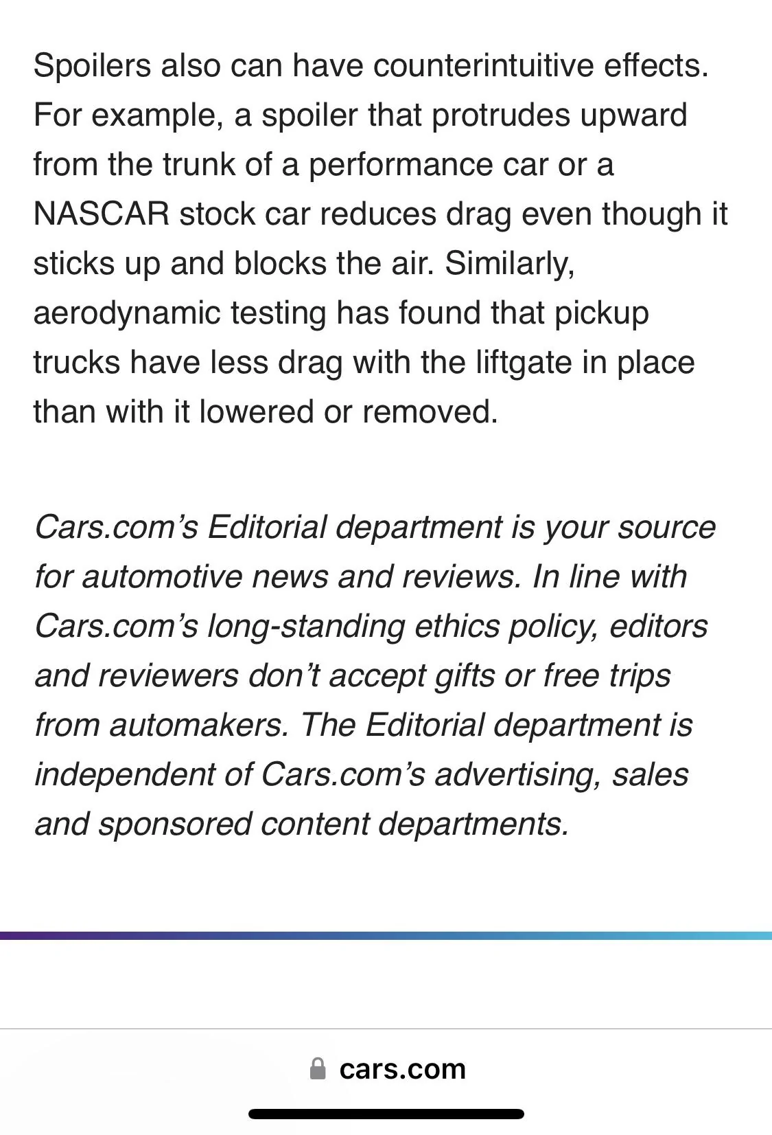

You're more describing streamlining than spoiling
Not all Spoilers are meant to "block" the air.... not meant to make a wind "shadow". They are meant to literally "spoil"' the air. Turbulent air has less resistance than "calm"'air, believe it or not. There's drafting gains to be had 100 feet behind a semi. Tested and true.
Ford Maverick Hybrid towing 1860 lb vintage camper 6E775E77-488E-4429-9ED4-5C9BEA9E8B54
See also golf ball dimples. See also competitive swim suits- they used to be smooth and now they are rough and textured. And before that swimmers shaved and oiled their bare skin. Texture is less draggy than smooth.
