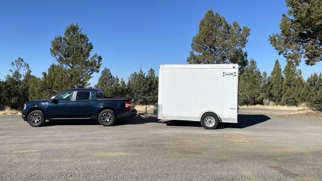

Many
Nope, not how that works at all.
Well I know FOR SURE this works and works really well.
I'm not going try 80 MPH but at 60 MPH it's a very comfortable tow.
Good luck with a warranty claim if they bring it to the dealer with that trailer attached.
