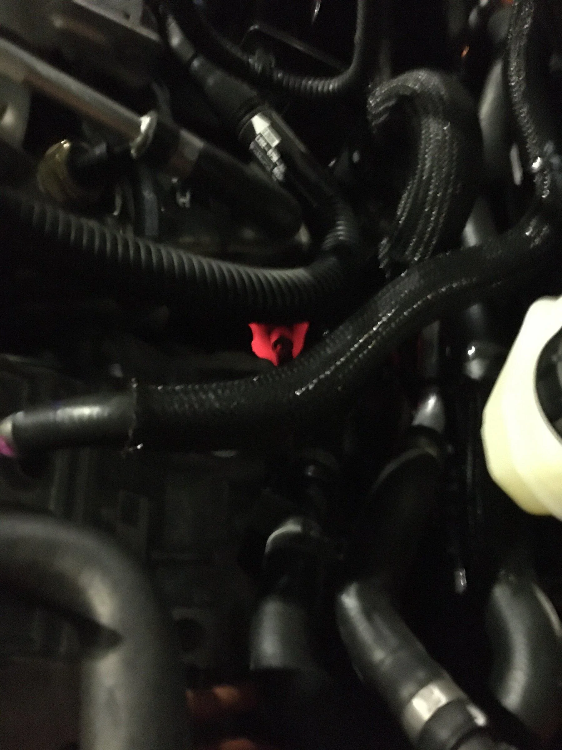

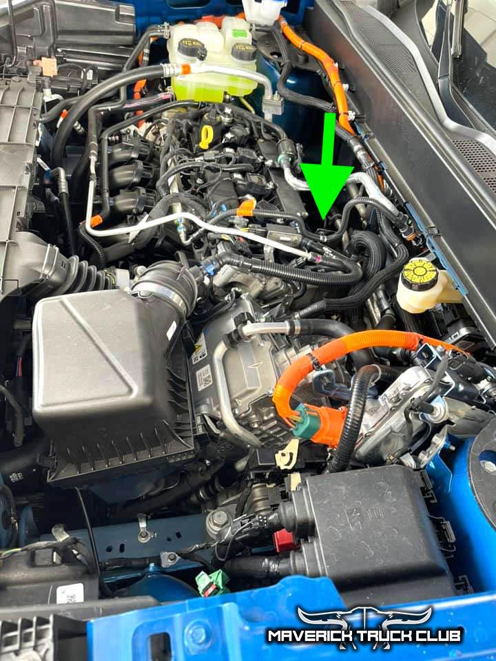

BREAKING NEWS:
I am having this EXACT issue using both FordPass and the key.
I suggest the moderator combine this thread with: https://www.mavericktruckclub.com/f...pass-hybrid-maverick.7155/page-12#post-192290
I also have excellent video of it occurring.
It's affected by ambient temperature (every time it happened it was about 10 degrees F), and it's affected by the load being asked by the climate controls. In other words, if you turn the heat up, the surging will kick it-- or at least that's how it's been on my "truck".
And yes, my cat got molten red hot the first time it happened. It happened multiple times before I started smelling the eggs in addition to the burning plastic smell. The burning plastic smell was there right away. I'm fairly certain that cat is shot. And I'm fairly certain that if I had left my vehicle unattended the first time it occurred it would have caught fire. The cat/exhaust/manifold thingy (no, I'm not sure I've seen a cat in the engine compartment, but that's what it looks like Ford did) was glowing so brightly, it lit up the the back of the engine near the firewall. Like iron pulled from a forge. I haven't let it get that red hot since then. But read on!!
I replicated/induced the phenomenon again and took a shot of it JUST as it was starting to glow. Enjoy the videos too. High drama. The second video is 14 minutes long, broken up into two parts, but I promise you it's riveting. Oh, and when I said "evaporation" in the video I probably meant condensation. The billowing, wet exhaust might be a part of this issue too.
I drove this car home with 30 some odd miles on the odometer about a week and a half ago. Four days later it did this for the first time (that's the first video). I brought it to Ford on Friday; they couldn't replicate it. I came by on Friday night to pick up the car and then it happened again. I called the service dept on Saturday morning to explain the situation, but there wasn't a diagnostic technician in on Saturday; it would have to wait til today. I came back on Sunday to document it, and that's what you're seeing in the last two vids. I sent them detailed information about how I was able to induce it. I spoke to the service manager at 8am today and was told I'd hear back. I didn't hear back today.
I have sent multiple emails to the service department detailing what has been happening and I wrote a similar email to the dealer I purchased the vehicle from. The service manager at my local Ford dealer didn't seem interested in assuaging my concerns-- it would have been nice to get a little reassurance. She's been professional enough though, in my opinion.
I hoping and waiting for them to diagnosis it, but I'd bet you a brand new 2022 Ford Maverick XL Hybrid that my catalytic converter and a couple of ancillary components are toast. Did the car come from the factory with bad valve stems? Bad piston rings? Is there fuel dump because of a computer issue? Is it a purely mechanical issue? Either way, this is my first new car, and 4 days into owning it, it seems like it could very well have burned to the ground. I don't mean to sound dramatic-- I happen to really believe that.
My friends, DO NOT ignore this issue. If you're having surging engine issues, personally, I'd brick your car. I bricked mine after I realized the cat was probably incinerating itself. I would expect your cat is getting superheated too, especially those of you who are smelling eggs in addition to burning plastic.
Let's make sure we protect our investments and share as much intel as we can with one another. I want to trust that Ford will do right by us, but it can't hurt to be organized.
-Daniel
