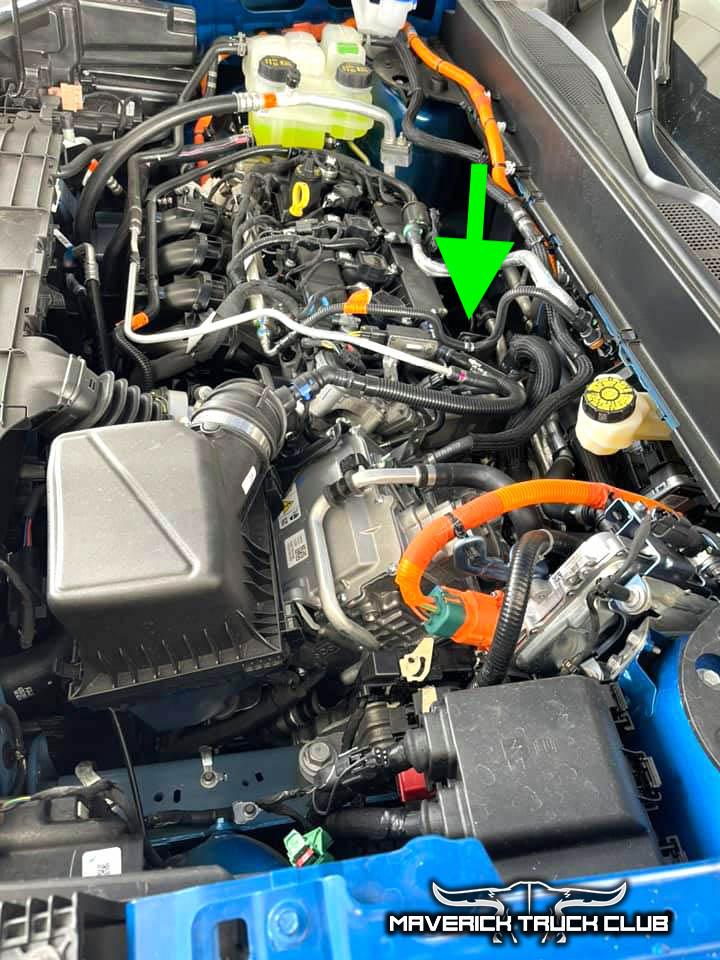

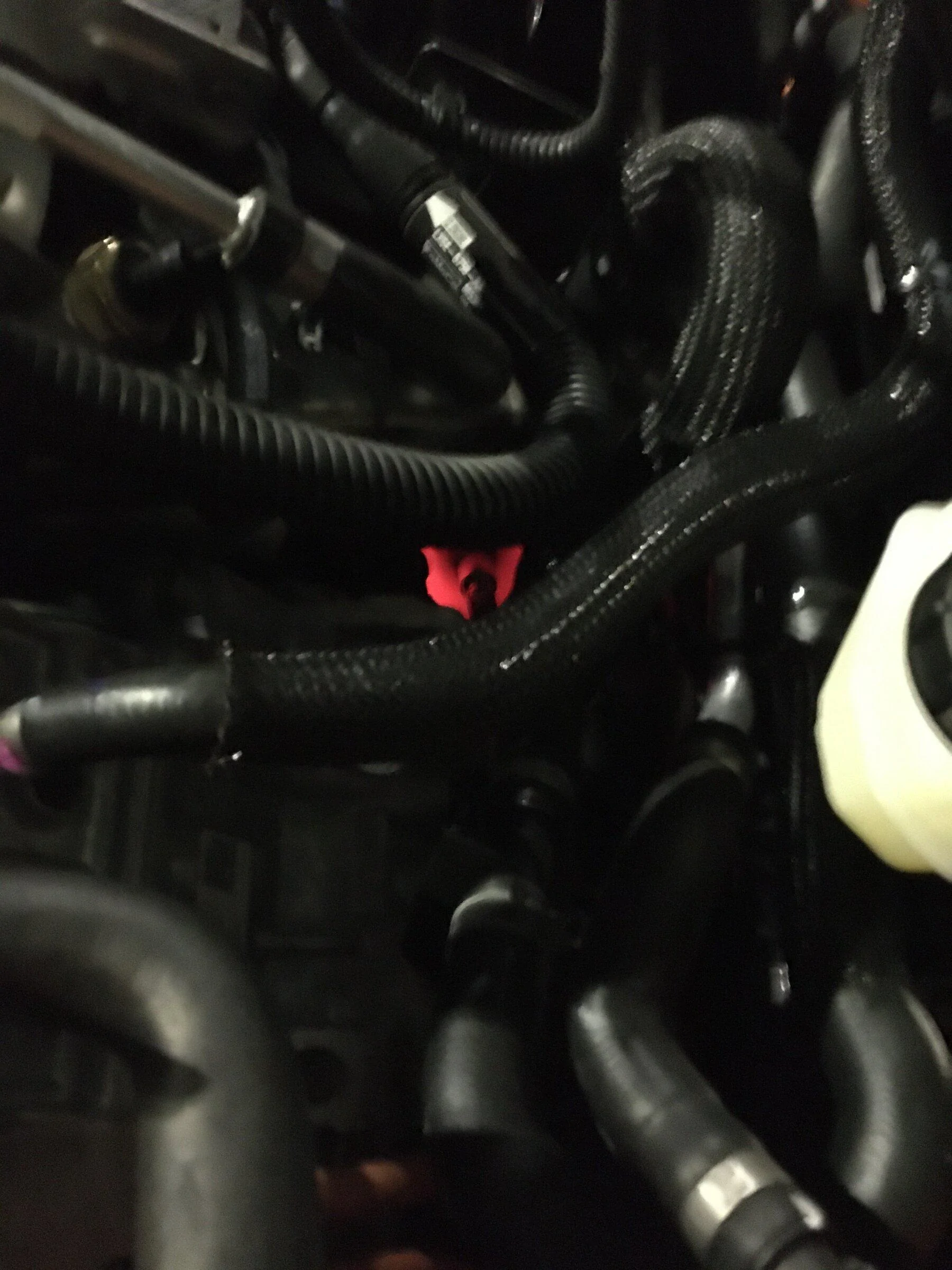

Tagging @FordMotorCompany This seems to be a systemic issue in cold weather and needs to be addressed. Your videos really should be enough to start the conversation at Ford to try to get this resolved for all.
Also curious what @fordvideoguy thinks? Can you address this on tonight's stream?
