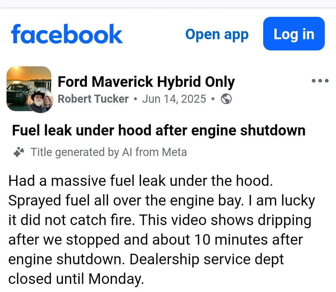

I don't have a Facebook account..but.
This is what pulled up when I googled fuel line leaks in Maverick hybrids. This was from last year so it is a thing.
What will it take before we get a new fuel line???

I'm not on Facebook.
Okay, Glen...that freaks me out to see the fuel leaking like that!
Edit to remove my mistaken belief that it was Glen's Mav leaking fuel!
I am glad it wasn't his truck!

The posting is just something I saw on Facebook it's nothing related with MY truck.
I posted it to illustrate that it's happened before.
Oh, phew! I was worried there. Thanks for sorting me out that it wasn't your truck.
I will need to go do some editing...

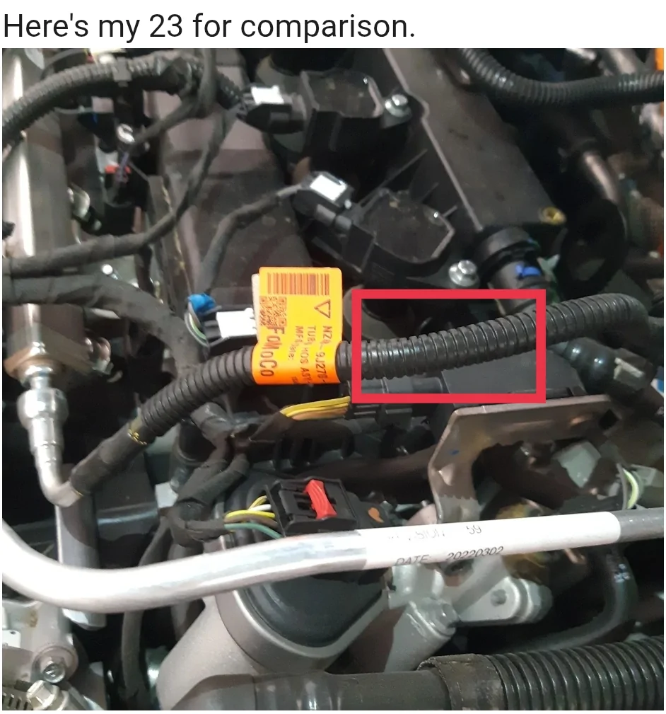

We live in an age where consumers can immediately take pictures of their products and compare them.
Here's the OP'S LEAKING FUEL LINE.

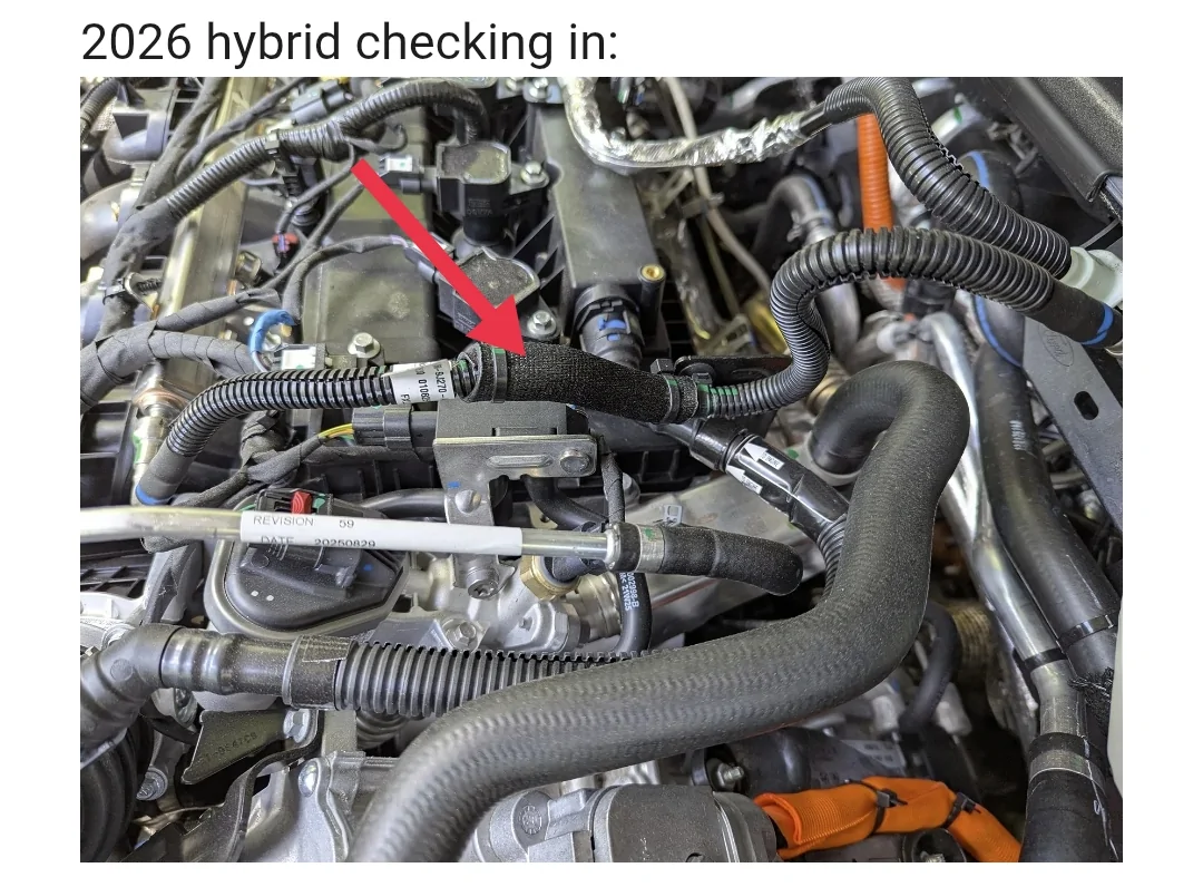

Ford Updated The Fuel Line 25-26

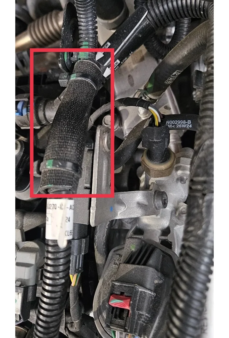

Here's the same area on the fuel line but it's been further insulated on the 2025 / 2026 Along with green factory verification marks
Obviously Ford must have detected or was inform of a problem.
SafetyGuy's 2025

El Kobong's
Ford Maverick HYBRID ONLY Fuel line issue IMG_20260531_180413
It seems Ford knows of a potential problem. Hence the redesign fuel line on @SafetyGuy 's 2025 and @El Kabong 2026
I doubt it involved a 🐀 rodent, otherwise why did Ford add insulation to that particular area?

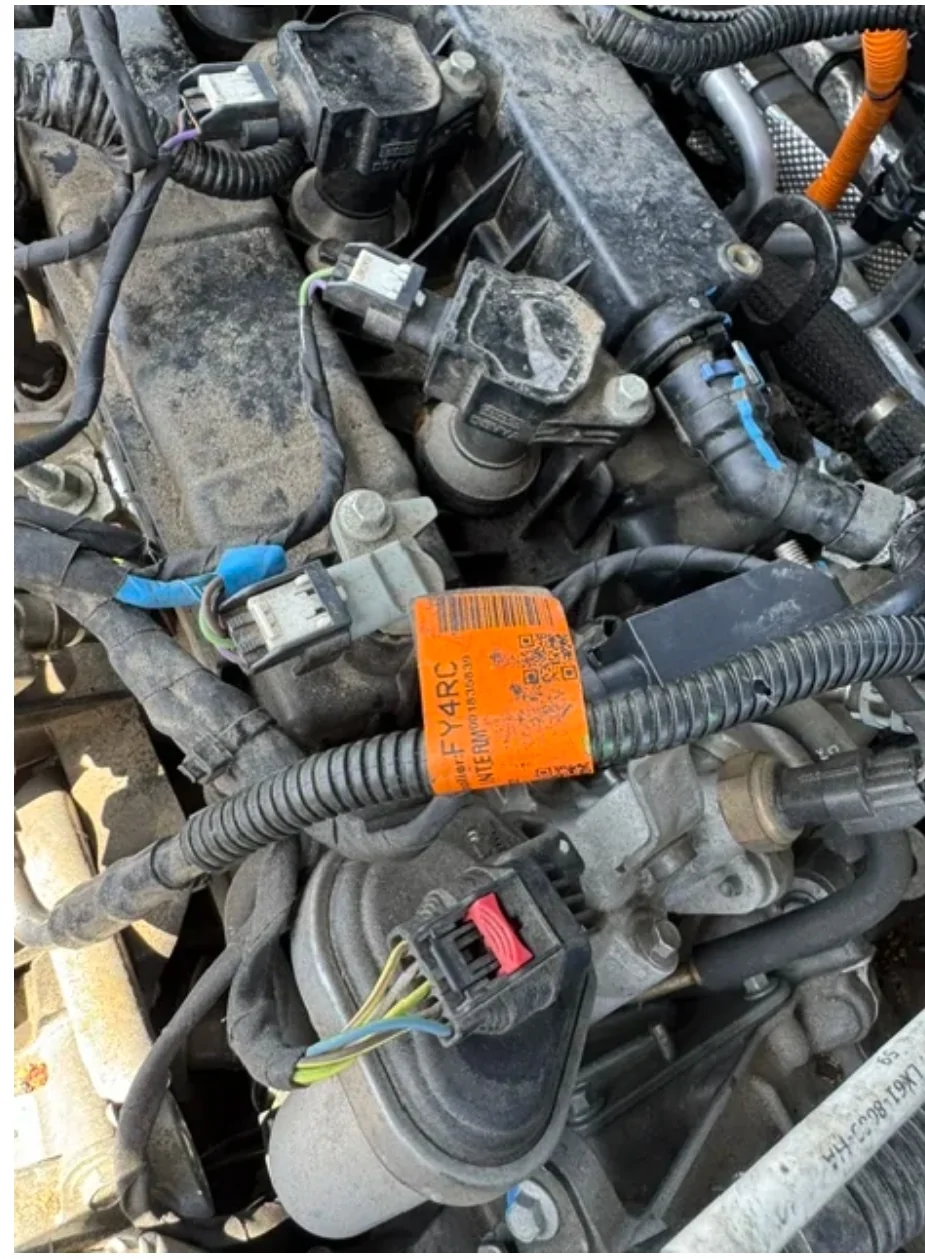

One thing to know is that the 5-digit "FY4RC" code on the tag is the supplier site code. I checked my '25 and it is FXL6E. Obviously a new part number, too.
It seems like there was a redesign of the fuel line and a new supplier (or same supplier, new site) was chosen. I wonder if the new part is backwards compatible? It could be that there were some supplier quality issues that factored into this decision. It's hard to say but this does happen sometimes.
