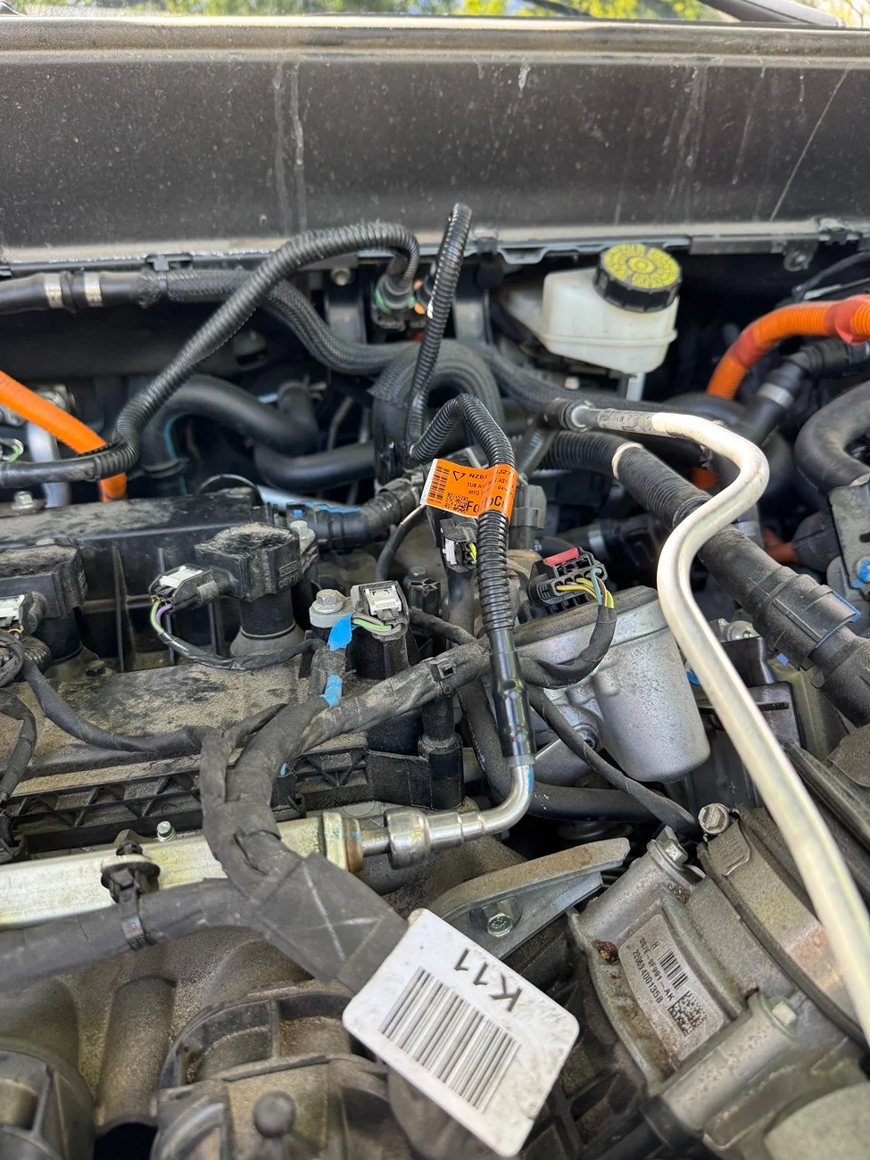

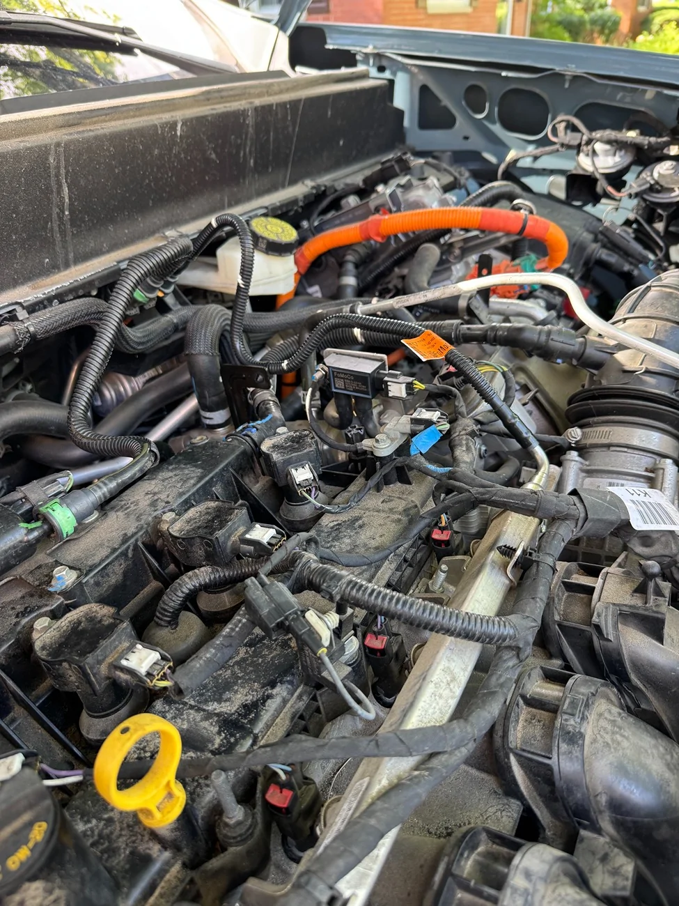

Ok Guys, the truck is back with a new fuel line. I didn't want to post anything online while my truck was at the dealership. This was a warranty claim, and I had a tow and a loaner that I didn't want to be denied. The new fuel line looks alot like the original line. The only thing that looks different is, the bend at the firewall looks like it is higher over the EGR sensor than the old one. I have studied the pics everyone has posted (thank you members!) and it seems like the line was running close to that EGR sensor bracket. That is raw metal, and the line looks close to it. That is also where they added extra insulation on the 25-26.
BTW the crack in the line was about an inch more toward the firewall than the hole in the insulating cover. I really wanted to tell you guys that, but I didn't want to mess up my warranty claim.
I have some fresh pics of the new fuel line. Spoiler alert, no added insulation. I may add my own on this line soon.
P.S. this whole thing cost me $100 deductable (extended warranty) and the tow is still being scrutinized. They (Ford) say they will only cover $100 for the tow. My tow cost me $205 because I had a third party company tow it. I asked the dealer if they had a tow service whan I originally called, and was told no. Therefore I used a third party. When I picked the truck up, I asked about re-imbursement and he said they (the dealer) would not re-imburse for a third party, and I would have to go through Ford. He gave me a number to call, and I am in the process of getting my money back.
Here are the pics.

thank you for the update

Good day
Good job, you have had the repair carried out successfully. And that new line is definitely clear of anything rhat may come in contact!
