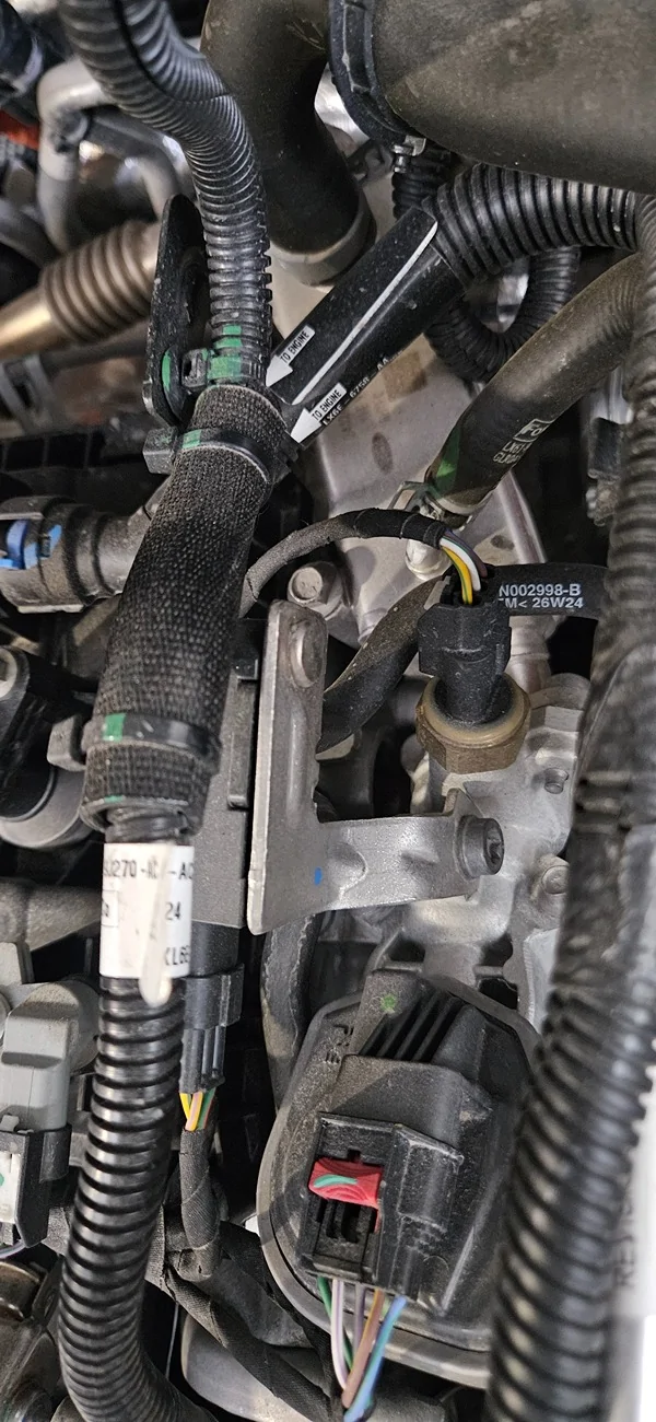

So I went out to look under my 2025 Hybrids hood, again.
At the point where you only have the thin plastic sleeve, I have a thick synthetic material protective sleeve...)my line tag isn't orange, it is white).
Ford Maverick HYBRID ONLY Fuel line issue 20260531_094057
A change made as Ford may have found the area needed more protection?
This makes me go Hmmmmm, some more.
The synthetic piece is zip tied on OVER the thin plastic shielding (the belt and suspenders method) so I wonder what is going on and why mine is extra shielded, and earlier trucks are not....maybe there should be a recall for the extra protection to be added if this was the fuel line damage and leakage area?
Again, I say hmmmm....

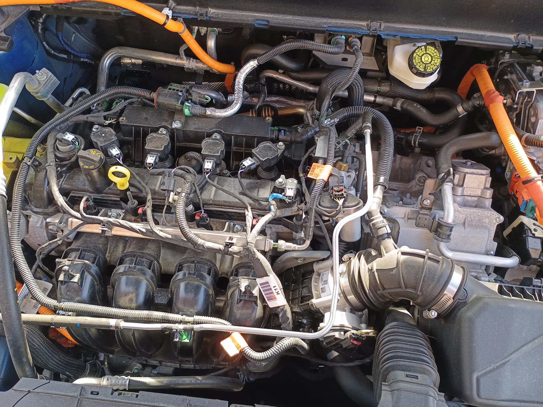

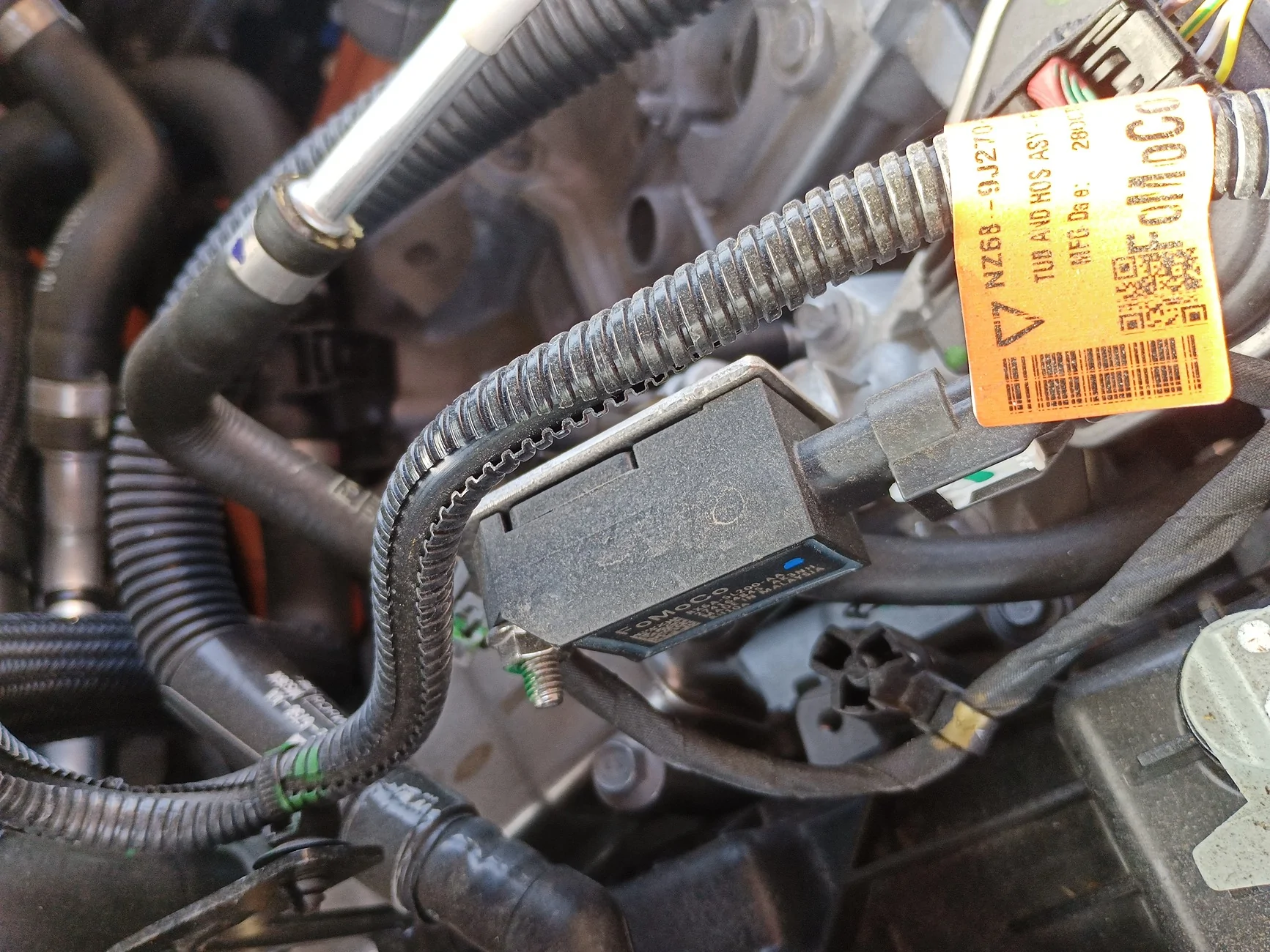

My 22 also looks the same as Glen's, but not as clean. No sign of damage after almost 4 years.
Thank you for your photo, @icegradner
So far 2022-2023's are fitted identically.

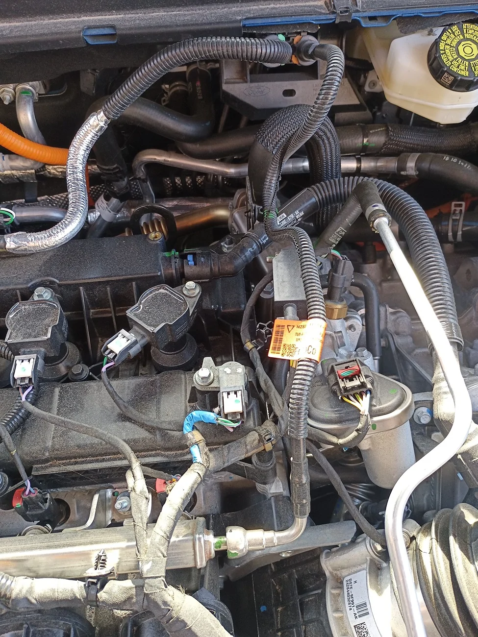

2026 hybrid checking in:
Ford Maverick HYBRID ONLY Fuel line issue fuel_lin

Wonderful! Another year covered off, @El Kabong!
So, was 2025 the start of the extra synthetic line protector/heat shield, or did it occur in the 2024 model year?
We all can figure out ourselves that additional items that add cost or time are never added by manufacturers unless it was really needed, they did add this extra piece to shield that fuel line.
Come on, unknown 2024 Maverick owner! We showed you ours, how about, ah, popping your hood so we can look inside!
Ah, cheese and crackers...that sounds a little creepy...sorry about that.
Just trying to add a bit of levity. 😉

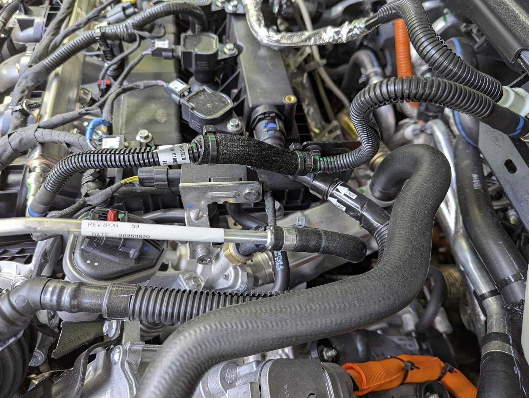

My very early '24 looks like the OP's, Glens and @icegradner's. Mine was built the first week of that MY's production IIRC.
Ford Maverick HYBRID ONLY Fuel line issue 20260531_184351

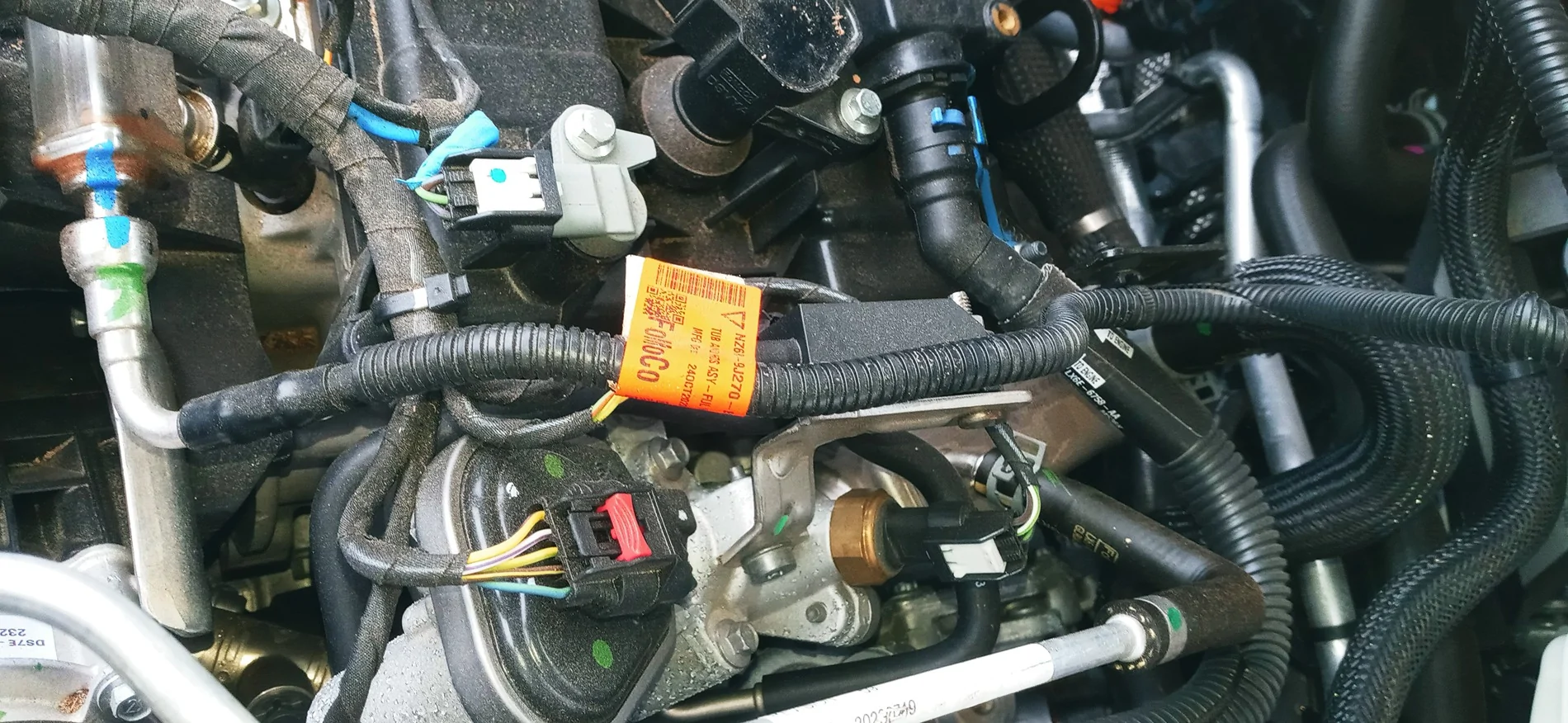

Seems to me from the description of the leaking area and the pictures, that the leak coincides with that area of the thin shielding in the OP's that has a nick in it. Could it also be the cause of the leak?
Ford Maverick HYBRID ONLY Fuel line issue Screenshot_20260531-193659
