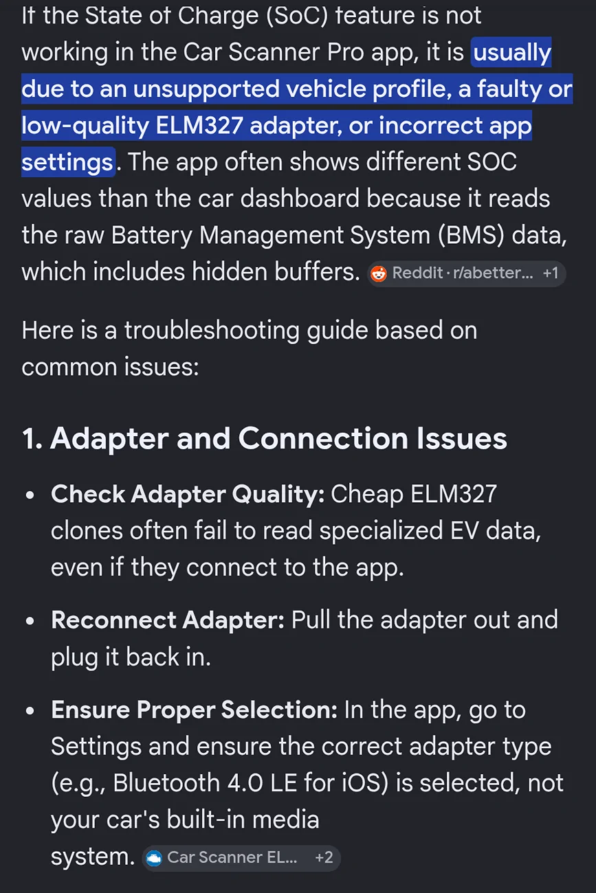

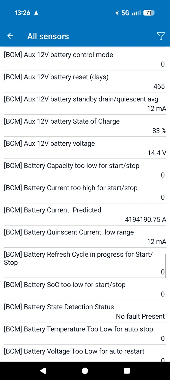

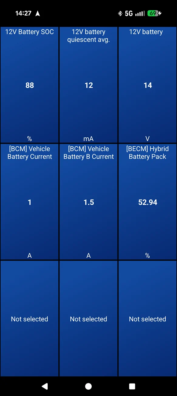

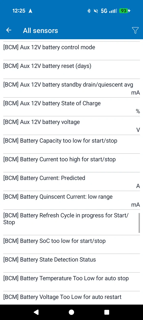

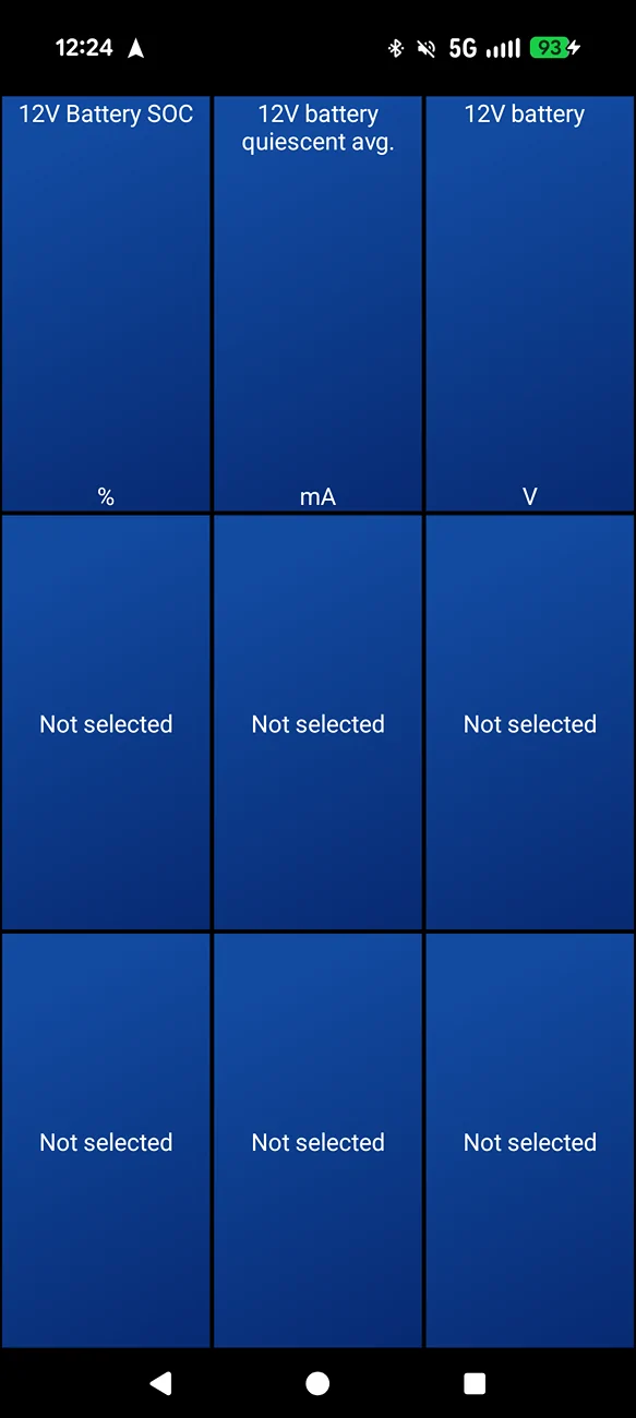

Ok so I had time today to check on Car scanner pro, and now I'm stumped when I click all sensors the 12v stuff is there in the BCM but car scanner pro isn't reporting anything. Maybe my cheap obd2 bt? I have the full paid version on car scanner pro too. (25 Hybrid XL fwd)
l
Looks like my cheap bt obd2 might be the cause

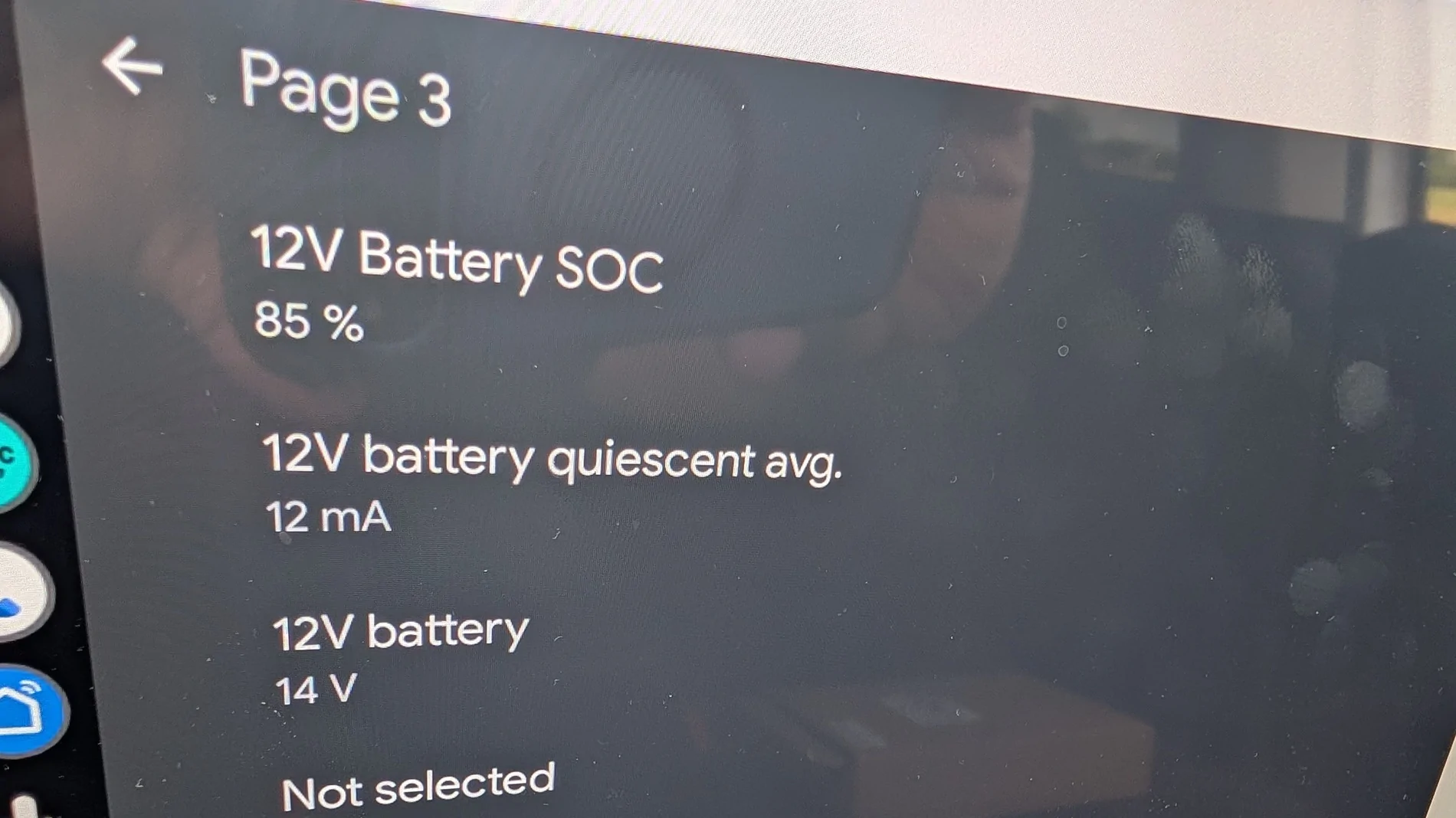

I've got a VLinker Forscan recommended - and I do get values for those, though I don't see all those PIDs, hmm. Also free version - only see 2 at a time.
I need to splurge. Just helped a friend tonight, another app/dongle could only see 1 ECU, just basic OBD2 stuff - not really useful. Car Scanner would have been much more helpful.
I didn't pursue CSP way back because early on they had no Maverick profile, so had to select some prior Ford hybrid, and names/values really messed up, unusable.

I actually just ordered vlinker bt version I'll let you know how it works Monday when I get it. I use vlinker usb for forscan on computer

Over 10 months and 4,500 miles. My25XL's 12V battery's resting voltage(after 24 hours) has slowly decreased. It is currently at 12.1 - 12.2 Volts.
I'm guessing that I will be looking for a new battery in a couple of years. No big deal, I love the truck!

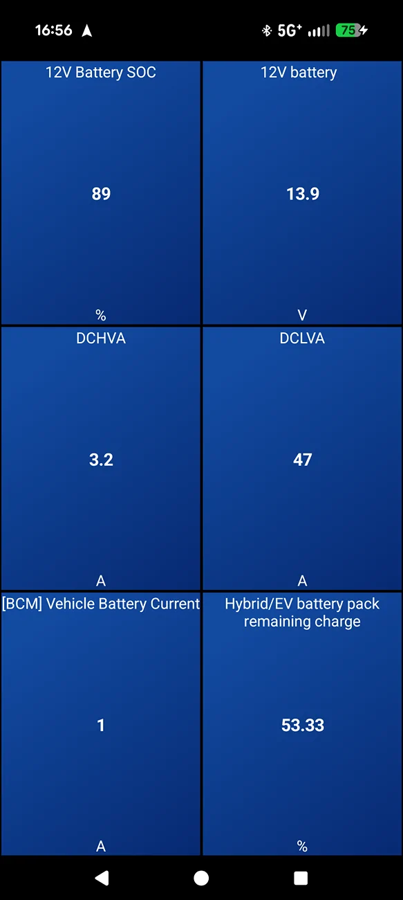

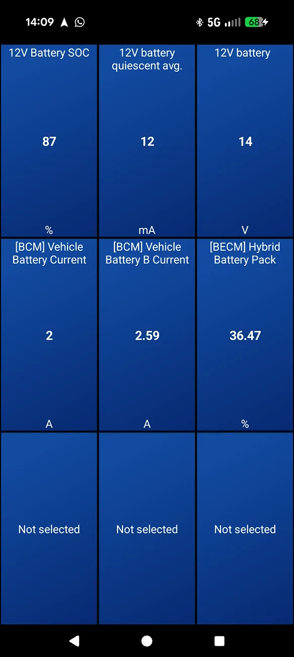

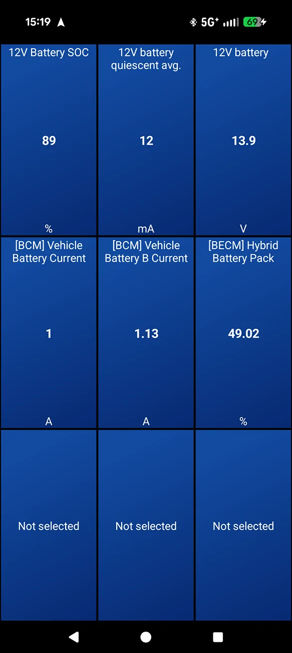

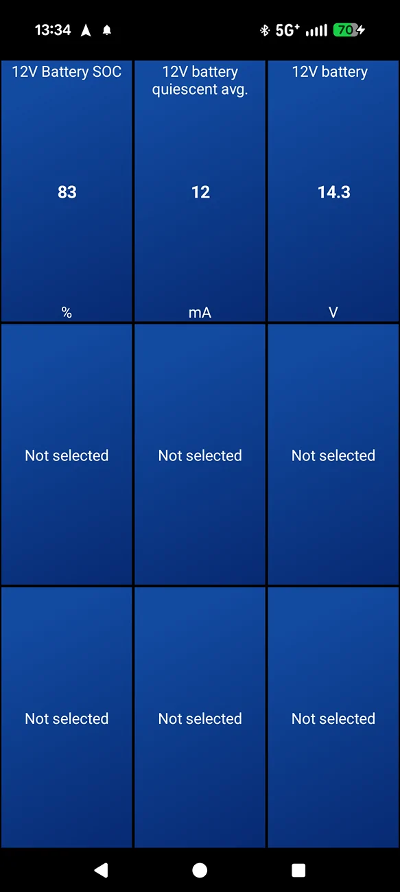

When I got into the truck the truck SOC was 83%
Drove for about 25 miles and the SOC was 88% (The headlights were auto and I made sure the fan speed was below 5) The Amp rating was 3% when I left and was at 1% when I got to destination. (AGM battery from Ford Day #1)s
When I took the return trip I turned the headlights on and the SOC never got above 89% and the Amp rating was at 1-2% the whole trip.
What am I missing? Or what is supposed to happen when you turn the headlights on, cause I thought it was to trigger the truck to charge at a higher amp rating and get the battery to 100%

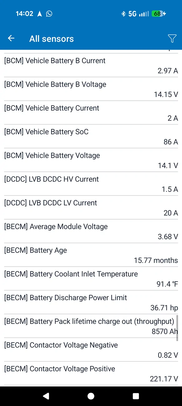

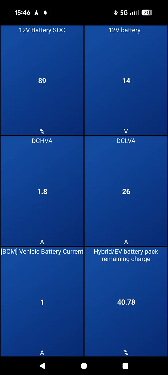

DCHVA DC high voltage amps
Downconverter to
DCLVA DC low voltage amps
1.8A x 220v = 396 watts
26A x 14v = 364 watts
92% efficiency all else equal
