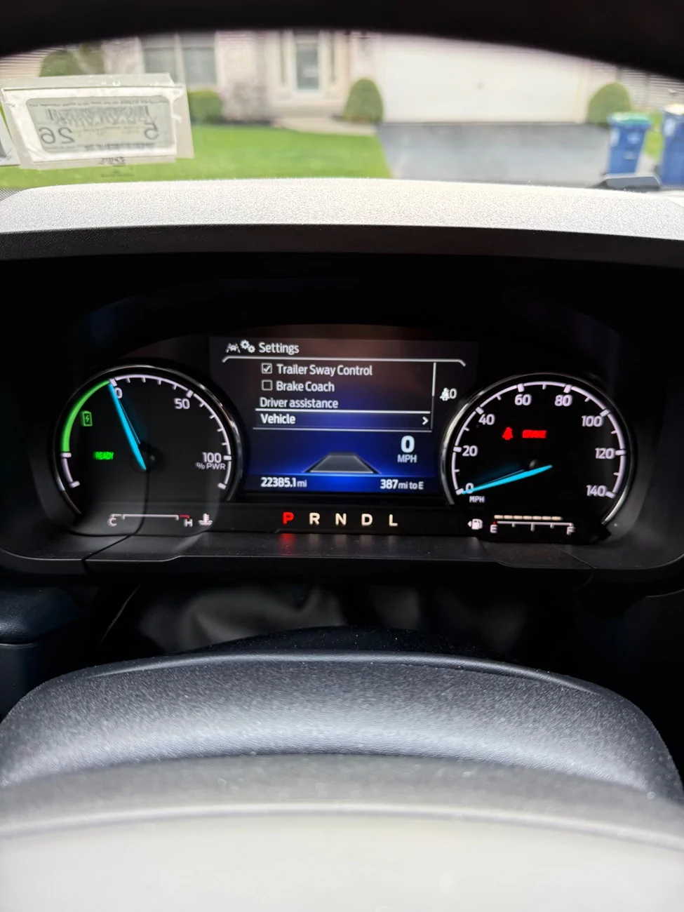

Just to add to the conspiracy since folks keep mentioning the trailer plug…
Could the fact the trailer control sway is checked even if there is no trailer attached have anything to do with it? I keep unchecking it yet it keeps coming back.
