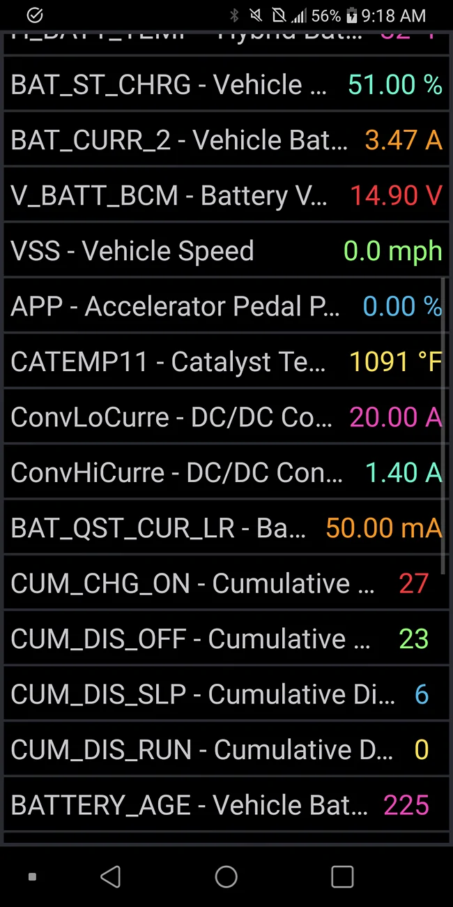

I cannot, I think I need to import some custom PID infos into Torque for that, but I don't know where to get them for the Maverick. Plus the phone I'm using for it is extremely laggy, I do have another unused phone that is newer that would probably work better.
Would be willing to try more data gathering if someone can provide the PIDs.
Under BCM or BdyCM depending on how it calls the module.
Others have mentioned that Torque had them, so perhaps just an update, or it's the 26MY aspect of it.

I can show you log files from my truck proving that the BMS system believes it has equal amp hours charging and discharging.
There is no heavy drain that isn't met by a heavy charge for a few days or a long drive - I mean 8-10 amps for 10-15 min, then slowly dropping, but not as fast as normal.
And yet despite that - the resting voltage is down at 11.8-12.0 very easily, because at the start it was willing to let it drop.

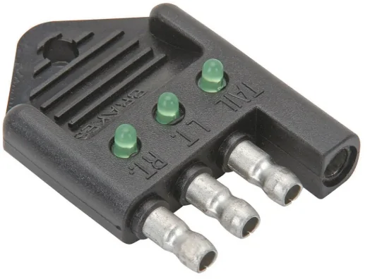

I picked up this trailer plug tester today to see if it would be enough to trigger the higher voltage, but it didn't. The truck doesn't acknowledge that anything is plugged in to the trailer port even though the little LEDs are lit.
Mavster Mechanic
Mavster Mechanic
Jul 29, 2025
1,786
3,113
Hybrid
Good idea though.
Mine has 12 LED and the truck thinks it's a trailer.
