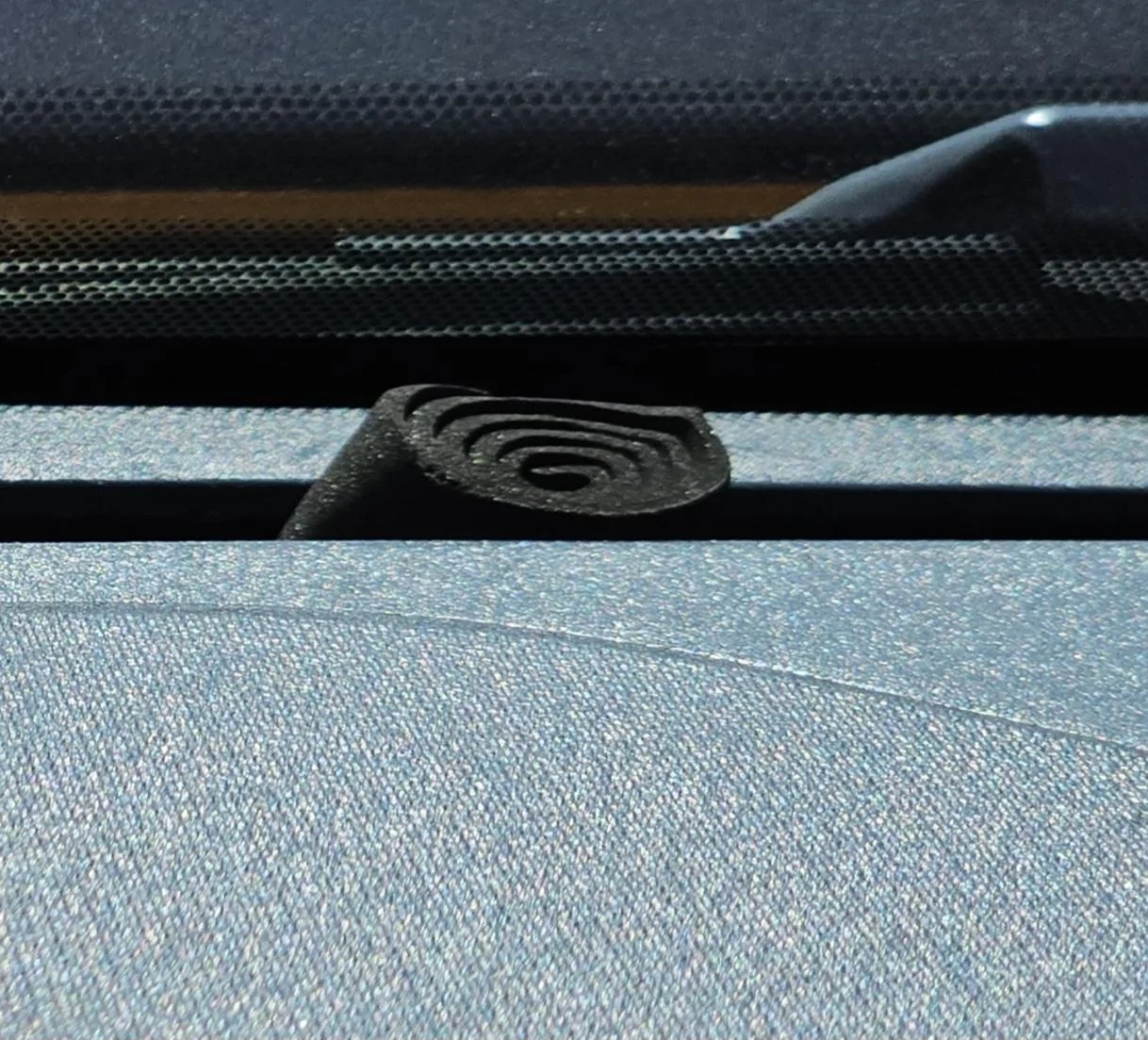

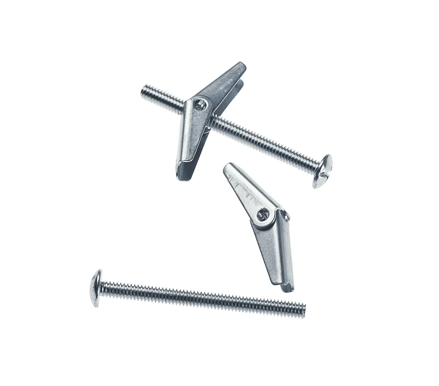

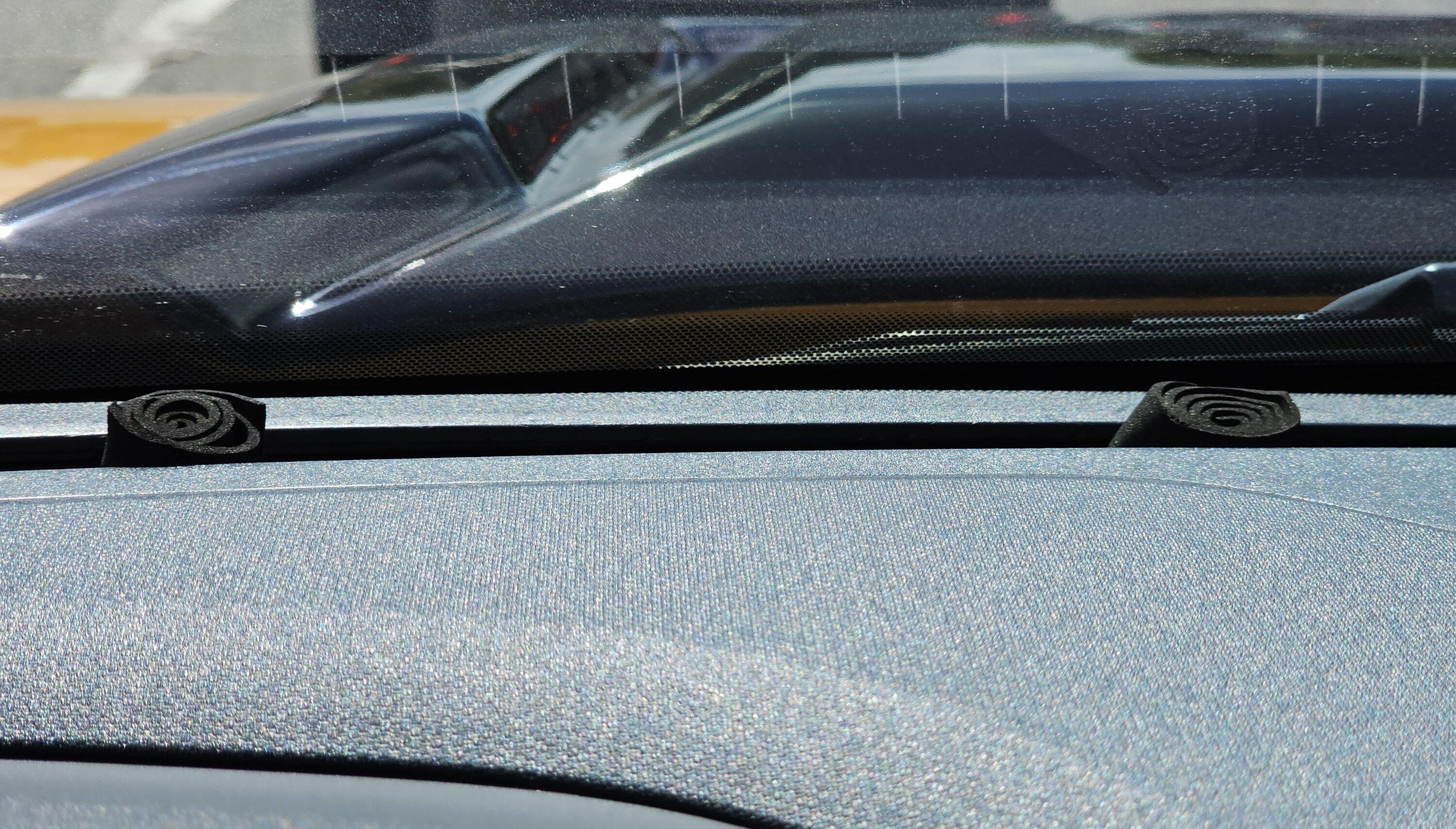

I solved the problem on my truck. It's a pretty janky fix, but it's effective. I tried several other ways and nothing fixed it but this.
The core issue on mine is the black defog ductwork rubbing on the bottom of the dash plastic. It's a plastic on plastic rubbing noise, and I think its caused by them not being connected to each other and moving separately.
My solution is to use a toggle bolt with an extra toggle screwed on to it in the opposite direction to use it as a custom-sized "spreader" of sorts. I have it put pressure on the blue dash piece on the back side, and then wedge it down into the black defog duct on the front side. As a result it puts enough pressure on the two points to stop the rubbing. Like I said, it's janky but it's super effective, at least in my case. The piece wedged against the blue dash in my pic has a piece of electrical tape on it just to cut down on the shininess.
