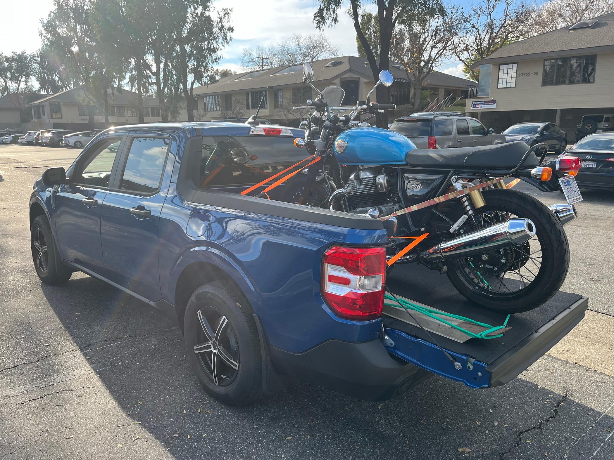

Scot LX
Scott
Sep 24, 2022
44
43
So. Cal.
Maverick XL, Honda Element, Royal Enfield INT650
It held up the back end of my bike as well, but I was careful not to add my weight to it while climbing down. Better to be extra careful, than to wish I had been after I screw up.
