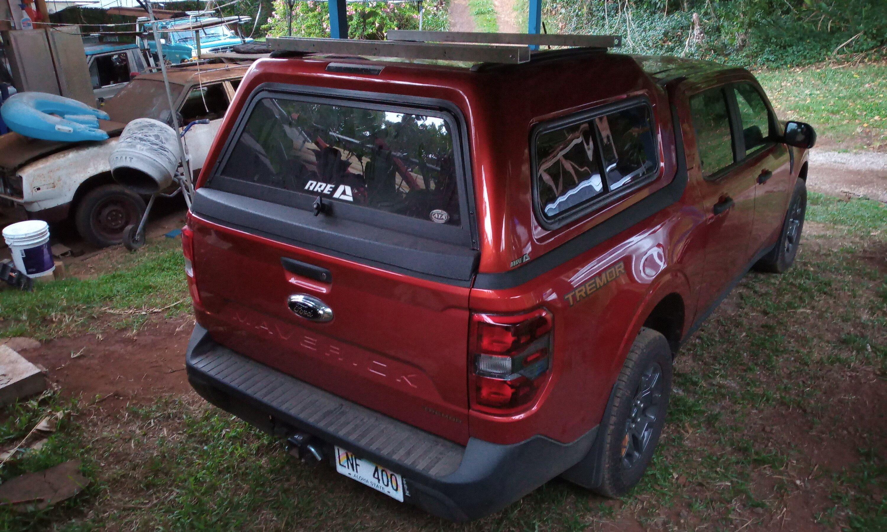

Totally get your needs. My wife is in the same thing light home construction. I just put a set of home made crossbars on our topper. It should be adequate for a decent amount of short boards or a few up to 12ft. I will eventually be adding a single front roof cross bar to make it better for the 16s and 20s.
If I were you I would go with dual bed bars and a single roof bar. The roof bars mount to painted metal and that scares me for future rust. The bed bars, home meade or not are usually easier and cheaper to get in heavier duty. Like the TracRac bars on my old Comanche are rated for 600lbs and I have had a lot more than that on em. Then when things get long or you buy a canoe you got the front one to keep things a little nicer.
Ford Maverick Can I set up a combination roof cross bars and bed support? IMG_20230902_184251_095
