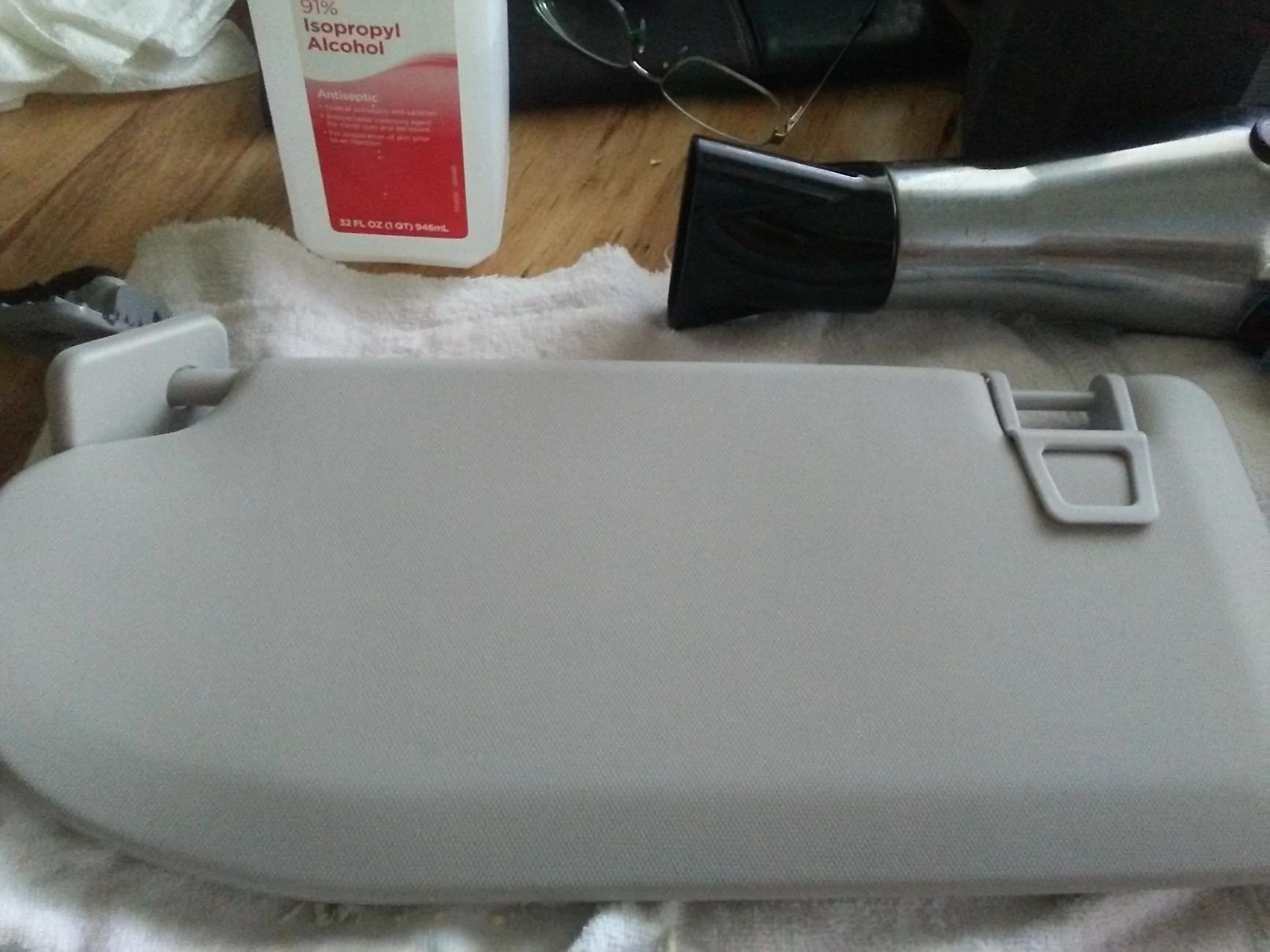

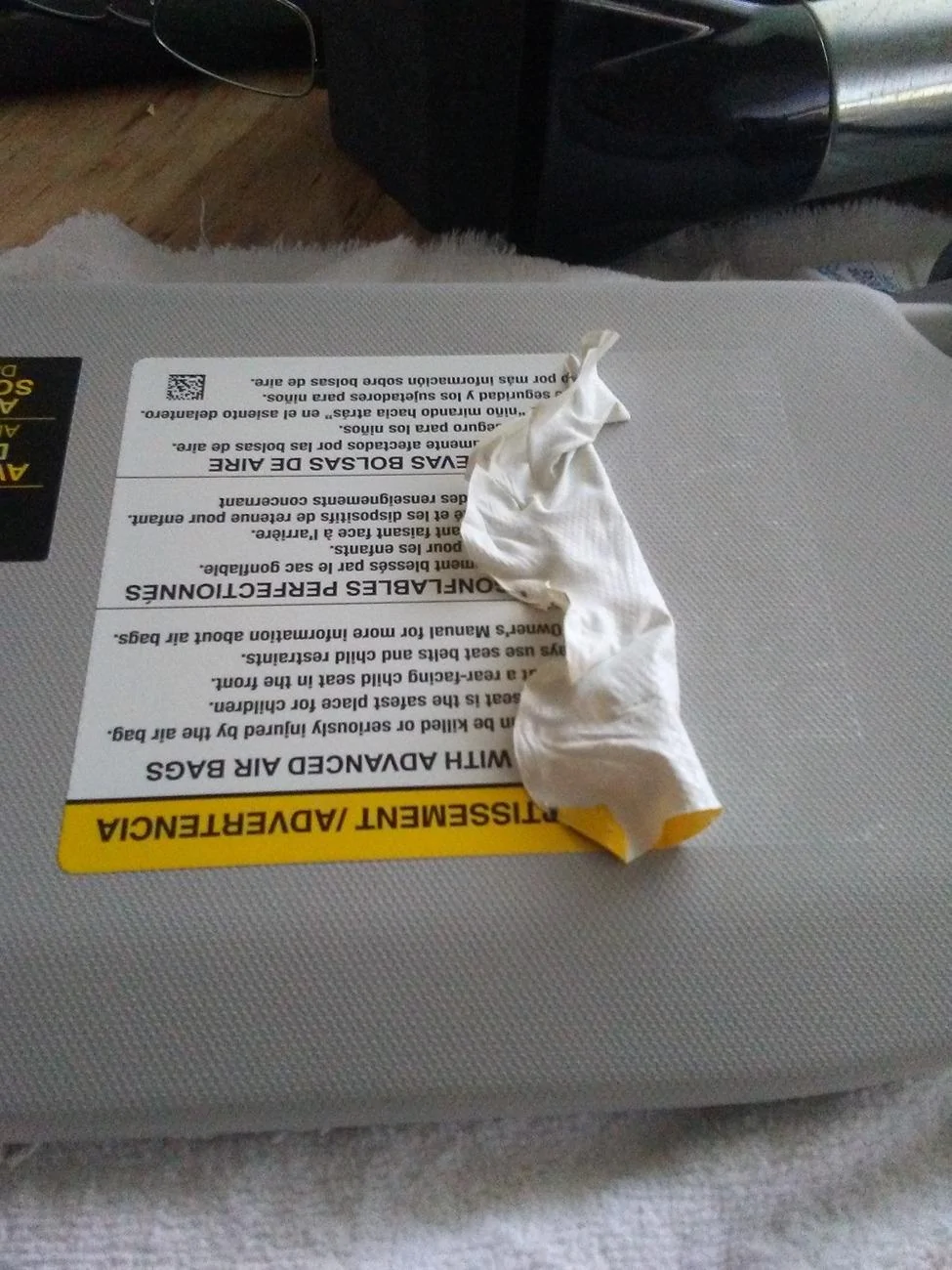

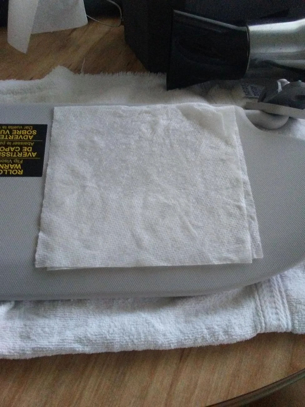

Thanks for the tips. Removed the visors and used a hair dryer to heat up stickers. Stickers are a plastic film and comes off in one piece. Hest and peel, repeat. Peel off slowly at a sharp angle. I used isopropyl alcohol for adhesive removal. Lay a soak paper towel on the adhesive for a few minute and it ruds off pretty easily.
Looks clean!

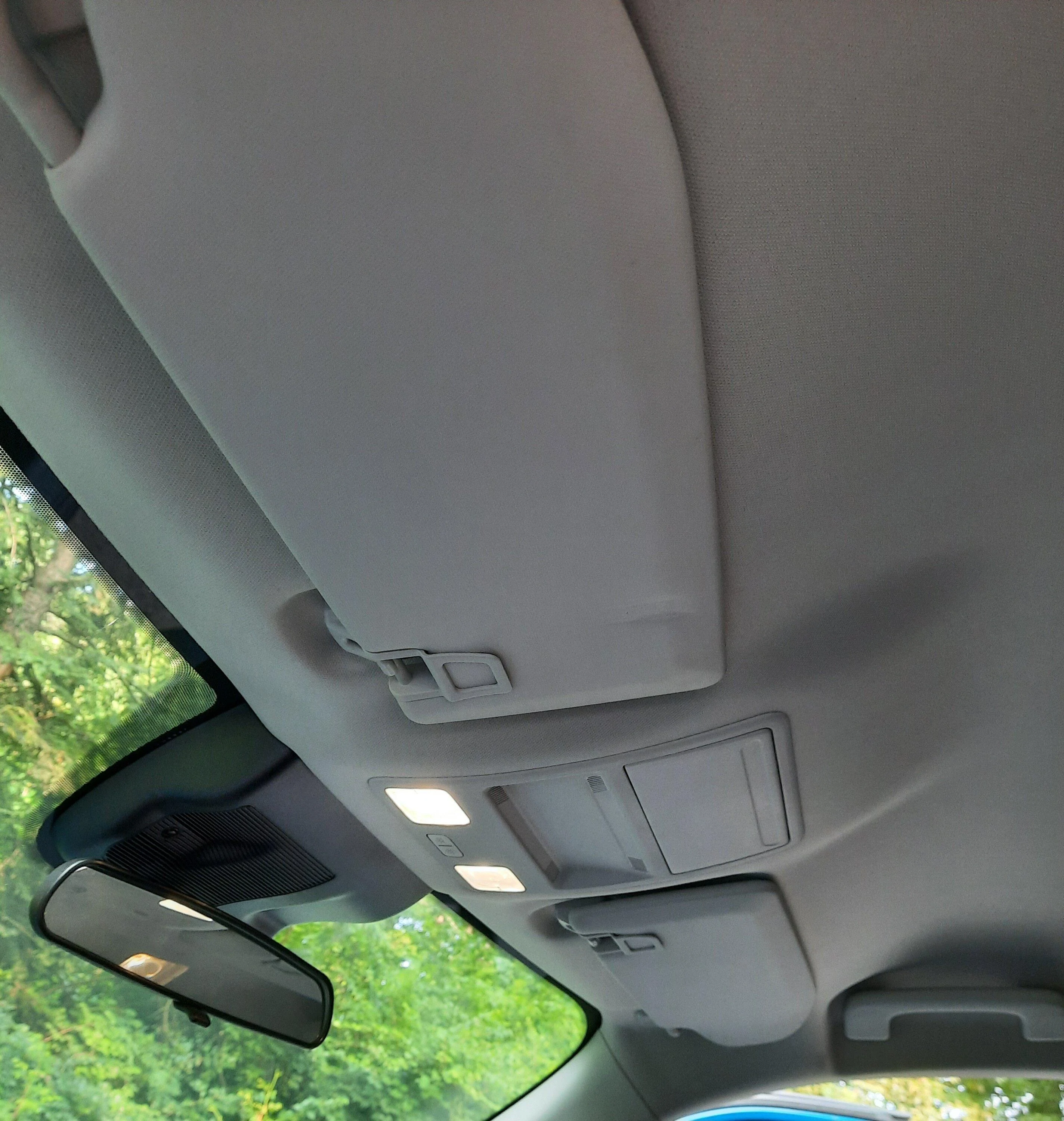

Looks great 👍

Thanks. It takes 3-4 minutes to get each sticker off and about the same to remove the adhesive. Highly recommend removing visor the from vehicle. Pop off dress cap and remove one Torx bolt (20#). Swing the assembly towards you and it will come out with a little wiggling. Disconnect the power wire and take inside where its comfortable.
