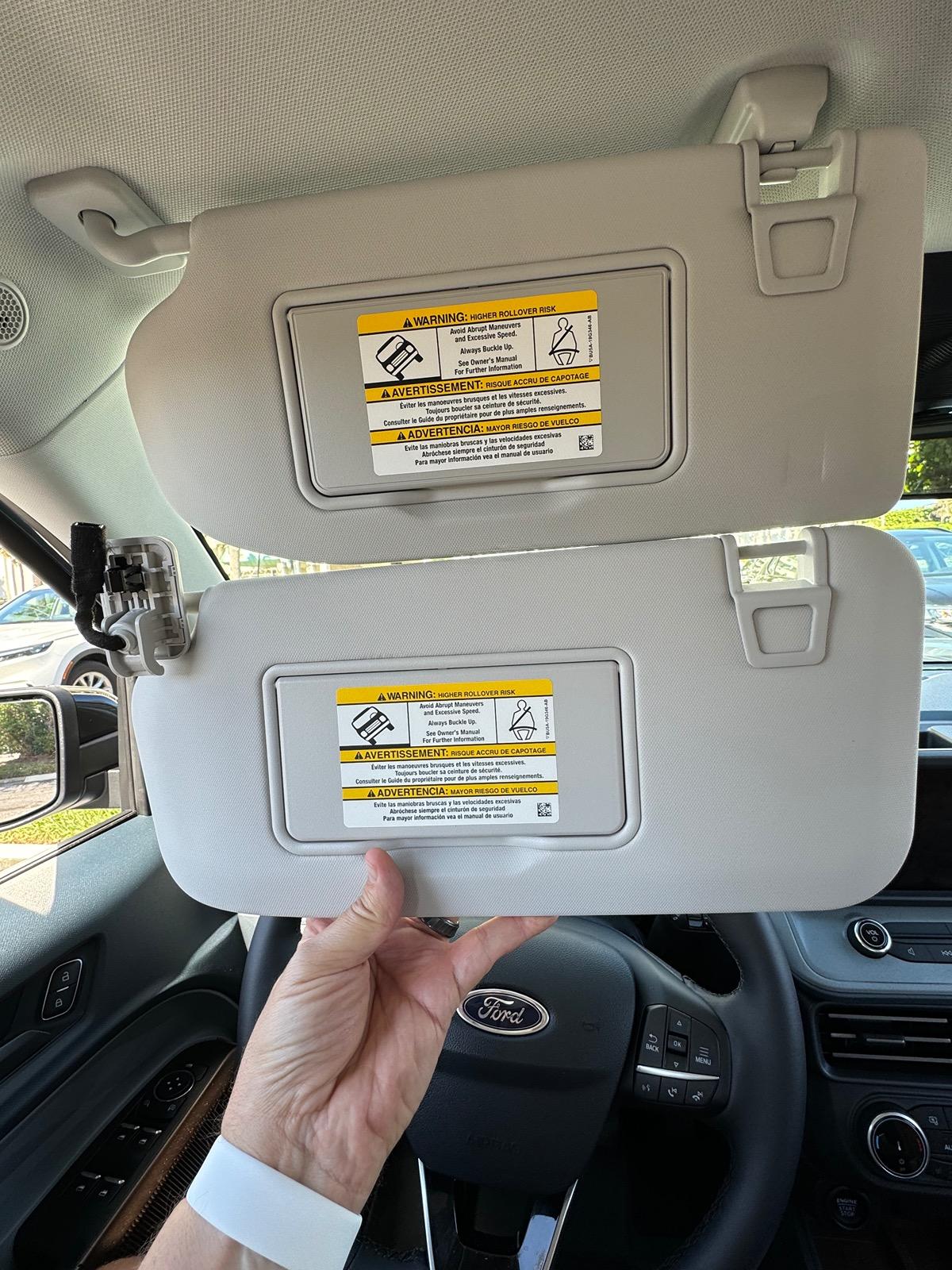

Ok I have the part and have some pictures. Unfortunately it is not good news. So the Bronco Spot visor I ordered was part number N1PZ7804105GA. In my first pic below you can see the two visors. The one on the bottom I am holding is the new one that is the part for a Bronco Sport OBX. It is slightly longer than the original visor on my Lariat Mav. You can see the color is a match. However, even with the extra length, it still "fit" and would clip into the holder fine.

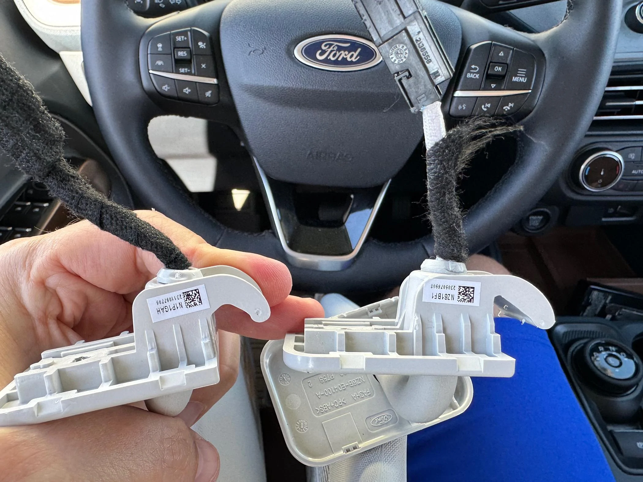

In the second pic is the part that creates the problem. The one on the right is the one from the original Mav visor. The one on the left is from the new one for the Bronco sport. The difference results in the visor being loose after it is fully installed and screwed in tight. The T20 Torx screw that holds it in is on the end closest to the windshield. Once screwed in, because the the slight difference in that curved part that loops in to the headline, that end is loose and wiggles around every time you flip the visor down or up. I imagine it would eventually wear and get even more loose and likely start rattling which would drive me crazy. So, I am hoping I can return this to the ford dealer I got it from. On the good news, it was very simple to install. It indeed was plug and play and the new visor got power to both the light and the homeland buttons. So, my other thought is I wonder if there is a version of the visor that is for a Bronco Sport with a sunroof. My BS doesn't not have a sunroof but my Mav does. I think when I was trying to find the visor I saw something that looked like there might be different version based on the presence of the sunroof. So I am going to research that further and if there is a different version I may try it and see if it matches and works. If so I will keep updating this.

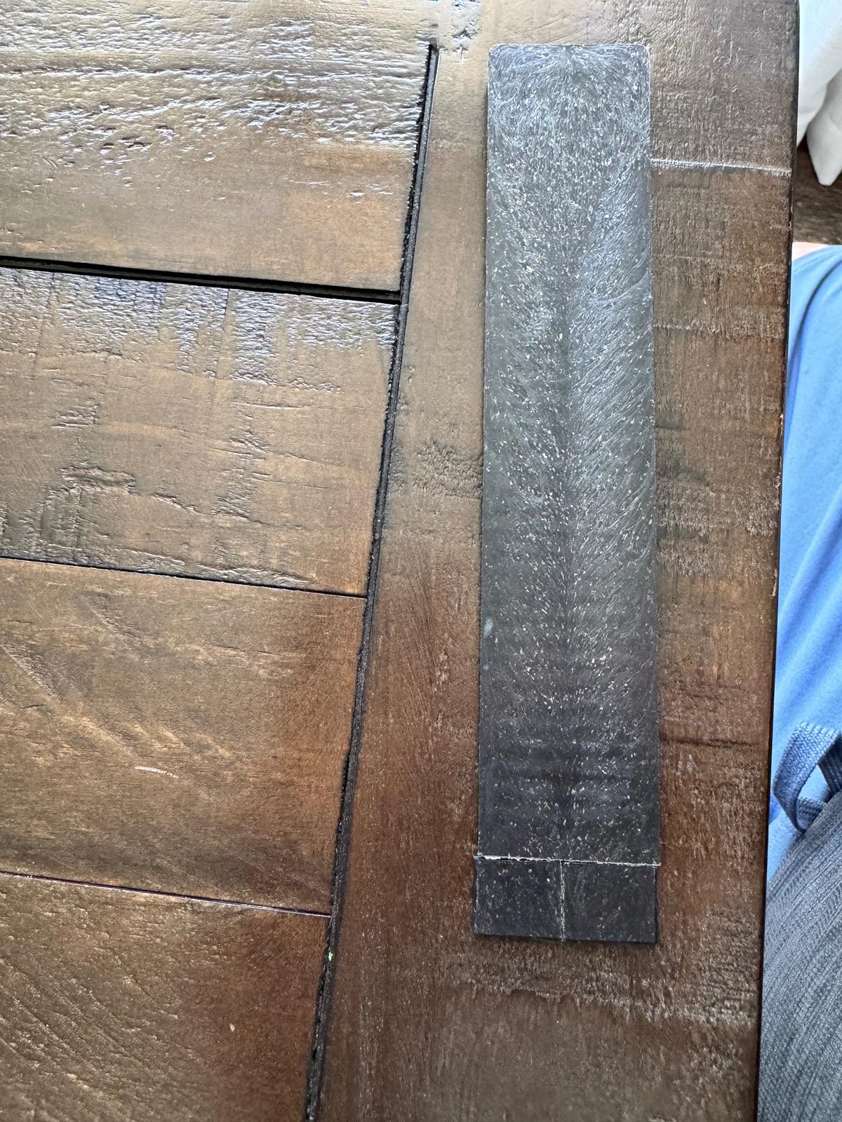

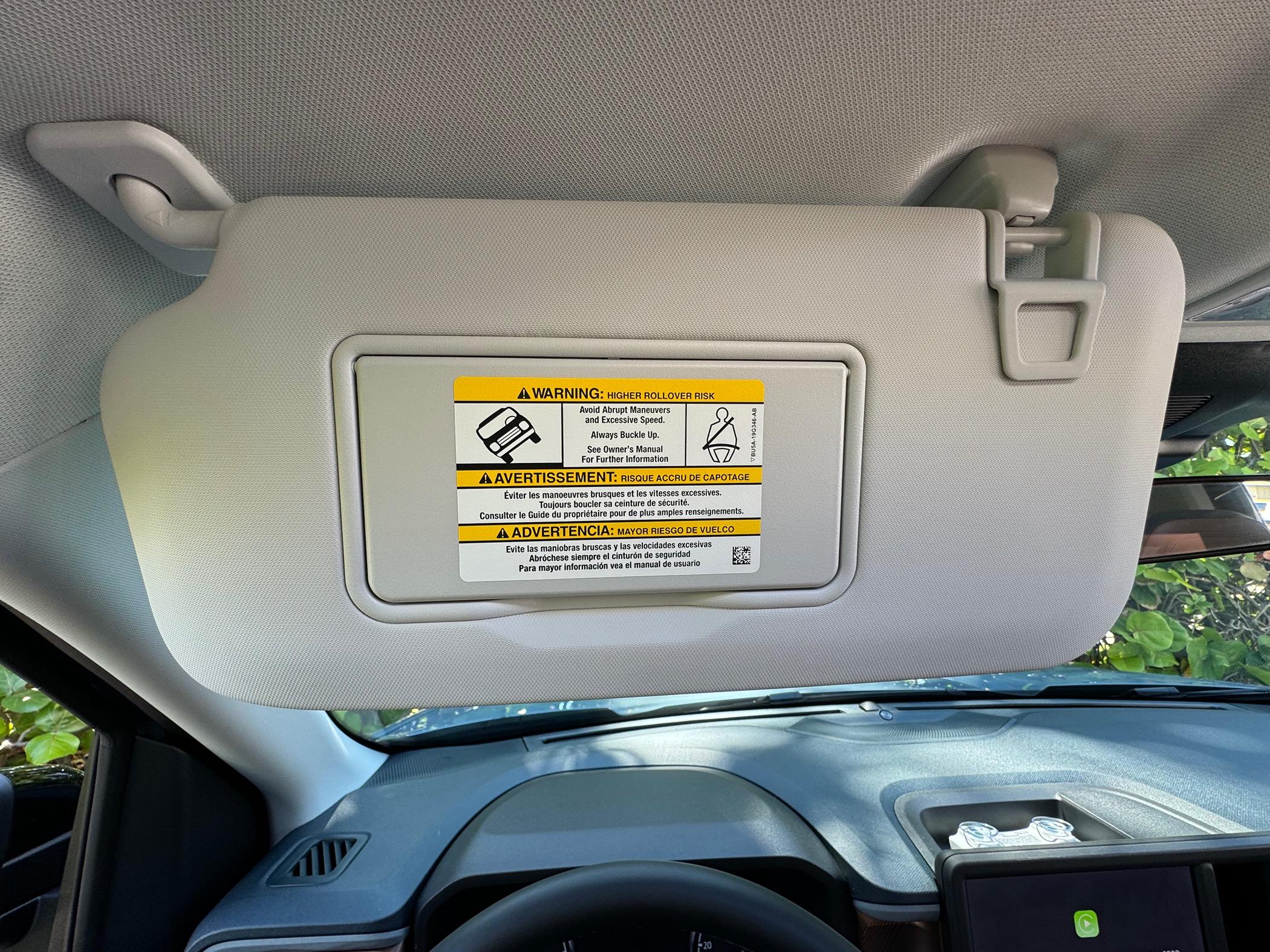

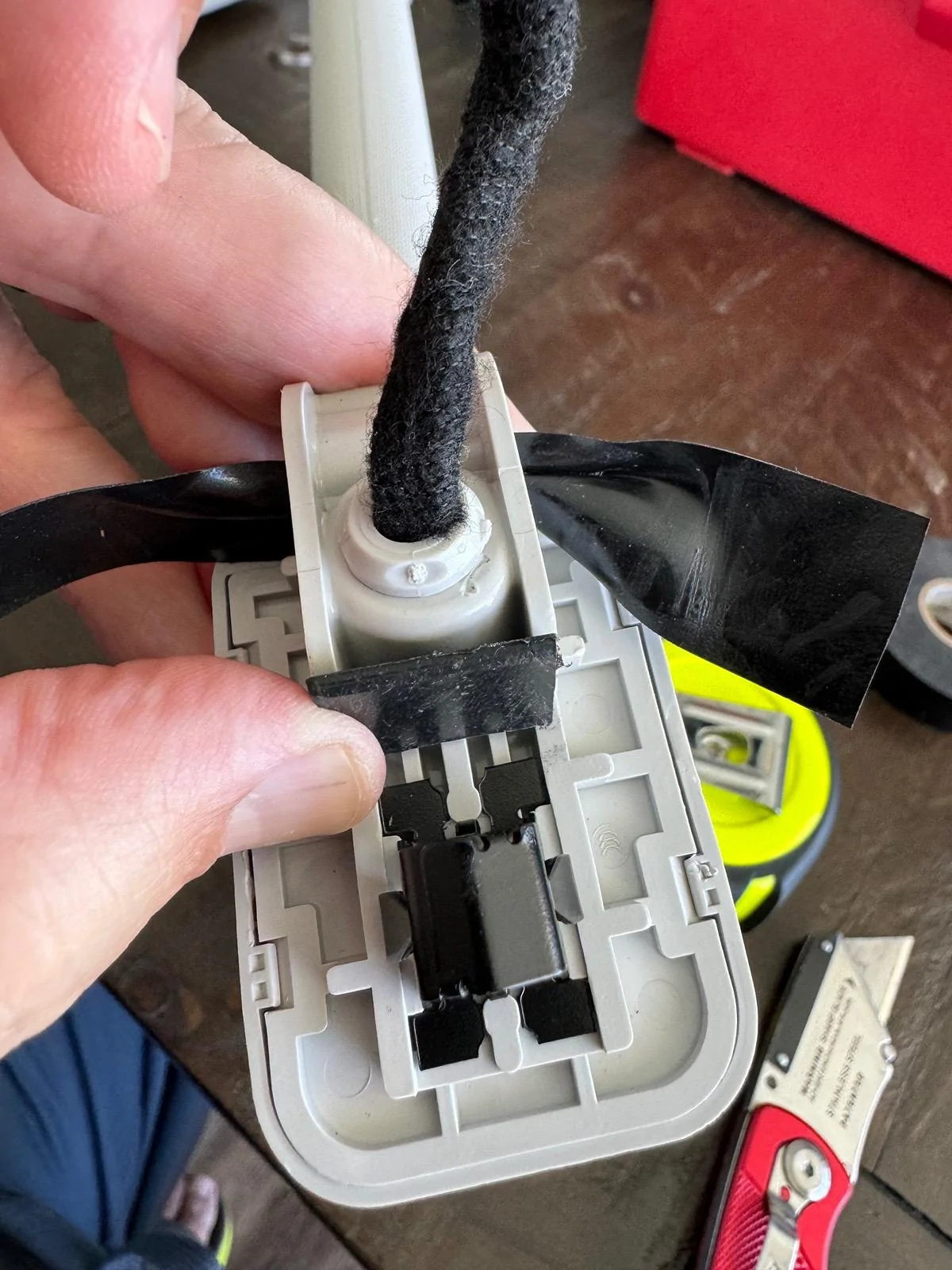

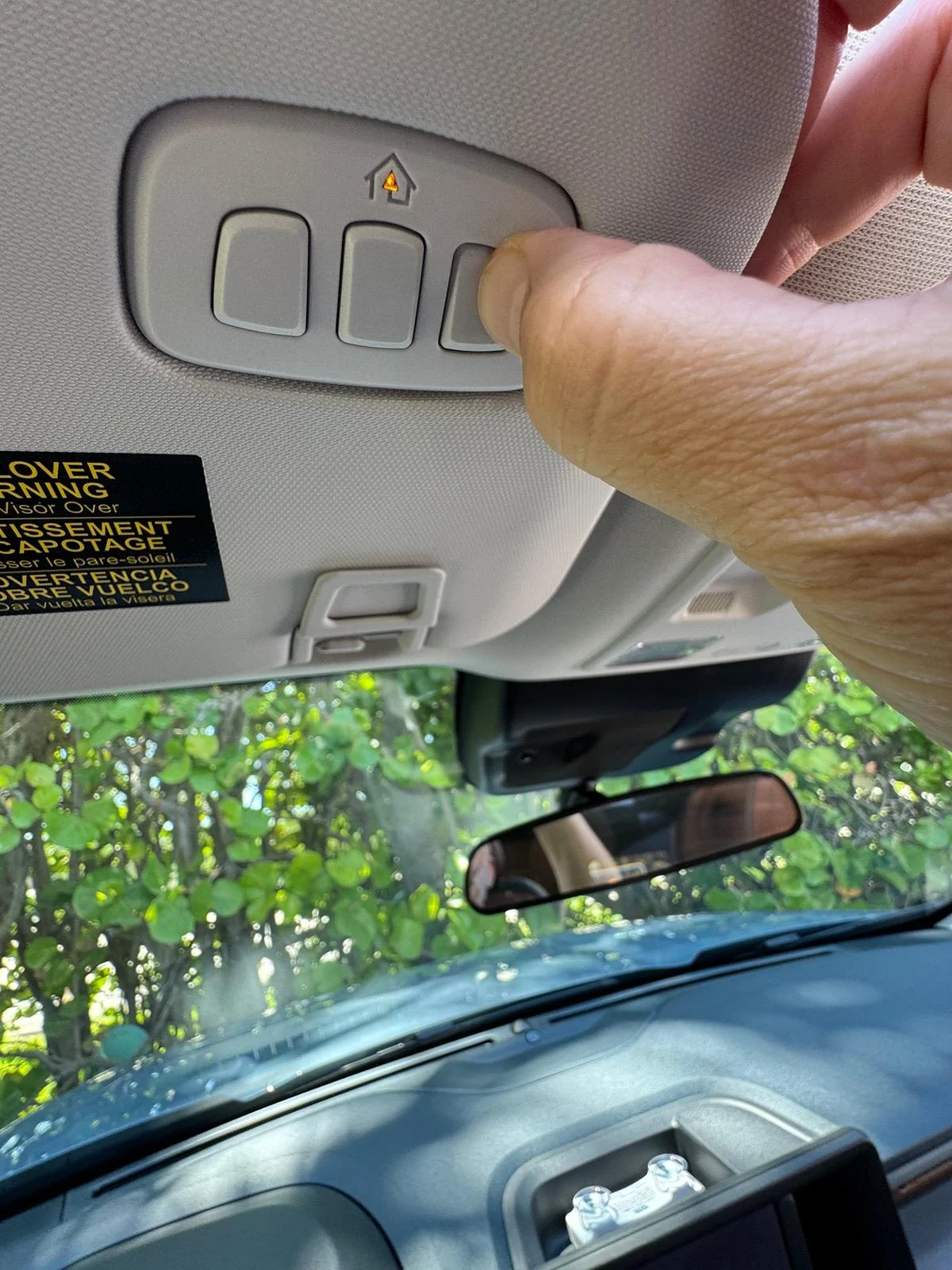

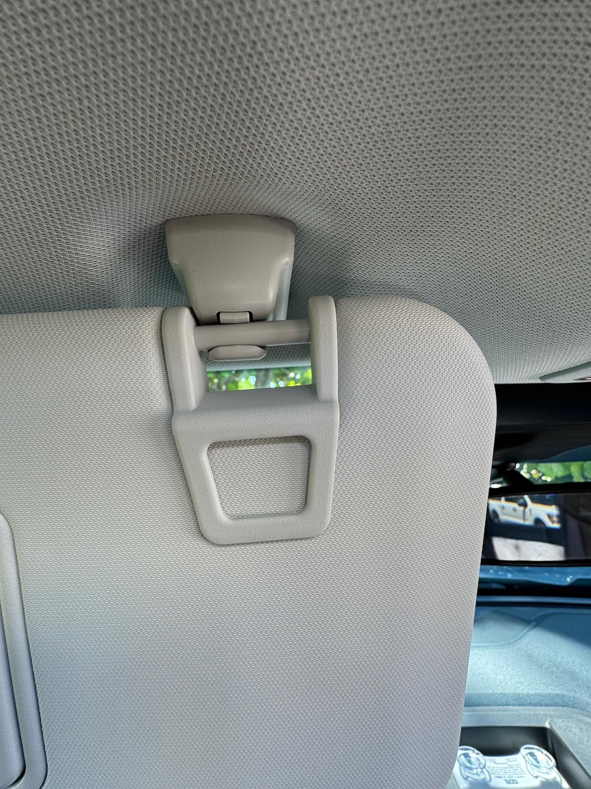

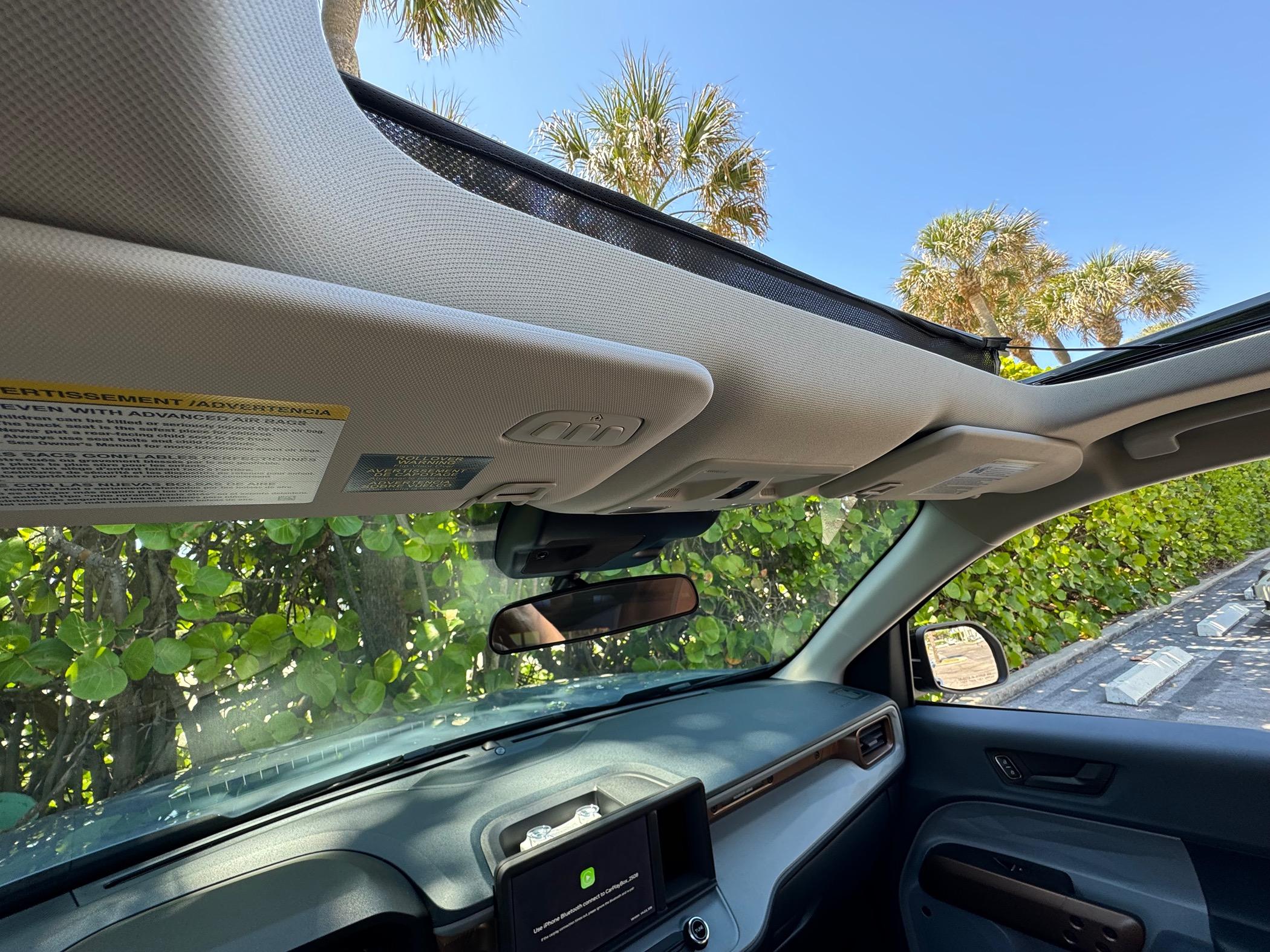

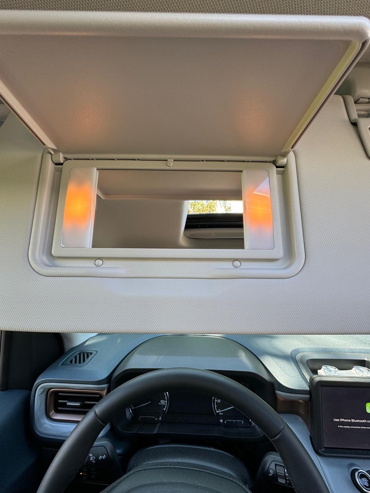

I have good news. My idea worked. it is actually pretty simple. I took a plastic shim and cut the tip end off and then cut that piece in half and taped it onto the back of the visor where it slips up into the headliner. Pic is attached. It is now tight and works perfectly. I’ve also attached some pics of it installed in comparison to the passenger side visor. You can see that it comes back toward the drivers head further than the passenger side does. But it doesn’t bother me and I think it is hardly noticeable. Since the style of the visor matches the general shape and style of the passenger visor I think that it may even look intentional. You all can be the judge. But hope this helps others decide if they want to do this or not.

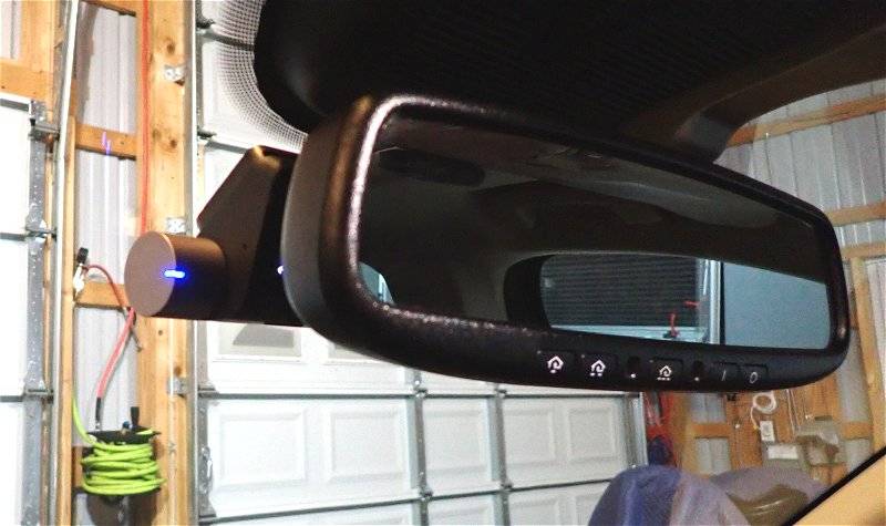

Mirror is cheaper and easy to install plus you get the self dimming which works even in the daytime when someone behind you in a maverick has aftermarket LEDS. :LOL:

Sadly those mirrors are $250-300 with the auto dim! I don’t really care about auto dimming and would prefer a PNP setup!

Visor is $285. Got the Gentex self dimming mirror new with Homelink for under $200. https://amzn.to/3MtbgT7
I can get the part for cost, so that’s not a big deal for me as they’ll come to about the same price. But out of curiosity what was wiring like for the mirror?
I just ran it across the top under the liner and down inside the A pillar to the fuse box behind the glove box. Plugged it into an accessory location so it's not powered a few minutes after the Mav is shut off. Ran a dash cam cable at the same time.

Bought a homelink gentex auto dimming mirror for 60 and made a pigtail harness to plug into the dome lights to avoid ttaps splicing into the wires. Hardest part wast getting the crimping right on the wires to fit properly into the plugs.
