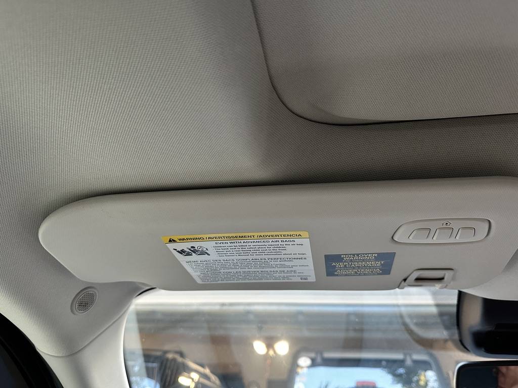

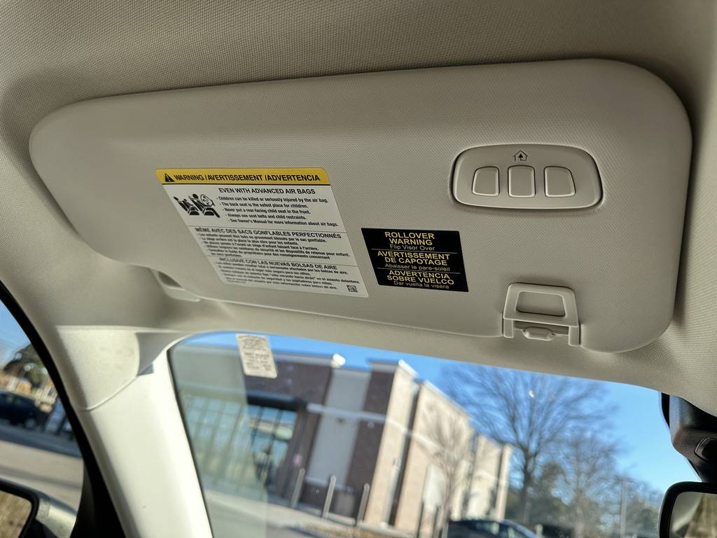

Ha, I did respond to your Facebook poll. It was a direct swap. This is the only picture I have, didn't take a before or installation pic so I can't show you the difference in the plastic mount.
I've got a sunroof so it's a bit of a tighter fit side to side but it fits.
I was checking ebay to see if I could find a pic of the mount but no dice. I did run across this visor however:
https://www.ebay.com/itm/395556084708?fits=Year:2021|Model:Escape|Make:Ford&_nkw=2021+ford+escape+sun+visor+driver&itmmeta=01J6QQ42Z2X6E8TQBC76RYZAT6&hash=item5c18fadbe4:g:i6AAAOSwnHxmXyaU&itmprp=enc:AQAJAAAA4HoV3kP08IDx+KZ9MfhVJKlBiqkjortiLXb5TZPkW1hyKz7cLztMO5eVbUBqd/UBzHJ0ug4lxE2DYyff4+RH3nr+pHuvc5O8ewn8jCzyzD4gCKMBOexx6thCDeBxnh8znLvNXxB/+ABNqyqwU9hnGbEVb4Cnls6nm6bmU7bvuyVlK7SH1gPkLDIEw8nxH4SHQ/kkDGPdlXLTz1Hyc8XK5sYQGRZMhwVPsdorMHPIXYfWuM2VkIkoYYmaAJ8coJ50uDjuR9VE6+z0HUKW1l3D8+sSY2woiM2ggXJS2VBtAXZK|tkp:Bk9SR9KvkPe1ZA
How does the color match the one you took out of the Maverick?
When I was looking up Ford part numbers for the overhead console, the numbers were slightly different. It appeared to be because the color (the last 2 letters) is slightly different.

So I have been looking online, the 2021 model year escape has part number LJ6Z7804105CB, which in ford's parts catalogue goes to a plug-in hybrid model.... the 2020 model year has part number LJ6Z7804105CA (all the same but last letter) and that is for a standard escape, I think? You said on Facebook the 21+ is different?
Based on my searching, when looking at overhead consoles, the last 2 letters are the color.

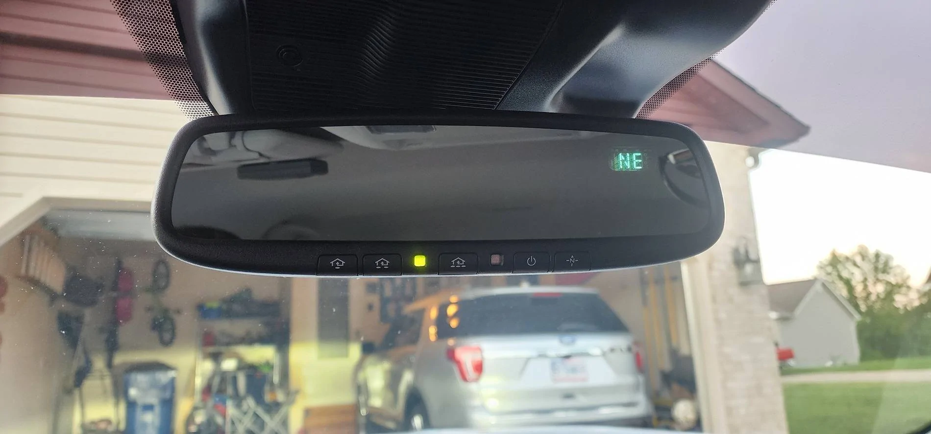

Adding the mirror was the easiest mod I've done, and was the first one I did. Having the mirror auto-dim the super bright headlights on the lifted coal rollers behind me is worth the $45 and 45 minutes I spent installing it, and I have two extra HomeLink buttons for the future.
@Deweyordeweynot, what part number did you use? It appears that the part A7062-ADUP1 that I saw originally posted is no longer in production.
D9062-ADUP0 is the part number for the homelink mirror I ordered it looks identical and was 31.40 That's with shipping included from Kia. I've installed two of them now one in my 24 Maverick XLT and my dad's 23 Lincoln Corsair, My dad's only had the Demi mirror no homelink buttons which is surprising for a Lincoln.
Here's the link.
https://www.kia.parts/oem-parts/kia-auto-dimming-mirror-with-homelink-and-compass-d9062adup0?c=bD02Jm49U2VhcmNoIFJlc3VsdHM=
Just be sure once you place your order and you get an email confirmation that you email them you accept all responsibilities since they won't ship it without a Kia VIN number to confirm it fits.

Is that a photo of it in a Maverick? Only asking because your microphone that’s on the a pillar isn’t there
I finally got around to taking a picture of the visor on my Lariat and you can clearly see the microphone.

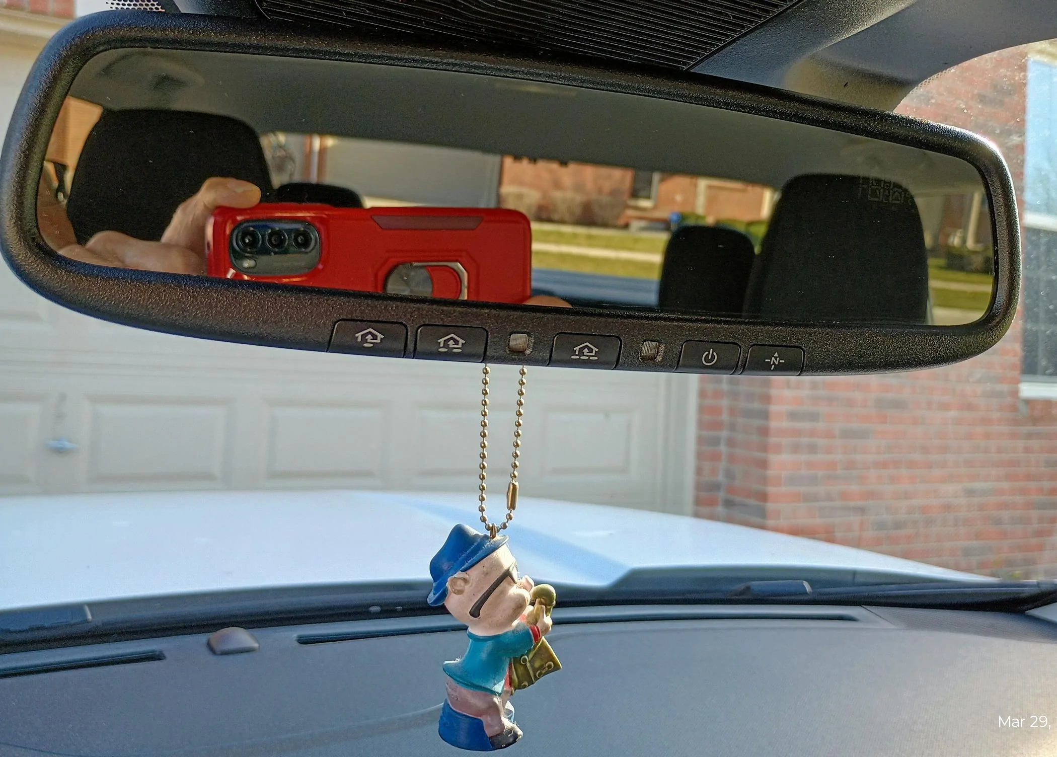

Here's the link.
The bright side is just about any mirror will work as long as you know what your pinout is on the pigtail. I bought mine as a blem from bobsmirrors and a quick email to their support and they gave me the pinout. https://www.bobsmirrors.com/Clearance-Specials_c_18.html
Thanks! Looks good!! Got the PN for the one you ordered? They’re specific to color and yours looks like it matches pretty well!
TheShark
Jul 22, 2021
1,504
2,281
Sorry, got that off eBay so no part number. Just to be clear that is a visor from a '22 Escape, the Bronco Sport has a slightly different mount that doesn't work very well.
