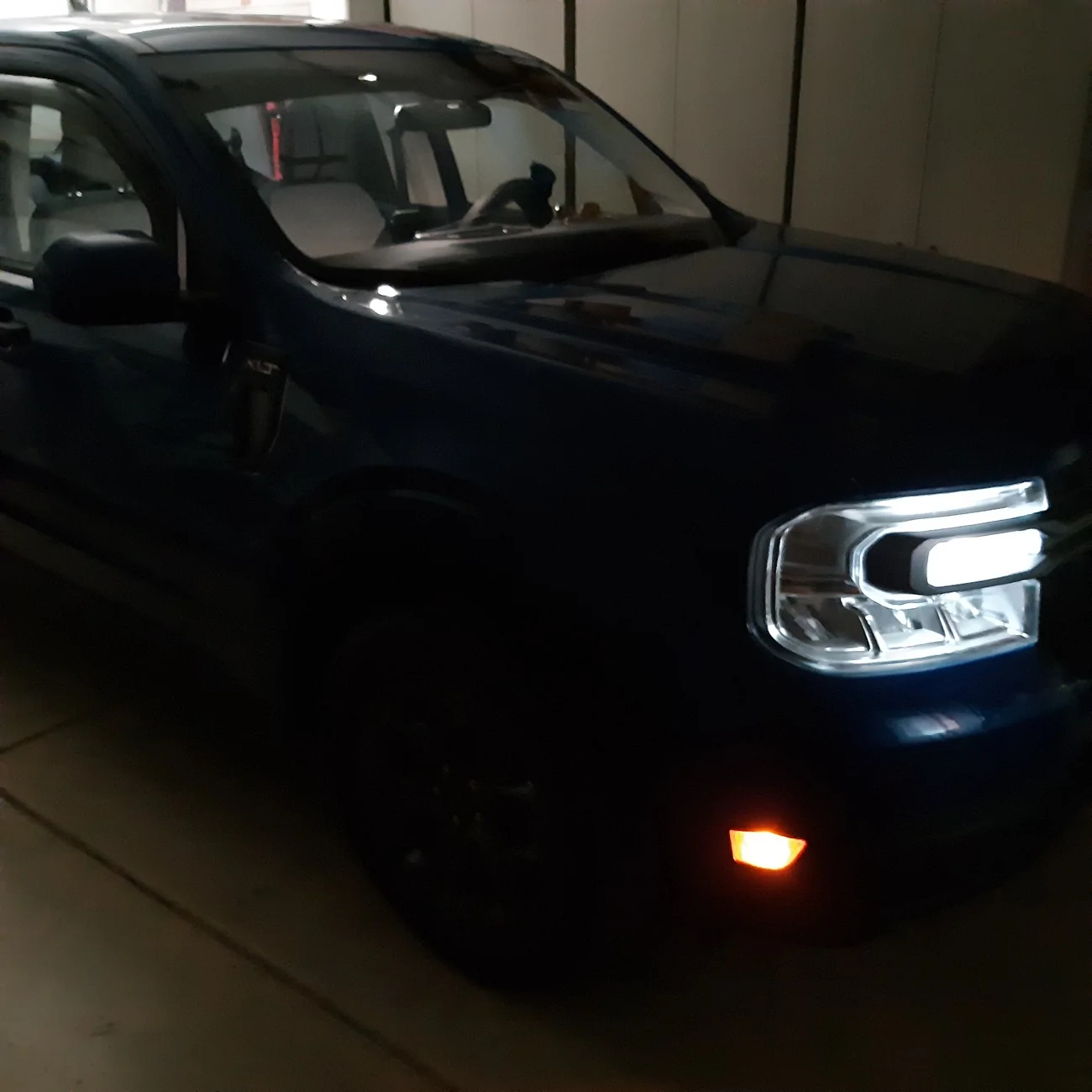

It's been months since I pulled fuse 11/12 again and have not had a situation where the interior lights have not come on. I cannot say the same when the fuse was installed or reinstalled for that matter.🤷‍♂️
It's been 48 hours since I drove my truck. Original flooded battery in a 2023 hybrid. So far so good, all the lights came on when I opened the door. I have driven only 86 miles in the last week.
Ford Maverick How did the Tow truck driver disable my Ford App location? 20260210_080149
