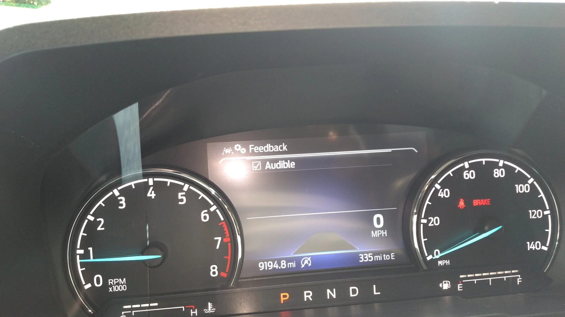

So there is a setting for Feedback for horn response (not the mislock option).
I think the double-honk warning will happen anyway in what you showed.
But some of the others may be different.
Just for completeness - what is your setting on?
Ford Maverick Horn blows KIMG3258
Which is what I expected. I did not try the same scenarios with it off since it's hotter than Hades today 😂

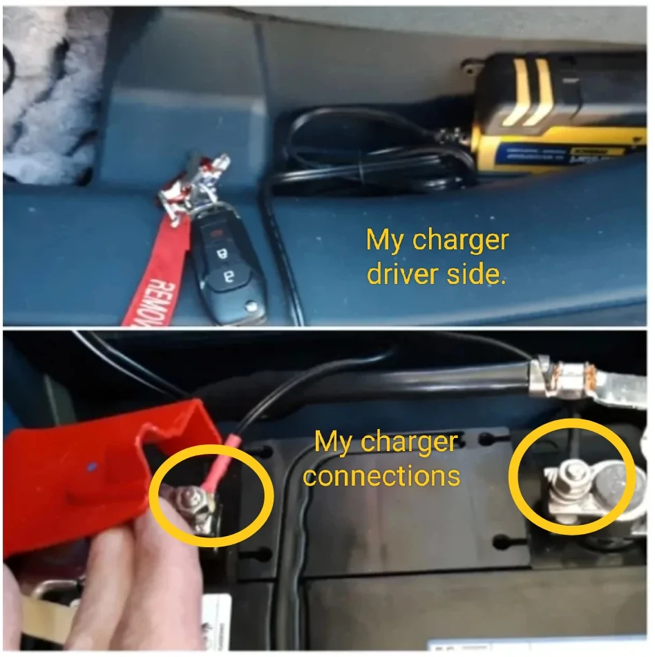

The shift knob will stay in park position until the fob(s) that were not in truck when truck was locked OR the keypad IS is used to unlock it. I usually only lock my truck running when it's in my driveway or garage and want to charge my 12v for an hour or two without bothering to put noco onto jump pins.
G5 mainly, I do have a g10 but use it on 80-200 ah batteries. Both will follow same routines after batteries get above 5amp float rate.
Since it's small. Have you ever thought about leaving it in the truck and permanently hook it up to the battery under the back seat?
It makes it very convenient although I've only had plug my charger in twice in 2 years.
No one has been able to demonstrate anything detrimental about it and they'd be loath to admit that it could be a better option.
And I still have the original flooded battery that the Maverick came with.
It would sure beat running the vehicle in the garage for an hour

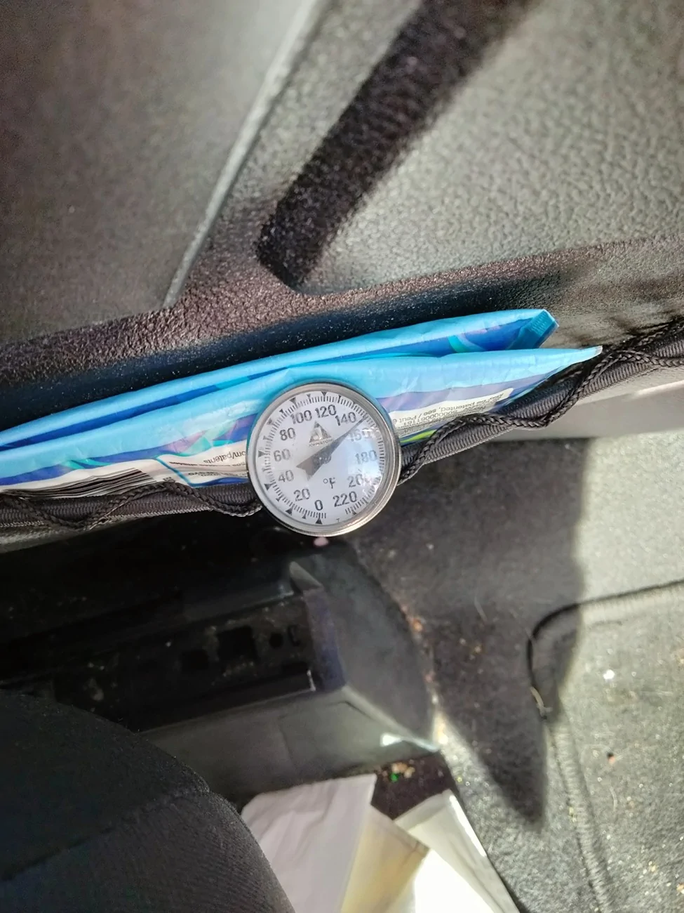

Inside my wife's Escape today 150°
It was only 102° today in the shade 3' off the ground,
If I installed it under the back seat I would not be able to observe the lights on it or take the voltage readings without unlocking the truck and opening the back door which will activate things that will reduce the battery voltage reading by 0.1+0.3 volts. I connect it to the jump posts with the hood up allowing me to get the reading. If the noco is still plugged in the door opening will cause a reduction in the battery reading which will start the noco charge routine. With the hood up the noco ground clip can be removed leaving the jump pins to reveal the 12v battery without active draw reducing the actual reading. You can then take jump pin multiple reading of the 12 volt over several days without disturbing the soc of the battery. If you have meter capable of accuracy in hundredths of a volt you can track battery soc over a week or more if you leave noco unattached. Also rumor has it that mice are less prone to chew wires if hood is up.
