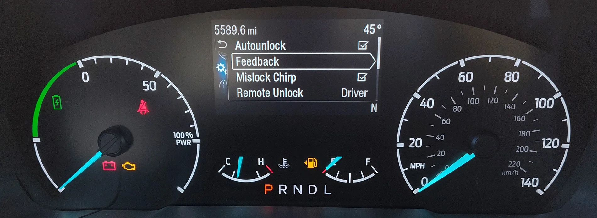

@mavstrangva
I knew Glenn was going to ask you to show your work, not just the answers.
So there is a setting for Feedback for horn response (not the mislock option).
I think the double-honk warning will happen anyway in what you showed.
But some of the others may be different.
Just for completeness - what is your setting on?
