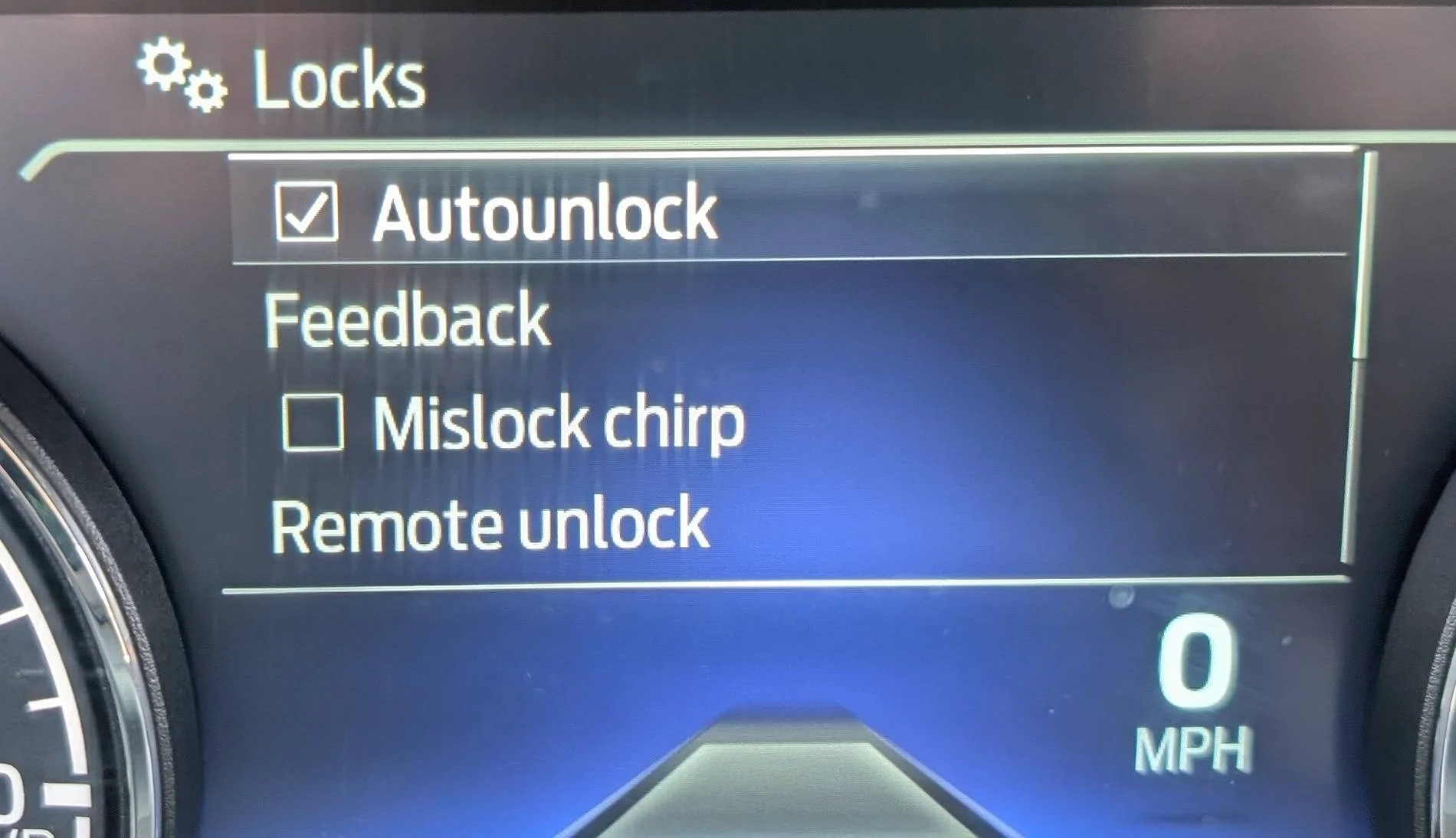

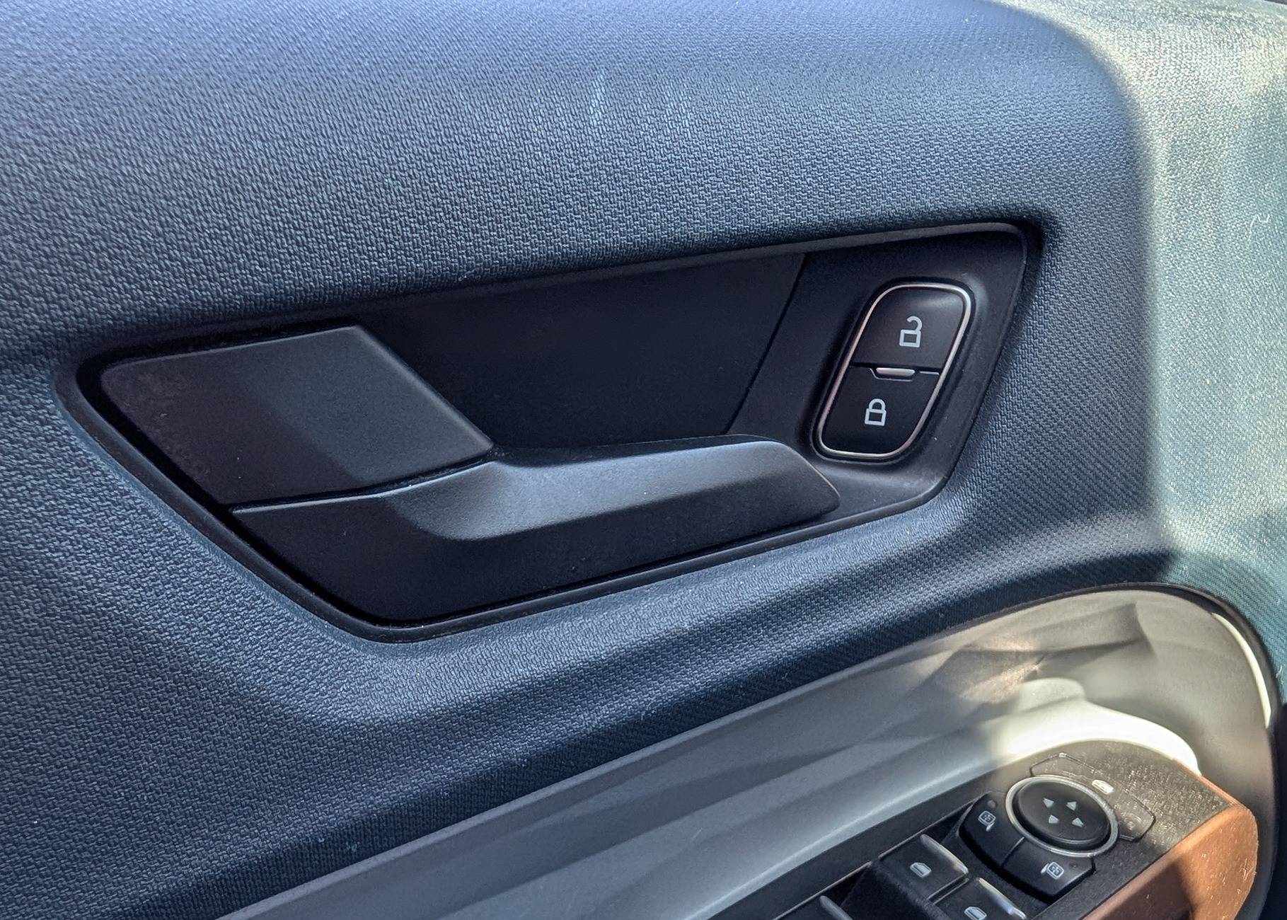

I had the same problem. Couldn't figure out why, until someone on this forum mentioned:
Disable "mislock chirp". It is in the vehicle settings menu on the gauge cluster. (Menu->Vehicle->Locks)
So:
It appears the problem is that, usually when in a hurry, when putting your hand behind the inside door handle you end up accidentally tapping the lock button (which is right behind the handle = not great design), all while opening the door. The truck sees this as a "mislock" and honks twice to warn you.
When you disable that setting, this seemingly random honk upon exit goes away, so ultimately it wasn't random after all!
Cheers!

@Area51BS
So:
Cheers!
Probably this. Thanks.

@Area51BS
So:
Cheers!

Mislock is when a door, hood, or tailgate really isn't closed, and you go for a lock.
That's the chirp on fob lock.
That Feedback option is the one when you double-press fob lock, and also gives a honk.
So if the Mislock option solved it - the system must be seeing a lock request while it sees a door open.
Either of those things could be faulty then.
