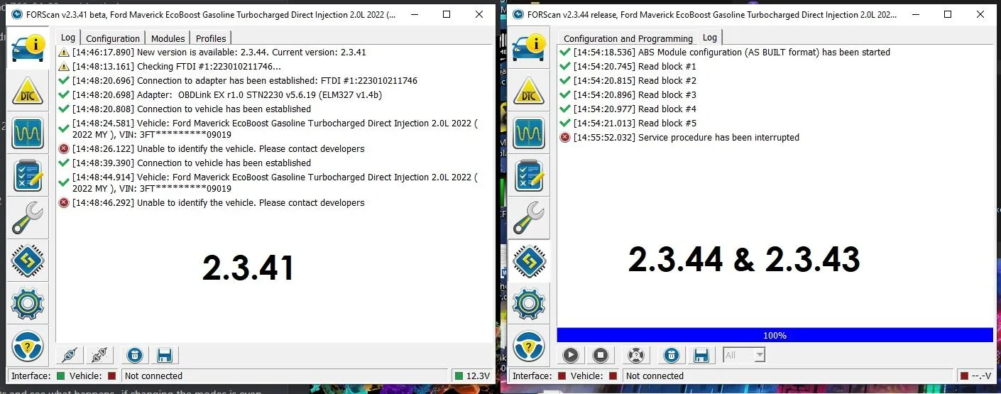

Someone on the Forscan forum suggested using v2.3.41, but on that version it says it can't recognize the vehicle. So, this is where we are at:
Ford Maverick Has anyone used ForScan yet? forscan

It would be great if one other person could attempt to replicate the problem I'm having...then we would know if it's a Forscan issue or a my computer issue.
